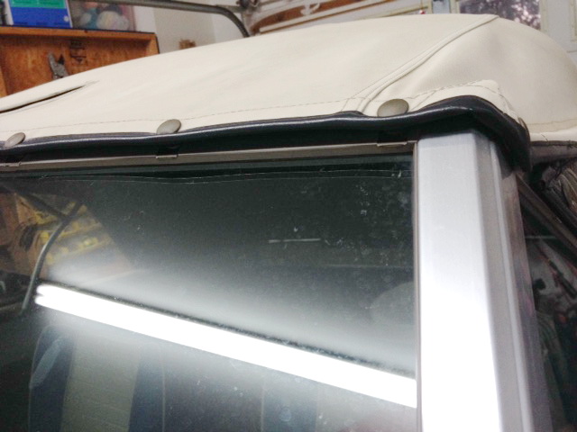

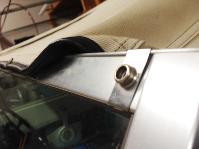

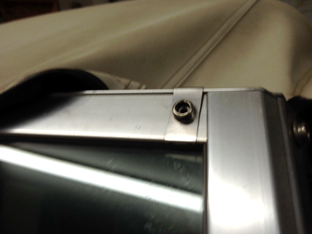

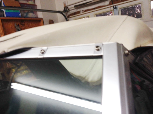

Kipper:
There are clips that have a snap on them - they clip onto the stainless window frame. My 1973 has them. Not sure if they are still available. They hook under the lower edge and tap over the top edge with a gentle tap of a small hammer.
Here is another angle
Here is with top snapped to it -

What you might find on the windshield instead of snaps is a groove along the top edge, and
the canopy front edge has a thin piece of plastic sewn in along the width of the edge underside.
The groove opening faces down so the front edge of the canopy runs over the windshield top and the front edge of the canopy curlers around so the plastic edge can be pushed up into the groove.
It makes for a very clean connection that is 100% drip and wind proof. Both my 64 Edinboro and 65 Erie have this set up. One has the bubble windshield the other flat glass panels aluminum frame set up.
Do this front connection first, you can do it from inside the boat, the back side panels snap onto the boat with a little stretching of the canopy.
