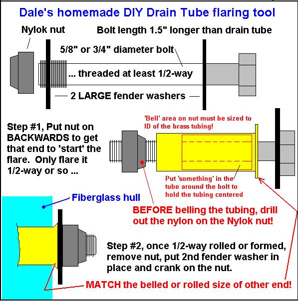

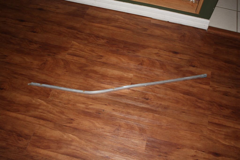

I must have accidentally inluded the toprail of the flying bridge side window with another boat I sold, 'cause it's missing! I also need to borrow a drain tube flaring tool. I could ALSO use MANY pictures of the fastening joints bewteen the cabin and the deck. My old memory ain't what it used to be, so I've forgotten most of what I saw when I disassembled the Seafair. I KNOW I SHOULD have taken pictures, but I NEVER would have figured I would take THIS long doing the job!

Not sure if this will help but here is one option.

yEP, i SAW THAT. tHAT'S MY BACKUP PLAN IF i DON'T SCORE A FLARING TOOL!

Did you find a flaring tool yet Gary? (I'm thinking about making one, you'd be welcome to borrow it if you need to.)
