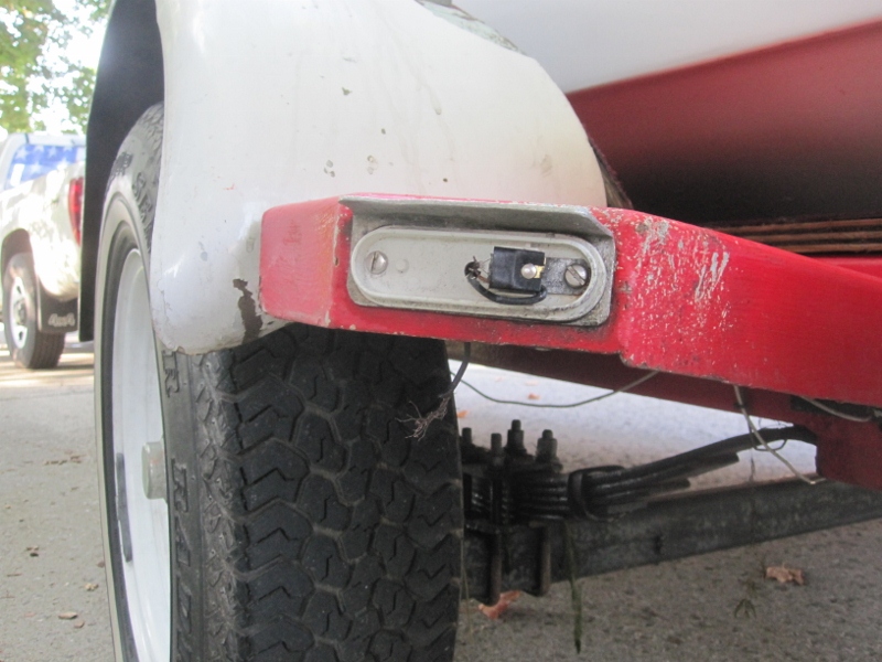

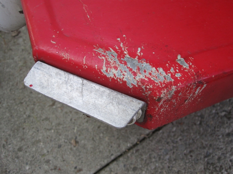

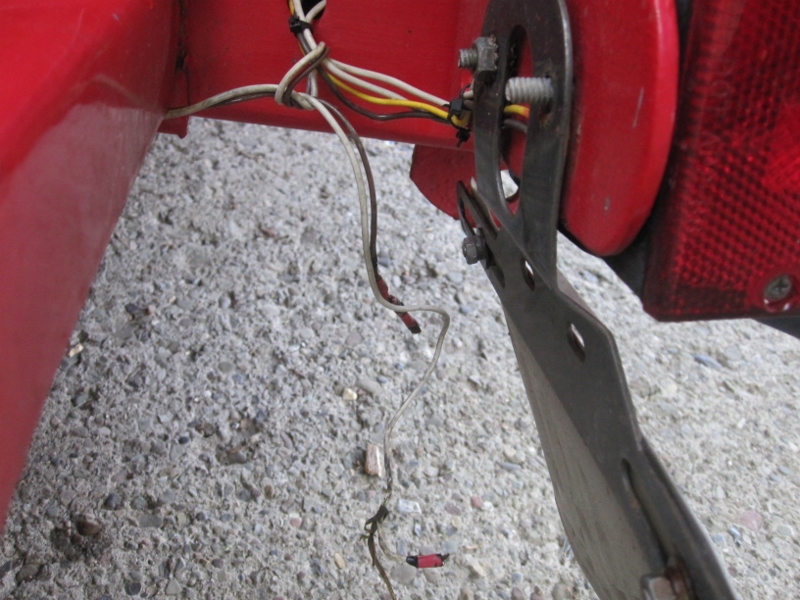

Going about 70 on the way out to western NY. Took out the rear fender market light, lens and wiring, front fender marking light lens, damaged the fender in a # of ways. I always travel with a portable floor jack and 4 way wrench, so getting the spare on was easy, except on my back.

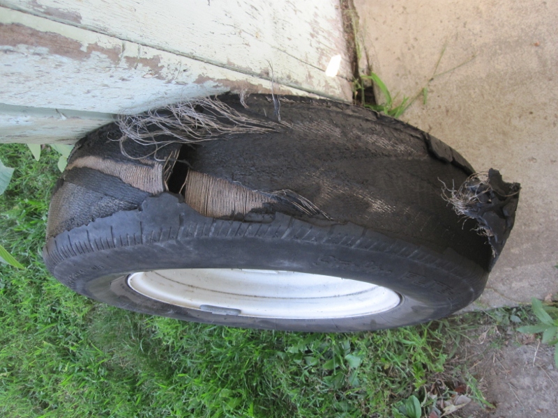

From the picture of the tire and from someone who has changed ALOT of tires Looks like Frank was a Victom of Crap on the road .It chucked the tread off of it thing is if the preasure was Way low and the tire got Hot from running low . Im sure Frank knows to Check tire preasure and he said he did .Sometimes Crap just happens to good people ..By the looks of it the rim must be atleast a 12 inch .No reason you cant run Normal speeds on that . Alot of Cars run on 12s.If it was a 4.80 / 8 Ya slow down some because they be spinning at 70 mph .

Yeah, no major damage. Minor stuff I'll fix when I get home. Screwed the wheel up too, so that will have to get replaced. Couldn't find radial trailer tire/wheel combos around, so will order a new pair from etrailer when I get home later today. I'm not excited about running tires that don't match, but I just need to get home. If another one blows, I bought a bias belted spare at Tractor supply yesterday. If I get home okay, I'll take that tire back and get my money back. I like running radials on trailers that go a distance. I may go up to 15" too, not sure right now. That would mean 3 new tires.
All the years I've been towing boats, I have never had a tire go, or really any problem with a trailer. There's always a first time I guess. Also, there's no question we hit something that blew this tire. It wasn't even close to worn out, and was not waetherchecked or anything like that. It was a good tire!

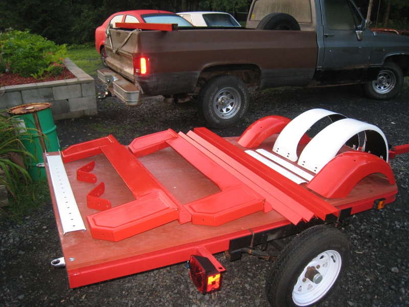

My trailer is much heavier duty than most. It has a 3500# axle with 5 lug hubs that can take any 4 1/2 by 5 wheel. It's had 14's on it since I got it, but the fenders are adjustable, as you can see in the pic below. Right now the fenders are mounted on the top holes. When I get my new 15" tires, they will probably have to move to the bottom holes. So it's easy for me to change tire size. Not so easy for most guys with vintage trailers. One of the reasons I went with such a heavy duty set-up for such a light little boat was specifically to travel interstates at speed.
