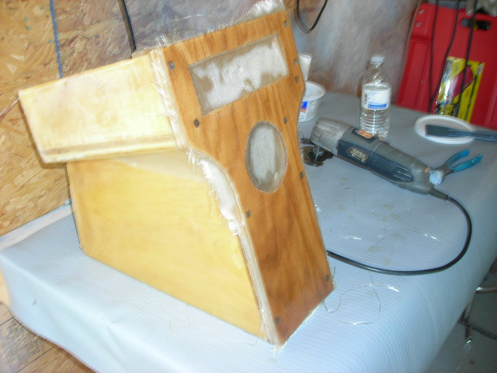

Good job Ron. Are you going to seal (resin, paint, ?) it before you cover it? Plywood doesn't live very long in the marine environment unsealed. Just a thought...... ;)
Re:MerControl installed....... 15 years 2 weeks ago #41611

Just a suggestion. What if a guy was to get a piece of white 1/2 inch UHMW and cut it the same. Use a 1/8 round over bit on the edges.
Totally weatherproof and the white would match the interior.

mark, didn't even think about sealing/painting it, but now i will.

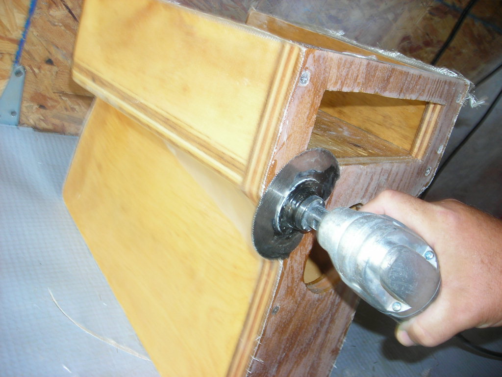

neil, i bought a piece of white star board at west marine,(12"x27"x1/2"...$38.00. when i got home i realized i had 5/8ths exterior plyscore leftover from the garage build. so i used that. the horizontal piece is doubled as just 5/8ths wasn't thick enough for the idle lever to clear the gunnel. you can see the metal spacers i used below the ignition switch (a real rube goldberg idea) as i didn't want to triple the plywood. also the back had to be extended more than the front as the gunnel is curved and not plum to the original mount. so i had 2 dimensions to deal with. i would of really liked to make it so it looked proffesional but didn't know how. i'll probably end up having it re-made by someone who knows what there doin but for now its solid and its comfortable. ron

sorry ron,i hadnt seen this thread untill now,i will send you the vinyl i used for the console,but its very thin,the plywood will have to be filled and sanded compleatly smooth and either painted or glassed,other wise it wont stick and you will see the grain of the plywood through it,beleive me i have several coats of resin on your console ,and sanded between them all.
if you want make a drawing with the dimentions of the plwood and ill make one for you,and i will round off the corners to make it not so sharp.
im proud of ya,you did a good job hooking it up,john

john, the first pic is 5/8ths plyscore. then i had to build it out more so the idle control lever cleared the gunnel. i added another piece of 5/8ths to the horizontal and still didn't have the clearance, so i added another piece of 1/4" which gave me a total of 1 1/2" on the horizontal. i then mounted the mercontrol and the idle lever was still hitting the gunnel at the rear. i took 3 metal spacers that gave me another 1/4" and forced them in at the rear of the mercontrol and ran the mounting bolt thru them. now i have the clearance by a hair. i don't know how to give you dimensions because nothing is the same. all i can figure is that the vertical is 4"x17", the horizontal is 4"x11 and the thickness varies from 1 1/2" at the front to 1 3/4" at the rear (by the ignition switch.) what i can do is when the season is over i'll take it off and send to you. ron
