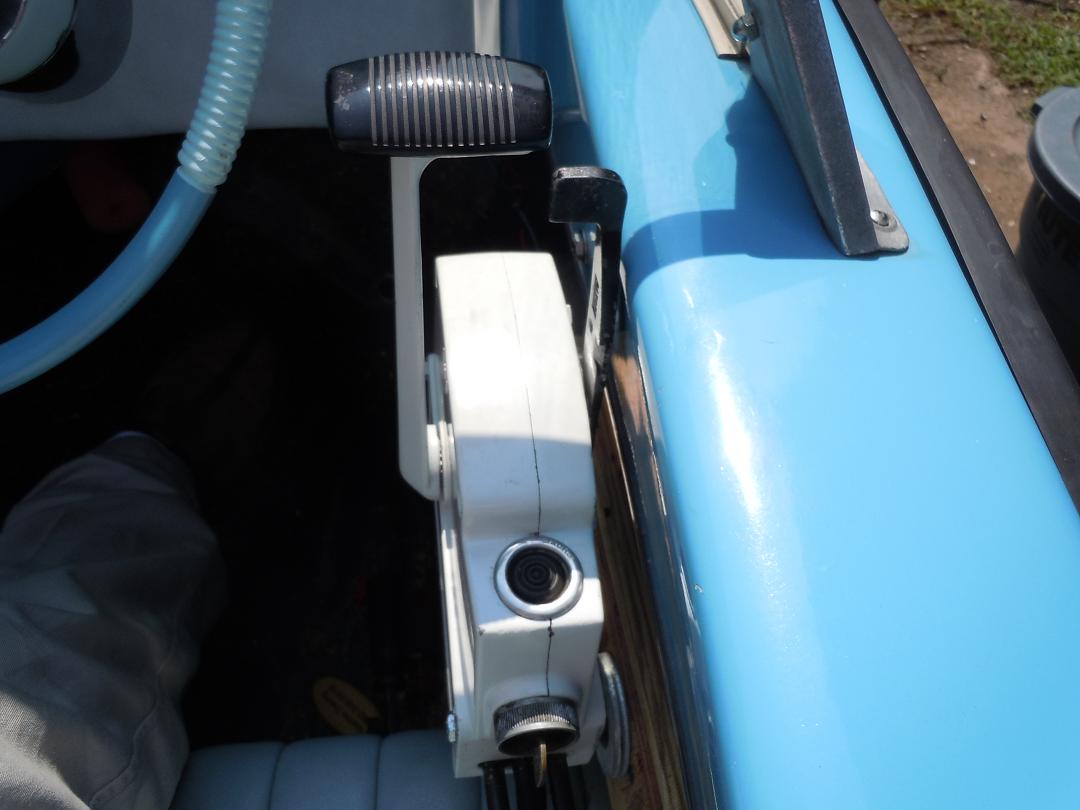

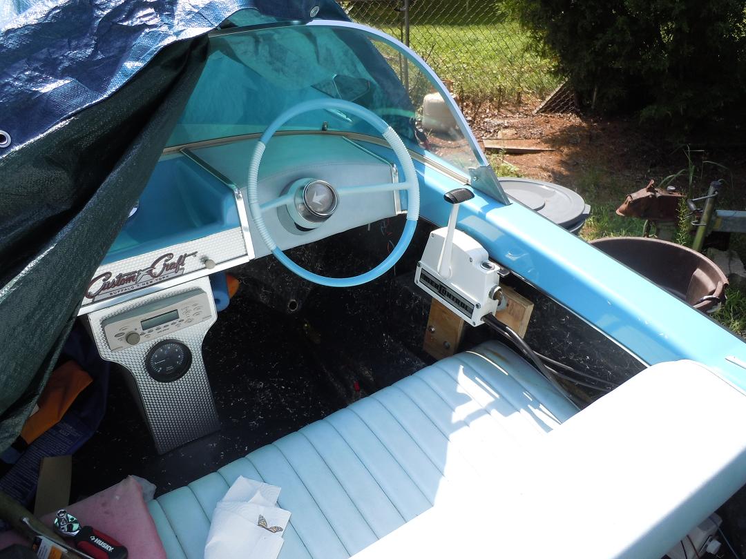

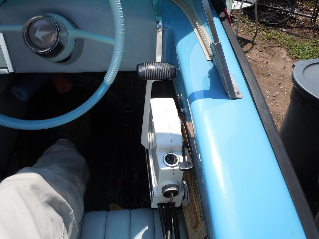

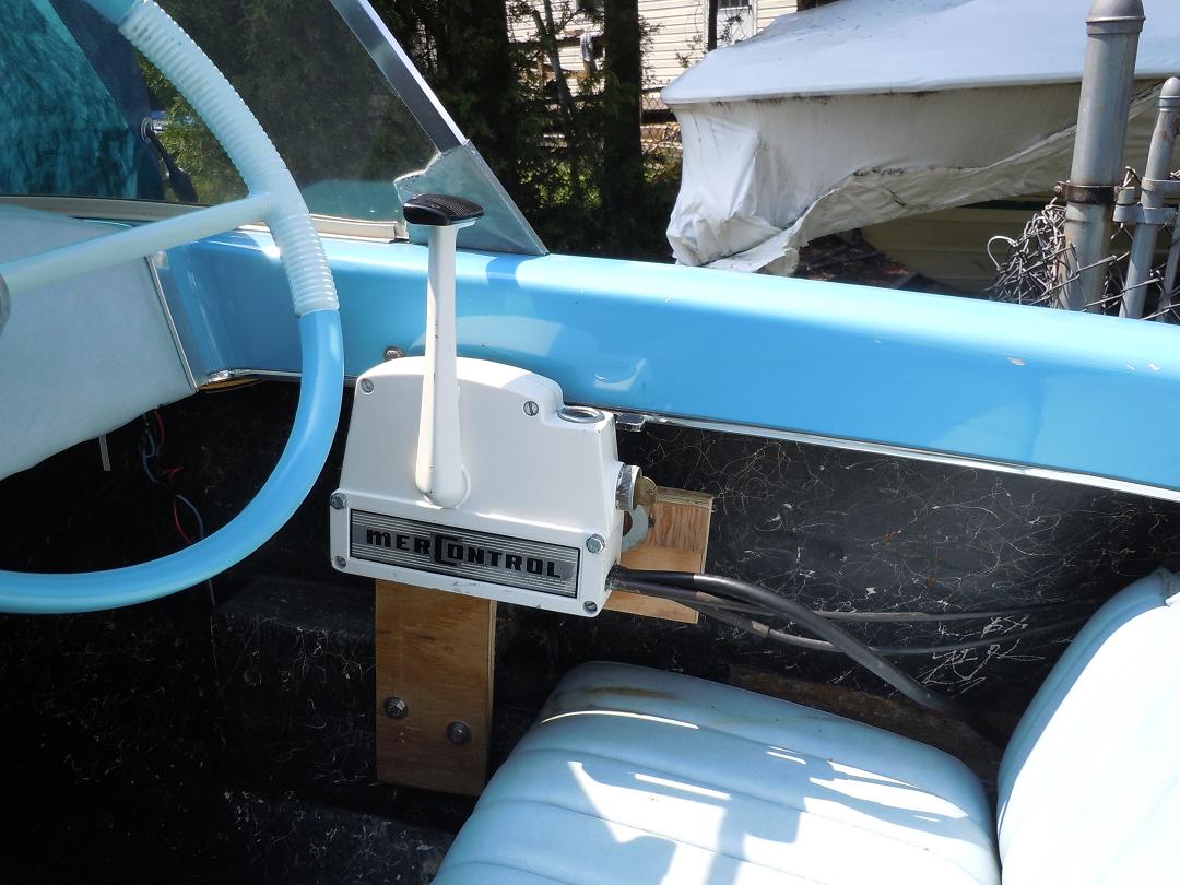

with some inspiration from Frank, i finally installed the mount and remote that JG so graciously refinished and gave to me. it took a while as the original mount and gunnel were not plum. had to do a lot of shimming to get the throttle idle lever to clear the gunnel, but its solid and adjustable in any direction up to 2". going to try and cover it with the same stuff john did the console with. should be a lot easier to use now that i don't have to be constantly leaning forward. had an estimate to make it out of 5/16ths aluminum for $125. glad i didn't as i would of had to add over 1" of shim's behind it. wont look very professional at shows anymore but i don't care, iv'e received enough awards and rather be comfortable driving it. ron

thanks guys... i guess for someone who has never even done minor fabrication, i surprised myself. again thanks to JG for the gift and to Frank A. for the encouragement.

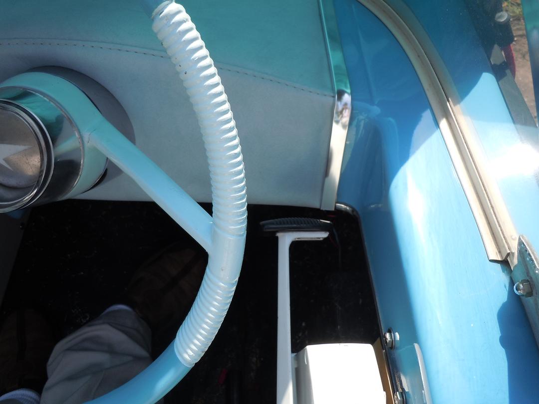

Looking good! Will be doing something similar this off season.Just wondering if you have knuckle clearance by dashboard? Hard to tell from the angle of picture.Mine is now mounted on the inside of the gunnel on the glass,just above where your plywood ends.What I like is it acts as a arm rest and give me better control of the throttle when airing it out.What I do not like is the fact that it's visible from most angles and cuts up the lines.Not sure how far I can drop it and yet keep the attributes I mentioned.
cool runnings Mr 88
Re:MerControl installed....... 15 years 2 weeks ago #41559
  • vuyosevich
  • Posts: 2910
  • Karma: 76
john, my whole fist clears the dash and i mounted it below the gunnel so it doesn't stick out. its so comfortable now as i can rest my arm on the gunnel and have full control. ron

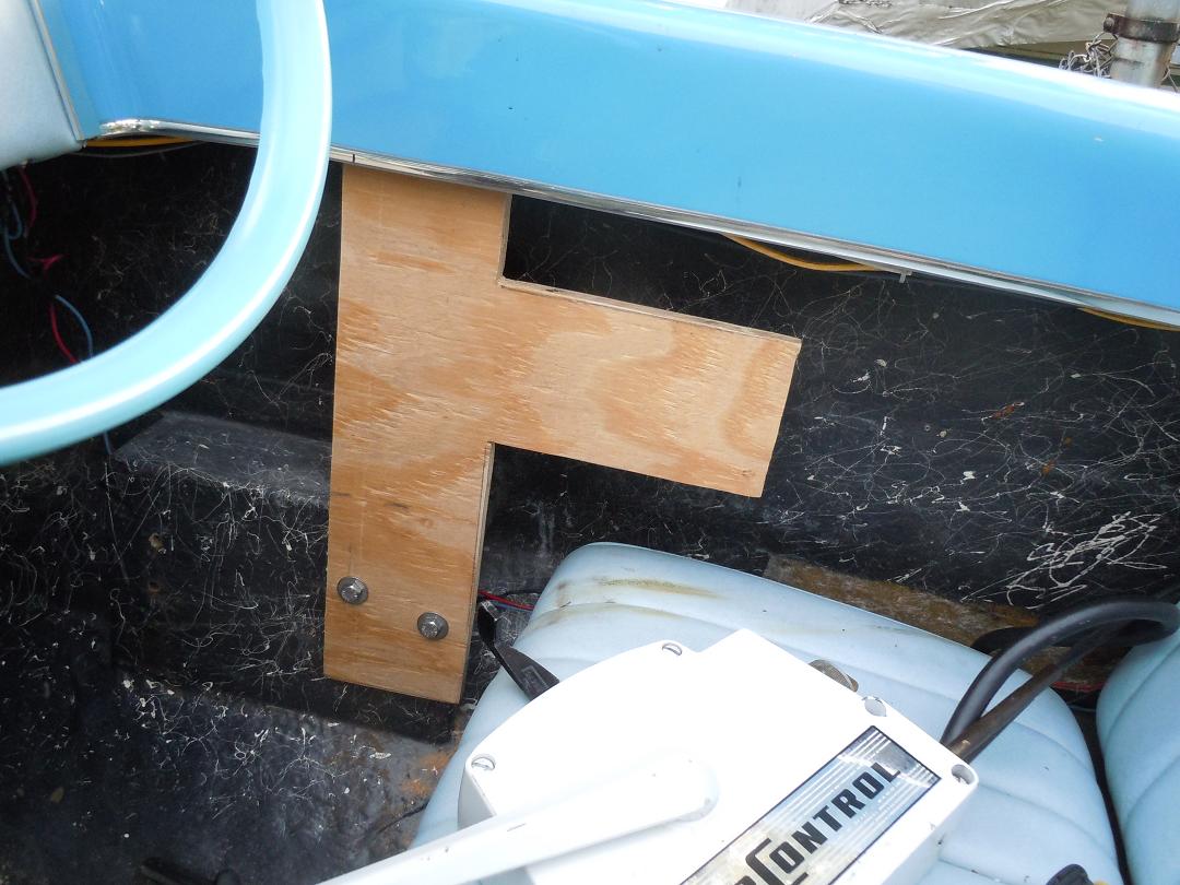

Good job Ron. Are you going to seal (resin, paint, ?) it before you cover it? Plywood doesn't live very long in the marine environment unsealed. Just a thought...... ;)

Just a suggestion. What if a guy was to get a piece of white 1/2 inch UHMW and cut it the same. Use a 1/8 round over bit on the edges.
Totally weatherproof and the white would match the interior.

mark, didn't even think about sealing/painting it, but now i will.
neil, i bought a piece of white star board at west marine,(12"x27"x1/2"...$38.00. when i got home i realized i had 5/8ths exterior plyscore leftover from the garage build. so i used that. the horizontal piece is doubled as just 5/8ths wasn't thick enough for the idle lever to clear the gunnel. you can see the metal spacers i used below the ignition switch (a real rube goldberg idea) as i didn't want to triple the plywood. also the back had to be extended more than the front as the gunnel is curved and not plum to the original mount. so i had 2 dimensions to deal with. i would of really liked to make it so it looked proffesional but didn't know how. i'll probably end up having it re-made by someone who knows what there doin but for now its solid and its comfortable. ron

sorry ron,i hadnt seen this thread untill now,i will send you the vinyl i used for the console,but its very thin,the plywood will have to be filled and sanded compleatly smooth and either painted or glassed,other wise it wont stick and you will see the grain of the plywood through it,beleive me i have several coats of resin on your console ,and sanded between them all.
if you want make a drawing with the dimentions of the plwood and ill make one for you,and i will round off the corners to make it not so sharp.
im proud of ya,you did a good job hooking it up,john

john, the first pic is 5/8ths plyscore. then i had to build it out more so the idle control lever cleared the gunnel. i added another piece of 5/8ths to the horizontal and still didn't have the clearance, so i added another piece of 1/4" which gave me a total of 1 1/2" on the horizontal. i then mounted the mercontrol and the idle lever was still hitting the gunnel at the rear. i took 3 metal spacers that gave me another 1/4" and forced them in at the rear of the mercontrol and ran the mounting bolt thru them. now i have the clearance by a hair. i don't know how to give you dimensions because nothing is the same. all i can figure is that the vertical is 4"x17", the horizontal is 4"x11 and the thickness varies from 1 1/2" at the front to 1 3/4" at the rear (by the ignition switch.) what i can do is when the season is over i'll take it off and send to you. ron
