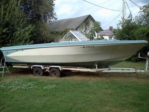

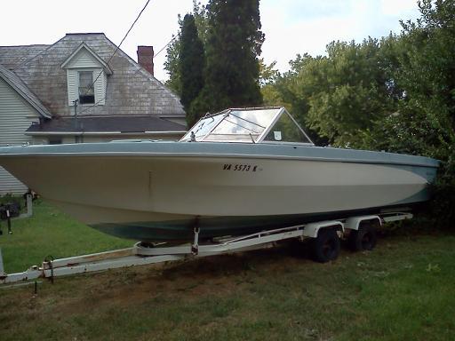

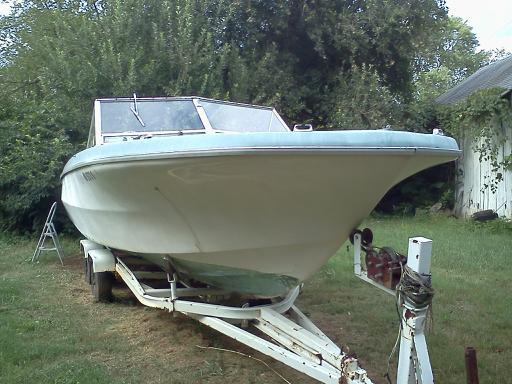

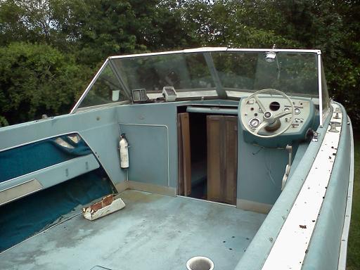

Went to check out this vintage Glastron today. I knew I shouldn't have done it as soon as I pulled in the driveway. I am a sucker for these big ol' skiff style boats(tanks) of the late 60's. She's a 1967 Caribbean V-234. I've never seen another one like it. I've always loved classic Glastrons, and this one's big and in-your-face. I'ts been sitting for several years and the original 6 cylinder is locked up. Missing only a few parts here and there, but mostly complete. Decks are super solid. Interior of cuddy is really nice. Owner says $600 and won't budge off that price. Good paperwork comes with.
Should I, or shouldn't I?

Way cool boat.
The parts availability for the OMC may be a little tough, but certainly not out of the question.
You can haul alot of people/beer/camping stuff in that thing.
And you are right, a big 24' Glastron is in your face.
Get it before she goes completely to waste.

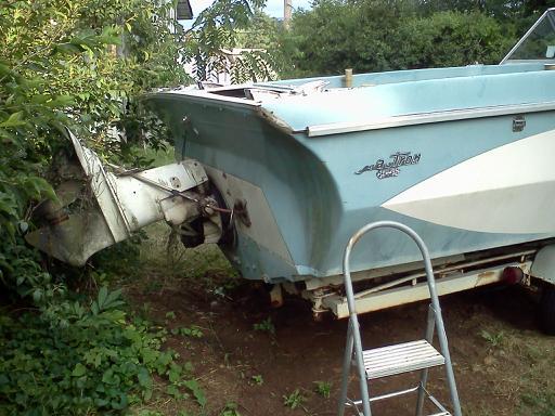

Depends if your a glutton for punishment. The outdrive is the first thing that scares me.Not sure how easy it is to find parts.Engine seized?, maybe and that's a big maybe you soak it with marvel mystery oil and it frees up.Then you have to see if the block is cracked from not being winterized as well as being laid up improperly.Compression test may lead to some bad valves ,pistons,rings and or head gasket Then you have to get into the hull, stringers,wiring, etc.After that it's your option, if you think it will make you a happy man then buy it.Keep the economy running and if worst comes to worst you may sell the trailer for a few hundred and cut your possible money loss.It's your call my man.

Call me crazy but a 6 cyl in that big boat Uh Uh yank that puppy out and find a later (1980ish) 350 V8 with an 800 series drive. Still uses the big round cut out in the transom and would properly push that big unit around. A complete boat with the proper power can be bought for cheap and let the parts swapping begin!

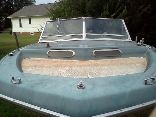

Has it been covered or left in the open all these years? I see holes in the floor where the captains chair was.Where do those holes lead to and how many more are drilled and not filled?Are you in a freezing climate?Is the transom solid or has water infiltrated that? Not trying to be overly negative just giving you some food for thought.

It is a cool boat, and reminds me of my old '66 Cobia G24 Offshore, but without the rotten stringers and decks. The floor seemed to be in really good shape, the owners reportedly had taken out the deck area interior about 3 years ago. I checked the transom and it seemed to be really solid.
The thing that I like the most about this boat also bothers me the most, and that is it's just huge - it would be a big project. but when finished....man it would make a statement. Imagine how awesome it would be floating at the dock or rumbling down the lake, and how many heads would be turning....

IF it was a mercruiser I/O I would say YES.......BUT......it isnt
Re:BIG '67 Glastron Caribbean, rare? 14 years 5 months ago #41092
It certainly has NOT been taken care of, all the interior is missing.
As for the OMC drive, unlike everyone else here I am a fan. BUT, be sure the steering system is not seized. They are hard to find. As for replacing it with a later 800 drive, that is probably a high profile drive & the 800s were low profile, so the hole will be too high. Another thing to consider is the engine mounting. Lots of the early OMCs used a transom mount (the "stringer" nickname isn't 100% accurate) for the rear engine mount. IF this one does, then the transom wood needs to be solid. If it is a true stringer mount, the wood strickly reinforces the steering cable pivot & tow eye areas.
AS for the transom, the only wood is most likely in the flat area, so it should be replaceable w/o removing the deck for access.
Don't expect a rocket with the V6.

Redo the transom without a hole in it .Throw a Jack Plate with a 6 inch set back Then hang a Big Old 1500 Merc off of the back or a 2.5 ..You would have more interior room to .

I had a couple of those OMCs, very strong runners when working right and the outdrive lift can get you in about 6" of water. Some air leaks in the water pump area were a problem but can be fixed, keep the oil changed in the power lift so the plates dont lock up on you, the small motor is hard to find. The V6 is a GMC Buick, very reliable with more power that you could imagine. Parts for both the outdrive and motor are around you just have to look. I think I have a brand new fuel pump for that motor sitting on a shelf in my basement. If it has power steering that's a bear to adjust. If it has the push/pull steering connected to the outdrive they don't come any simplier(?)
