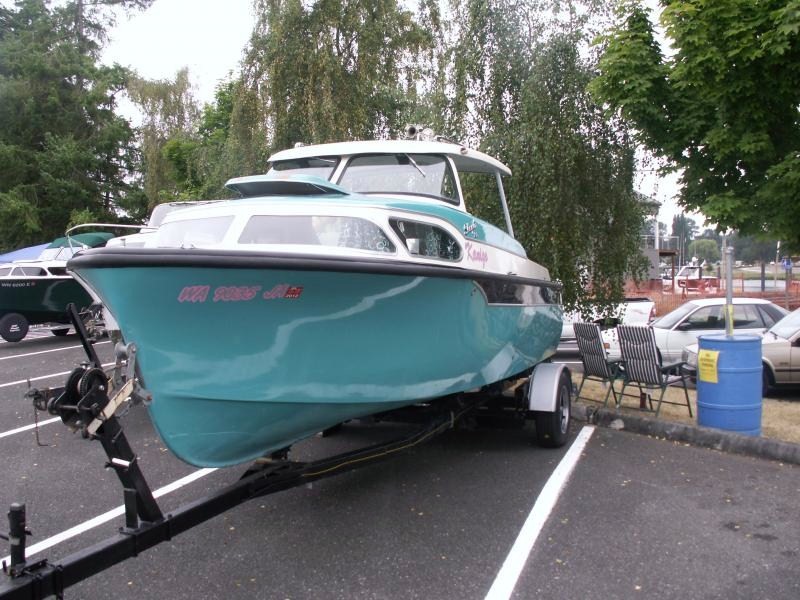

Lets see if this works.This photo was taken this past weekend at the LaConner Classic Yacht and Car show. I don't have a before shot on this computer.
