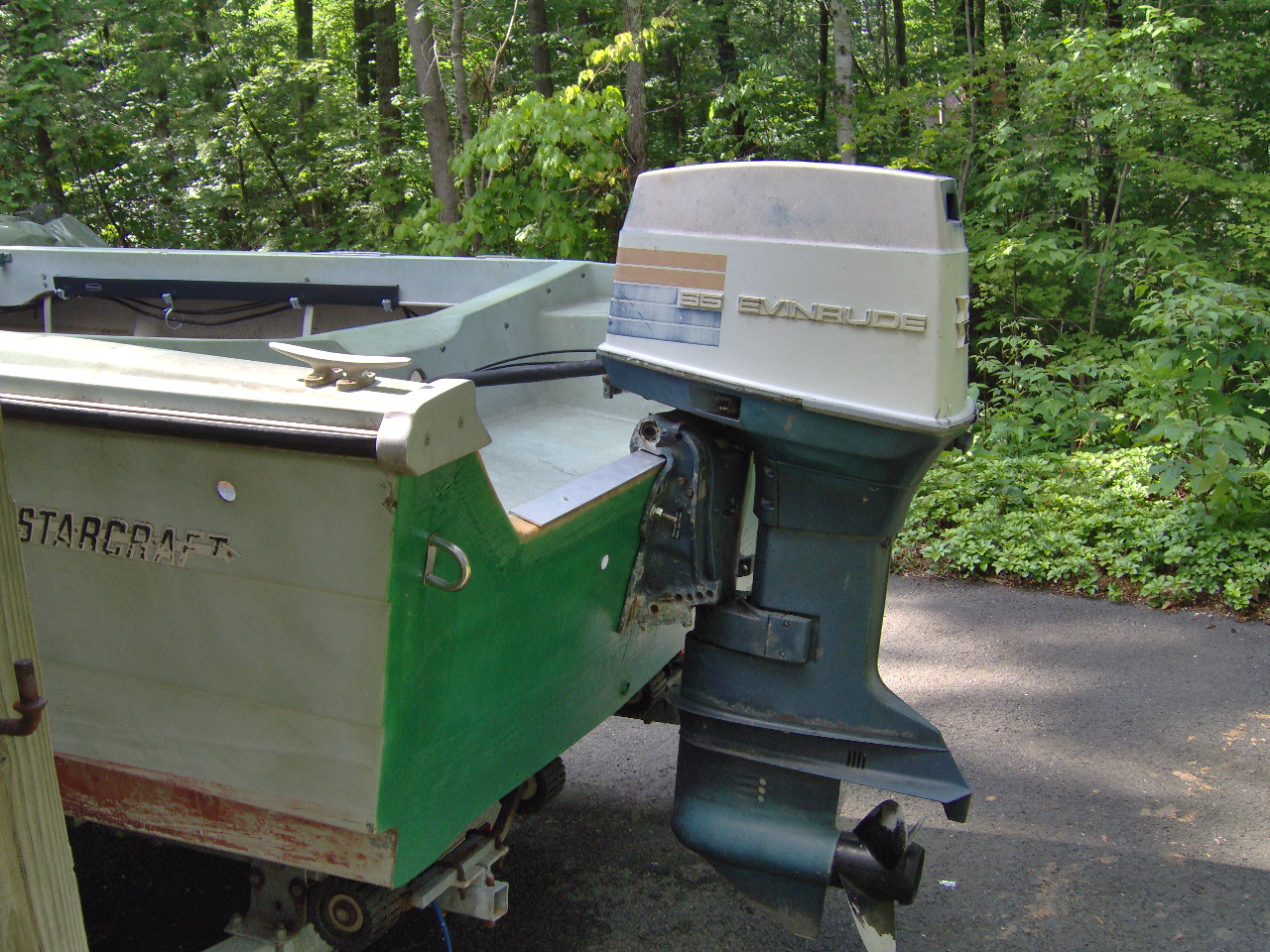

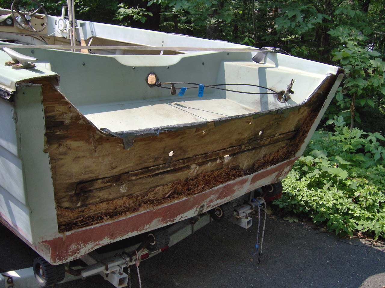

Re:Transom Repair Question 15 years 3 weeks ago #40925
Consider Seacast.
If it is a really rotten transom getting the wood out is easier.
Yes pics would help. Don't do it this way. Because it ends up like this.
Re:Transom Repair Question 15 years 3 weeks ago #40965
  • havock
  • havock's Avatar Topic Author
  • Posts: 28
  • Karma: 1
Well that doesn't look so bad, nice coat of paint and no one would know. I'd never know, looks like good work to me.
Looks like I won't get pics until Tuesday evening but I will get them for sure.
I considered seacast, I think I figured I'd need about 8 pails of the stuff (going on memory estimates for boat size) I cannot imagine seacast is cheap, I don't want to cheap out but I do need to be as frugal as possible and since my labour is free.... of course if it's just a little bit more then it is certainly an option. Do you know what the price is like for seacast?
Re:Transom Repair Question 15 years 3 weeks ago #40988
www.transomrepair.net/index.php?cPath=1&osCsid=b33667d9d119167dc5c2a3d27279c702
That transom of mine took 7 gallons.
I spent about $500.
1.5" thick.
That paint on the transom is plastic lawn chair paint.
So far so good.
