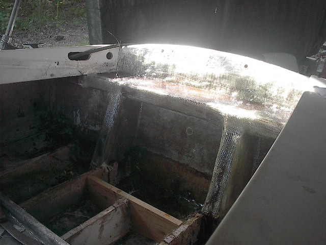

Here is a "beefed up" transom. Note the knee braces are thru the floor and attached to a stringer.
Jim Savage
