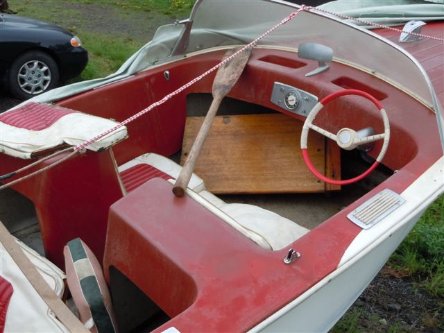

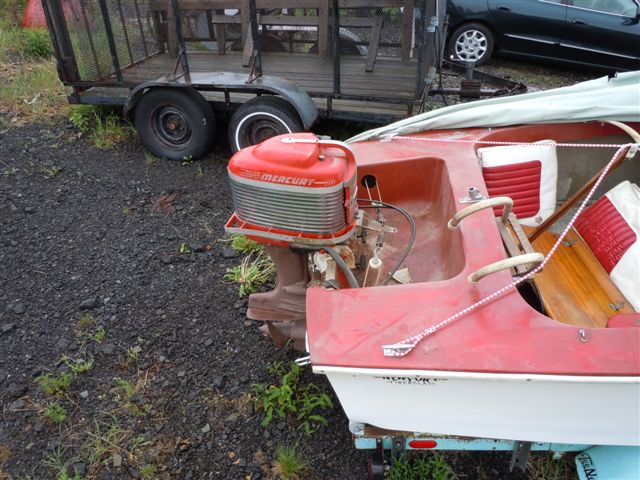

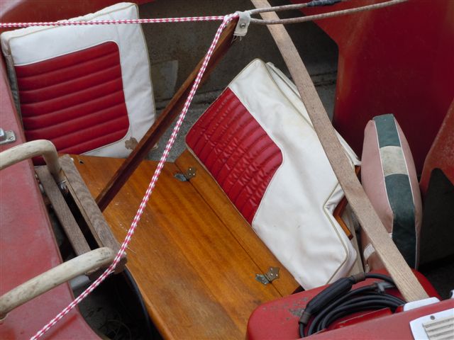

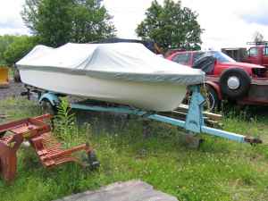

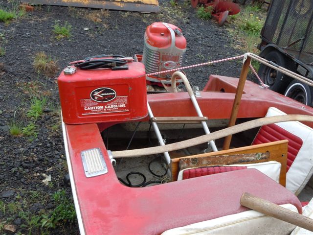

First boat project- where to start? 15 years 3 weeks ago #40573

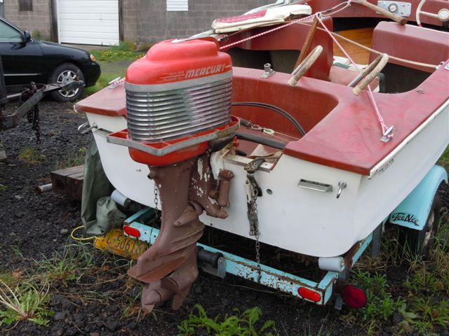

1959 Newport with mercury engine and tee nee trailer
Hi everyone this is my first project and I'm starting a list of the things that need to get done and in what order. Some basic questions I need help with:
1) a friend is going to scrape the rust off the trailer and repaint her , put new tires and bearings,etc.
Where can I get tee nee decals ?
What's the best place to order tires? Also need a spare
2) I want to work on the boat while he works on the trailer. What's the best way to position the oat in my garage for that? Where can I buy the right stands?
3) I need to have the engine checked out and restored if possible. Anyone know of someone reputable in NJ?
4) this does not have a full transom, how should u check it for damage?
Any advice is greatly appreciated!
Jim

Looks like a great find Jim, congrats! (And welcome) In the upper right hand corner of the screen is a "Search Forum" box. You can enter any subject you like and see all the posts that pertain to your question(s). Let me tackle a few of them;
1) trailer tires (&wheel assy.'s) - Wally World, Northern Tool, Menards, etc. can be great sources for those. Just get the best you can afford, they've jumped in price lately like everything else.
2) search "boat cradle", several folks here have built excellent models from scratch recently. If you build one on wheels, it makes life much easier!
3) Couple good places up in NY, not sure about Jersey. Might want to post that question in the "Regional Forums" below (FGNE)
4) search "transom" - basically you lift up and/or stand on the cav. plate to see if there is any flex at all. Take some drilled wood samples to check for wet or black wood.
Good luck with your project, keep us posted on your progress.

Nice looking setup.
Motor matches the boat perfectly.
1) www.easternmarine.com/shop/
I have found some hard to find rims here.
2) You will want to build stands or a cradle. Search as Mark suggested.
3) If you want it done right, do the engine yourself. Buy tools and a factory manual if available.
4) Again as Mark suggested. There are not a lot of holes it it so maybe you got lucky. For what it is worth, I used Seacast on my transom although a very different boat. It looks like you may end up pulling the deck from the hull.

Ok bad news! She definately has water in the transom. In my excitement/ stupidity of finding her in a farm and my first boat purchase I neglected to shift her up and down on the trailer. I did that today and clearly plenty of water in her. So now I have to remove the top section, cut into the fiberglass floor, remove the water , put new stringers and put it all back. I don't have the skill to do that so I will have to pay someone else. So the question is should I move forward or quit while I am ahead and sell her for parts?
Re:First boat project- where to start? 15 years 3 weeks ago #40656
Ok, don't discourage.
It isn't rocket science replacing floors and transoms. It is dirty grunt work and some common sense. Mechanical know how and a little carpentry are good too. Get the book "Runabout Restoration".
I think it is too nice a boat to not do it. It may take a couple of years, but it can be fun doing it. A partner in crime helps too.
Re:First boat project- where to start? 15 years 3 weeks ago #40658

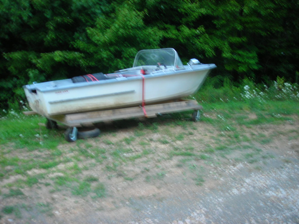

Re:First boat project- where to start? 15 years 3 weeks ago #40875

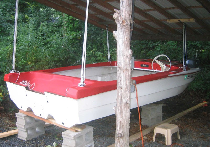

hi all - thanks to jim s another member who had a newport that unfortunately did not survive i have another option. he cut his newport up to dispose of - from the pic below she does not have any foam or balsa. since my boat has not been in the water for years. she has been sitting in a field covered only by the original canvas. the water inside her then must be accumulated rain water.
if i drill a hole in he transom she should drain out. im going to take the engine off and inspect closely.
Re:First boat project- where to start? 15 years 3 weeks ago #40876
john great pics of the boat rack. this will help very much! and ill get working on her right away
jim

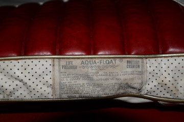

the original aqua float cushions are in good shape. is there a way of replacing the interior and restoring them? or is it more cost effective to replace them?
anyone restore theirs?
I would save the cushions for "showtime" as they are period correct.I would think the material may be to brittle to re-sew.That picture shows them to be in great condition. Buy some uscg approved ones for everyday cruising.

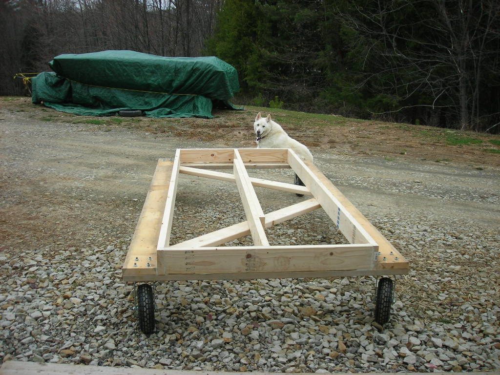

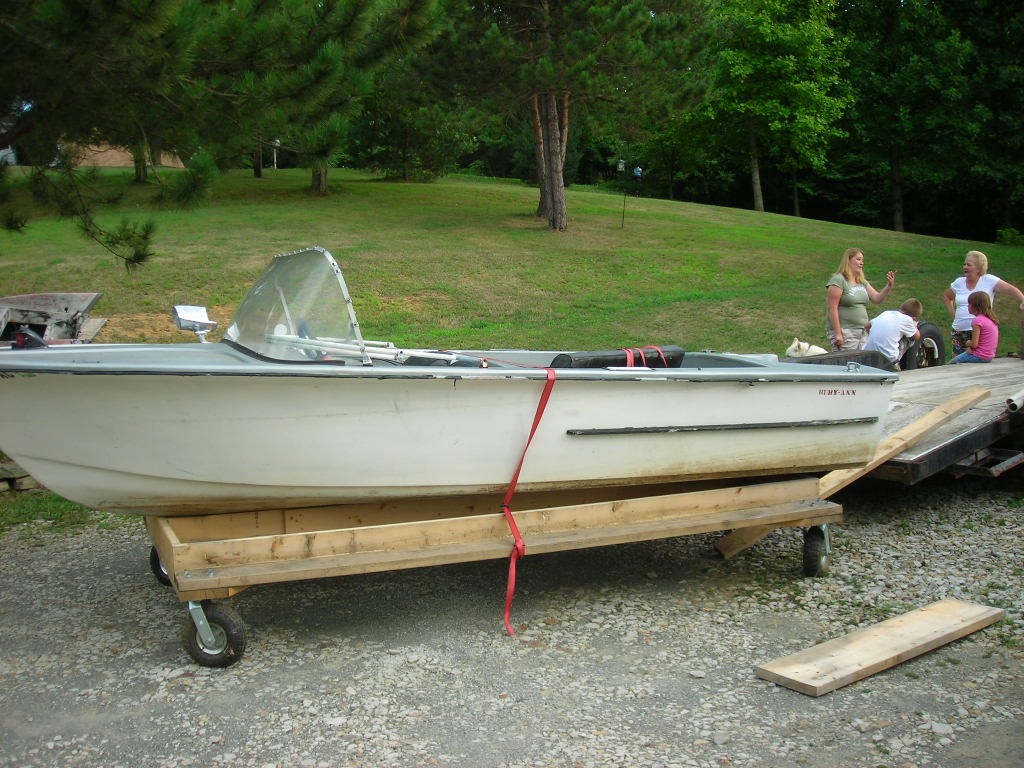

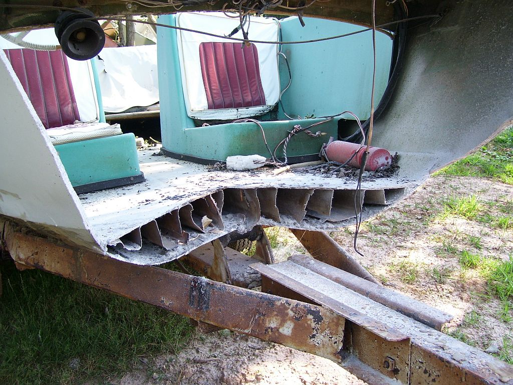

I'm in my first boat project. I started in the floor first as this was the only thing I had planned to do. But while doing this it didn't take long before I decided to start replacing restoring everything! I hoped to run my boat this summer but now it probably won't see water till next summer. I made my own boat stand out of 4x4 and 2x4. Makes it so much easier to work on the whole bottom and trailer.
Re:First boat project- where to start? 15 years 3 weeks ago #40981
Pretty cool getting a "cut-away" view of the hull construction Jim. I agree with JT (Mr.88), I think those cushions are neat, but "show only". ;)
Welcome aboard Tempest. Nice stand, you should start a thread with your project and keep us posted on your progress.

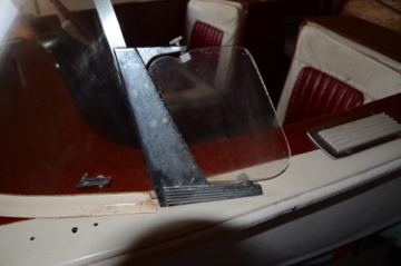

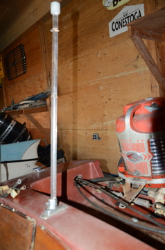

Re:First boat project- where to start? 15 years 3 weeks ago #41094
Some other cool finds
I need another one of these splash guards- anyone seen one around?
Is this clear plastic pole suppposed to light up?
