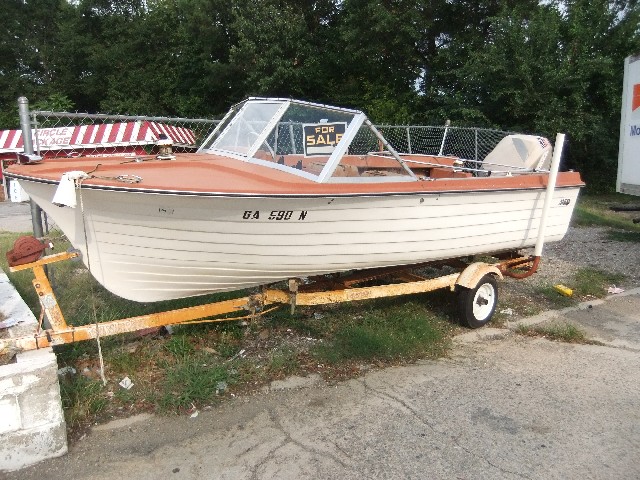

Got this boat & trailer combo on August 5th, I believe it to be a '67 MFG Edinboro, I'm not entirely sure on the year so please correct me if I'm wrong. It has what I believe to also be a '67 Evinrude 80HP outboard. Bought it non-running with the trailer for $350. Worked about 16 hours on it during the weekend with my friend and we finally got it to fire off after we troubleshot for just about everything, it was a bad condenser. After that she fired up and idled fine. Replaced the lower gear oil with the recommended "Type C" lubricant for the electric select-a-shift models. New shear pin for the prop and some other odds and ends you do to prep and old motor to run again. Ran it in a 100 gallon tub to check water pump etc & after that we launched it in our pond and puttered around a bit. It was a pretty great experience for me & a great learning one as well as both my friend and I are 17. Got a video and some photos below hopefully! If anyone has any knowledge of this boat/motor PLEASE let me know! Thanks!

Welcome aboard, and "good on ya'" little buddy, nice work so far. Like Larry (bobo), I'm impressed! Sounds like she's running pretty smooth. Even though the water pump appears to be working well, consider installing a new impeller very soon unless it's been recently replaced. Age takes it's toll on the rubber, and if the blades (vanes) crack and break off they can become lodged in the passages and cause severe damage. The fact that you bothered to find out, source, and use the proper gear lube tells me your head is in the right place.
Looks like GA registration on the boat, where are you guys located?
