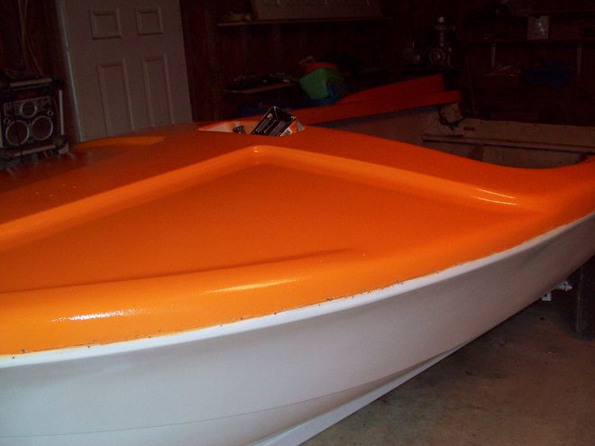

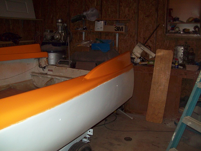

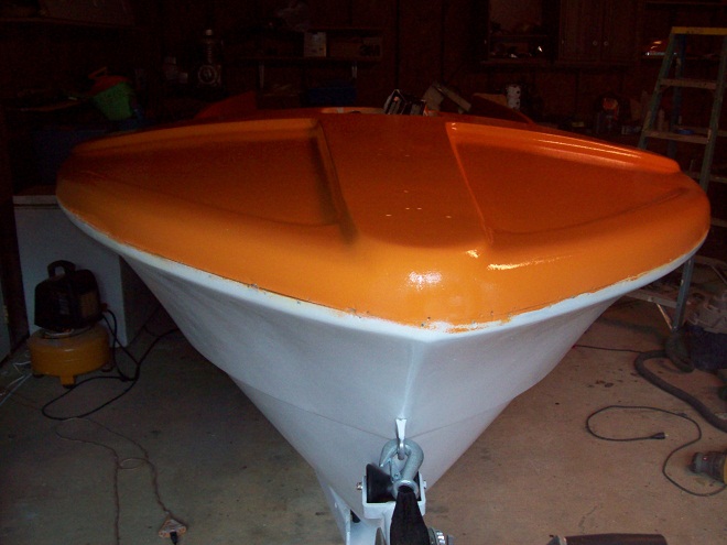

Just went out and checked my Invader to see how the paint looks and much to my suprise, it looks great!!!! I lost count of how many and what types of paint I've tried but it's shiny now. Imron 2.1HG rolled on. How long should I wait between coats for this and should I wet sand or just scotch brite?? Pic coming soon. Pain in the butt to load pics from this notebook.
Re:Finally!!!! 15 years 1 month ago #39330
I don't know much, but googled it and got this: pc.dupont.com/dpc/en/US/html/visitor/common/pdfs/b/product/dic/DIC/Imron2-1HG.pdf . In part, it says "If accelerators have been used, recoating must be done within 48 hours. If more time has elapsed, scuff sand to ensure adhesion."
I can't find anything about wet sanding it. Don't know, but sure would like to! Got a DuPont paint seller in town? Call and ask them!
What color and got pics?
Frank
