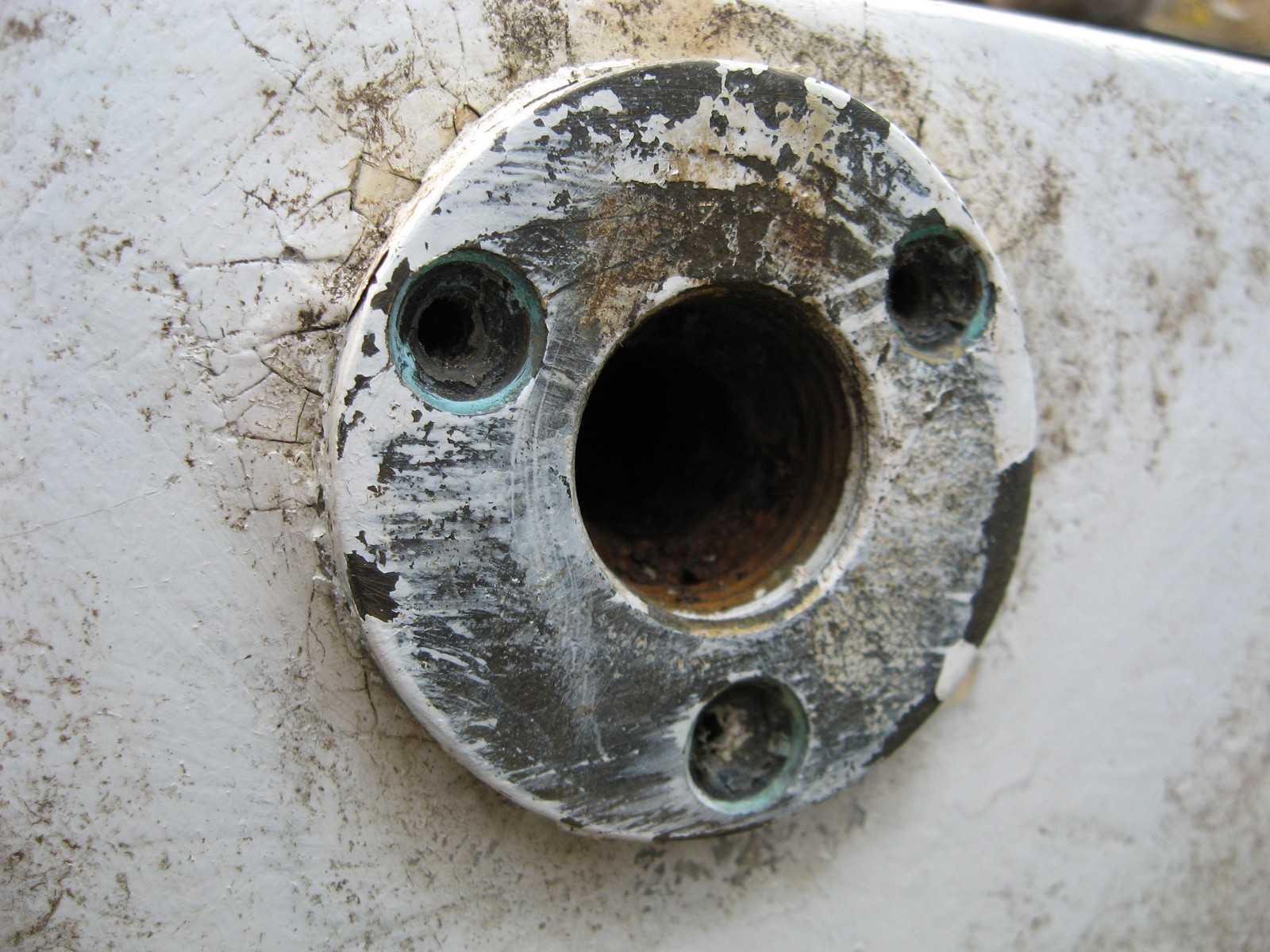

Anybody know how this one comes out. It does not seem to like prying. I was going to put a new one of larger diameter in there. This one is small. Maybe I should just live with it. The transom is solid and the brass wood screws came right out. This is a 59 Winner.
Re:This style drain plug removal 15 years 1 month ago #39241
If it was put in with a product like 3M's 5200, you will have to literally destroy it to get it out Robert. I always hesitate before I use that stuff, but one of the places I do use it is on drain tubes.

It looks to have paint between the flange and transom so I would 1st take a sharpened putty knife and drive it between the flange and transom. Then I'd do a couple of heating and cooling cycles, reinstall,tighten the pipe plug to spin it loose again using the putty knife to put pressure behind the flange.
Another method I used recently when I replaced 2 identical drain plugs on our Skagit 20 was the use of a small slide hammer that I used to remove pilot bearings from auto flywheel/crankshaft when doing clutch R&R. Good luck.

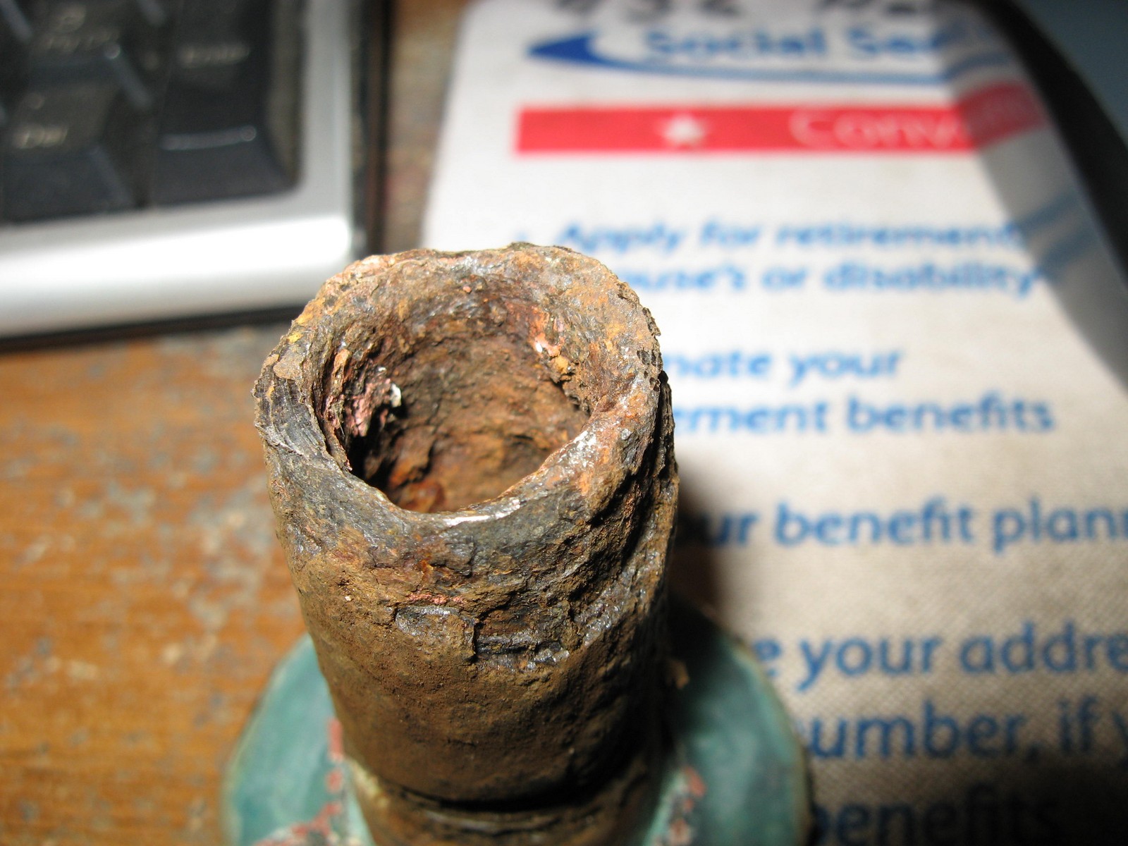

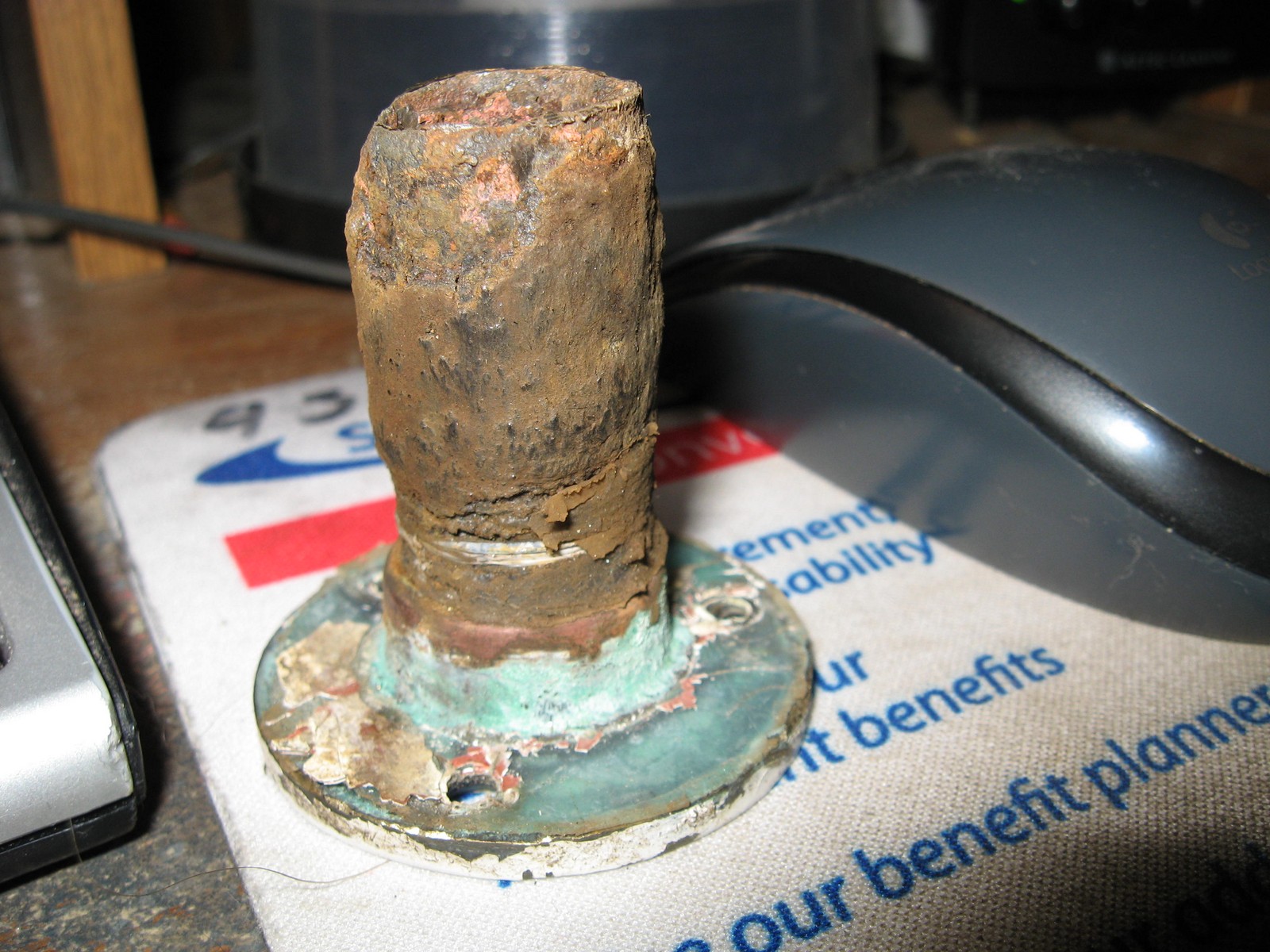

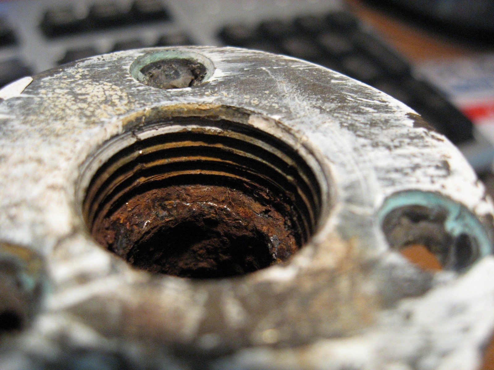

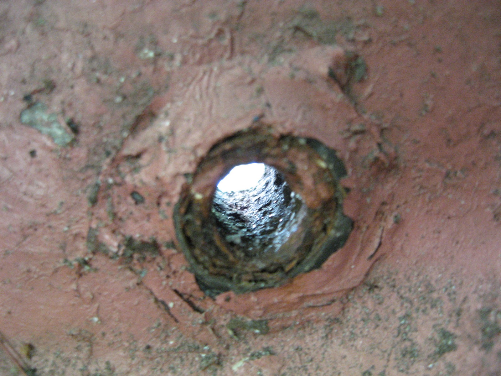

It's out. I don't think it is supposed to be a drain plug. It is a brass fitting with threads. It looks like either black iron or galvanized 1/2 inch pipe nipple cut off just to fit inside the transom. Wood is still solid thank God. It just had a small bead of silicon around the inside. The rest was held in with rust. Thanks all. I drove it out with a deepwell socket.

Other than the addition of some pipe to lengthen it looks like your standard garboard drain plug piece. Glad you were able to remove it without damage to transom.

I can beat that. The pipe came out of the brass.
Re:This style drain plug removal 15 years 1 month ago #39297
So this is a piece for a hull drain. Is it supposed to have a 1/2 inch pipe through the transom? It seems smallish to me. I'll replace the nipple I took out with a brass one if that's all it takes. It would flow twice as much without the thickness of the pipe. I just never seen this fitting before.
