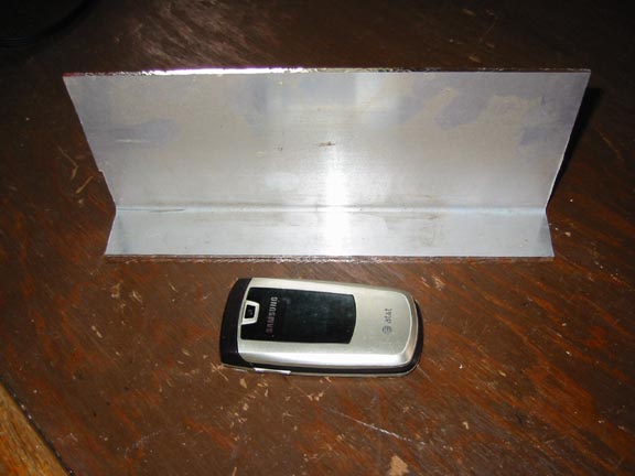

50hp motor on hydros dont turn they plow forward, you will need a "Large" center skag turn fin, or no steering at speed & that feels pretty sketchy...see pic for LARGE fin blank $20 at Sorenson woodcraft, cut to shape corners

Re:Hydroplane Do,s and Donts . 15 years 1 month ago #39299
Its got a fin on the Left fork for turning
that fin is for go fast turn left racing, you will need a center fin
or see if you can relocate that side turn fin to the transom, so you can turn both ways
you are better off with a center turn fin as shown,large is good
