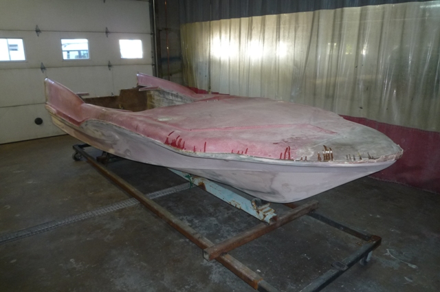

Aft hull fairing completed B)

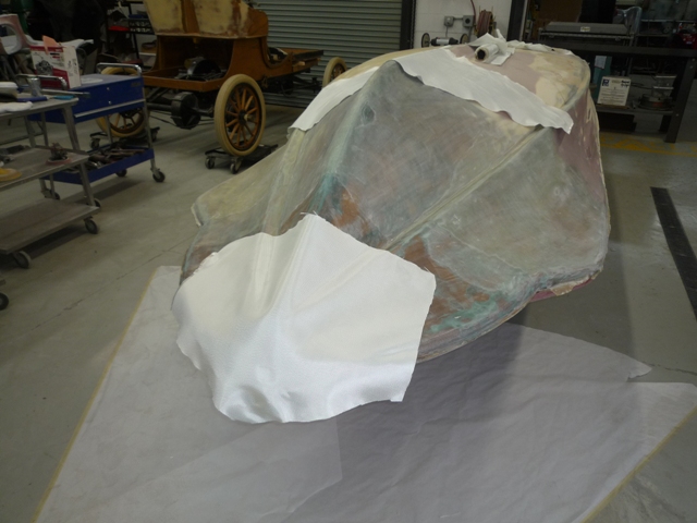

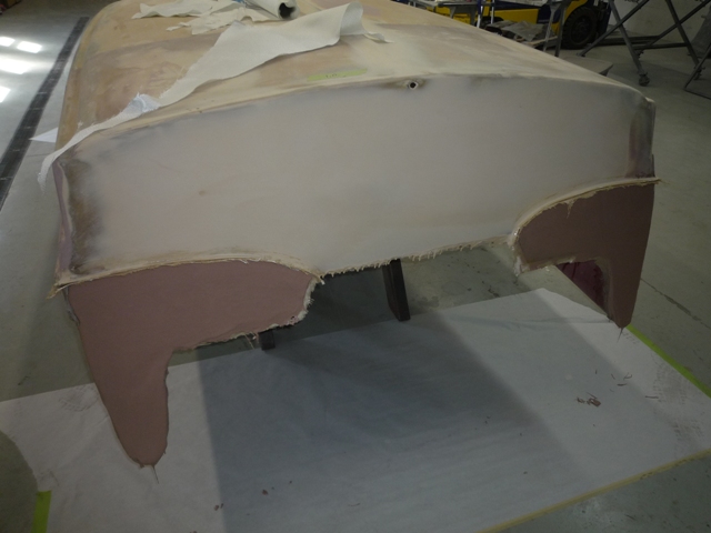

I formed a 'buck' for the hull nose repair and glassed it with killer cloth but was not happy wiht the result so I ground off the glass....

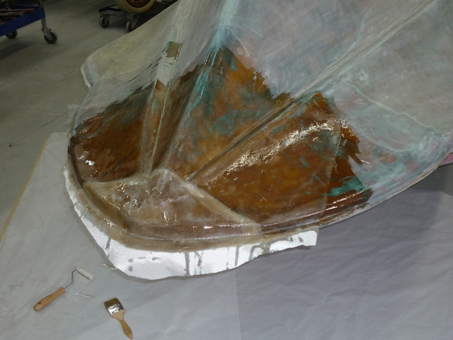

Lets try it again with 9oz cloth :silly:

This looks better! :cheer:

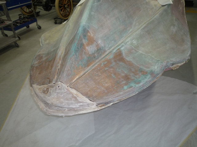

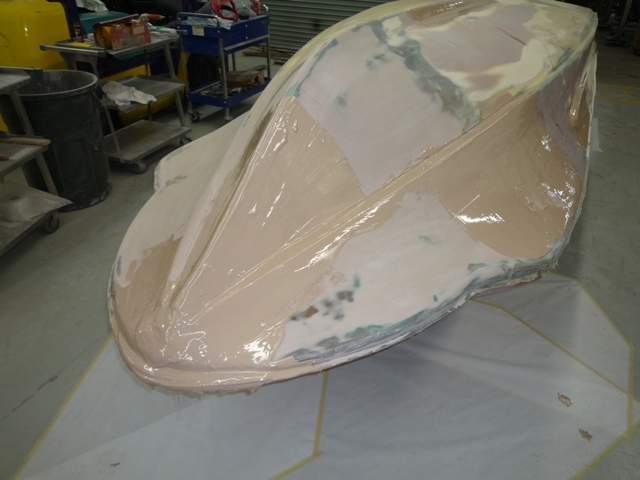

Better still and ready for fairing, after some sanding :)

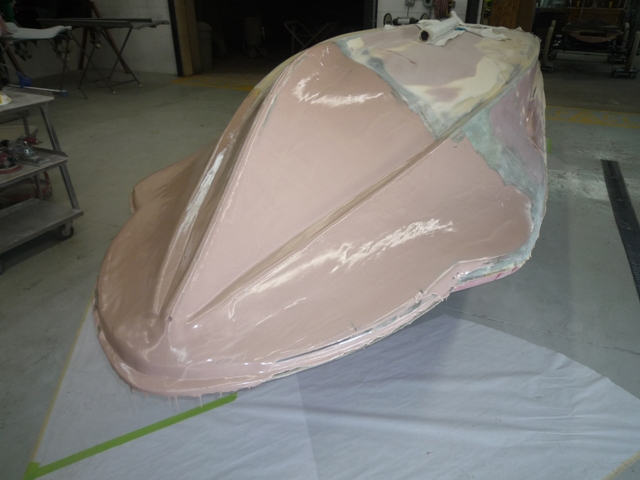

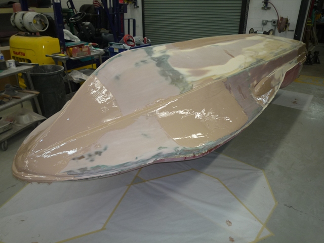

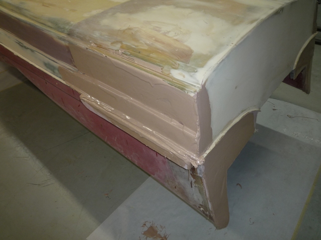

407/410 Fairing mixture applied, cured and ready for sanding.
Remember to visit West System to learn about thier expoxy fairing additives
(filler) and resins (the 105 system in 'products') westsystem.com/ss/

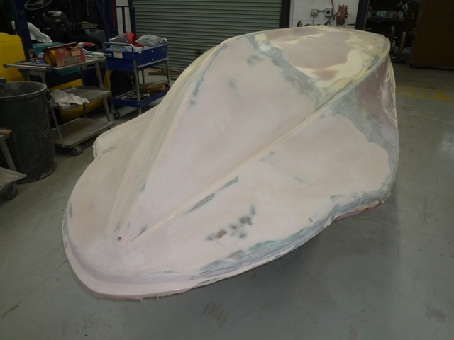

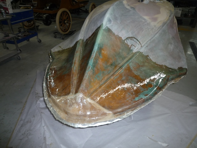

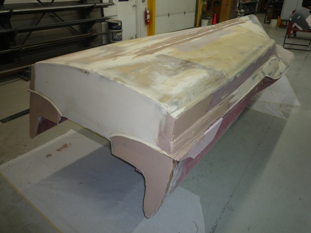

West System 407/410 fairing 'filler' and 105 resin mixture applied to upper transom and rear of fins ;)

Happy, Happy, Happy :laugh: almost ready to turn topside! Oops, photo out of order......

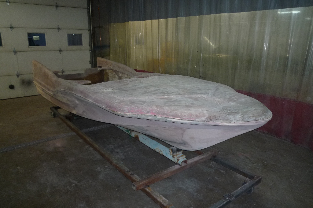

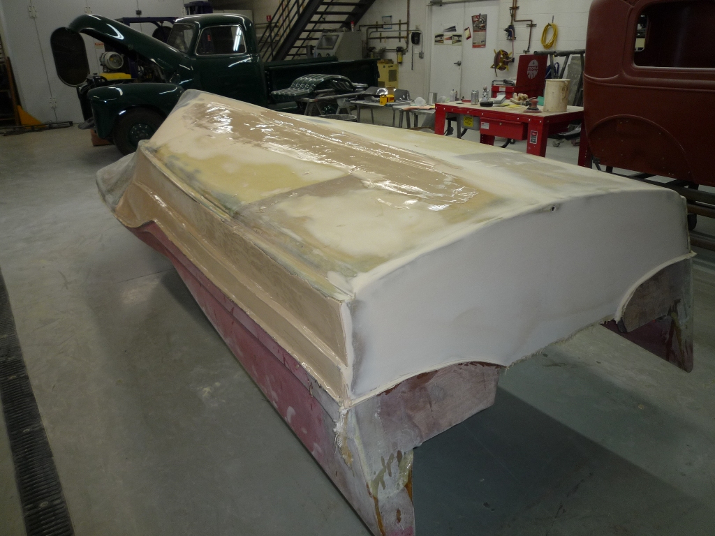

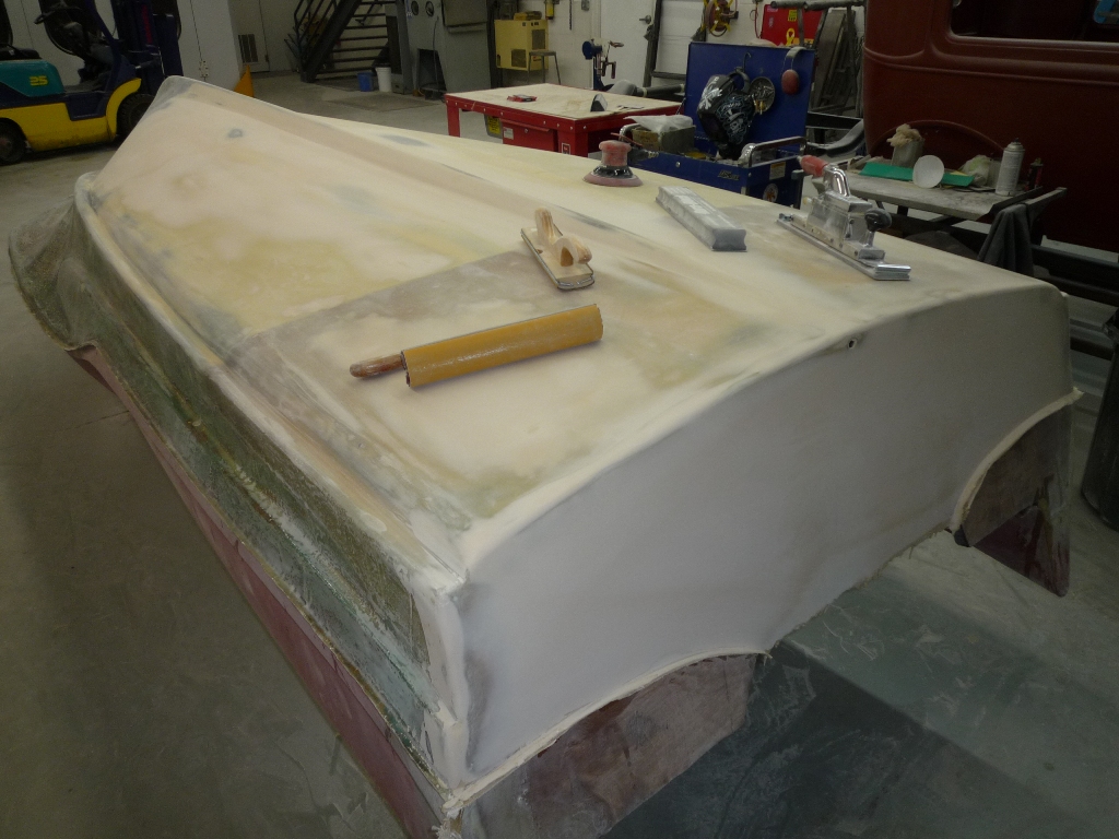

All sandied and ready for re-fairing :)

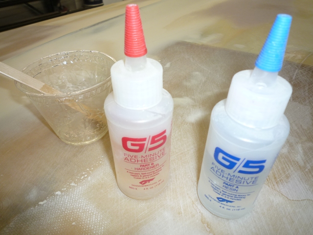

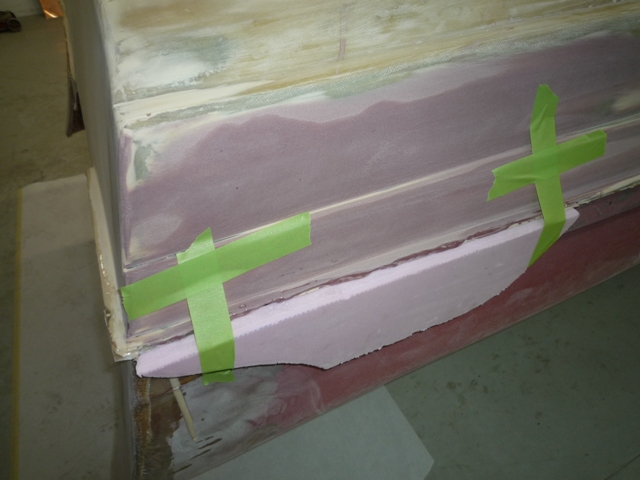

Great product for quick bonding.....
Re:Restofish continued..... 16 years 3 months ago #4591
  • finaddict
  • finaddict's Avatar Topic Author
  • Posts: 43
  • Karma: 3

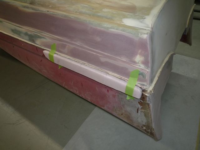

of styrene for re-creating bumper seam and straighting, etc. :P

fill-er up B)

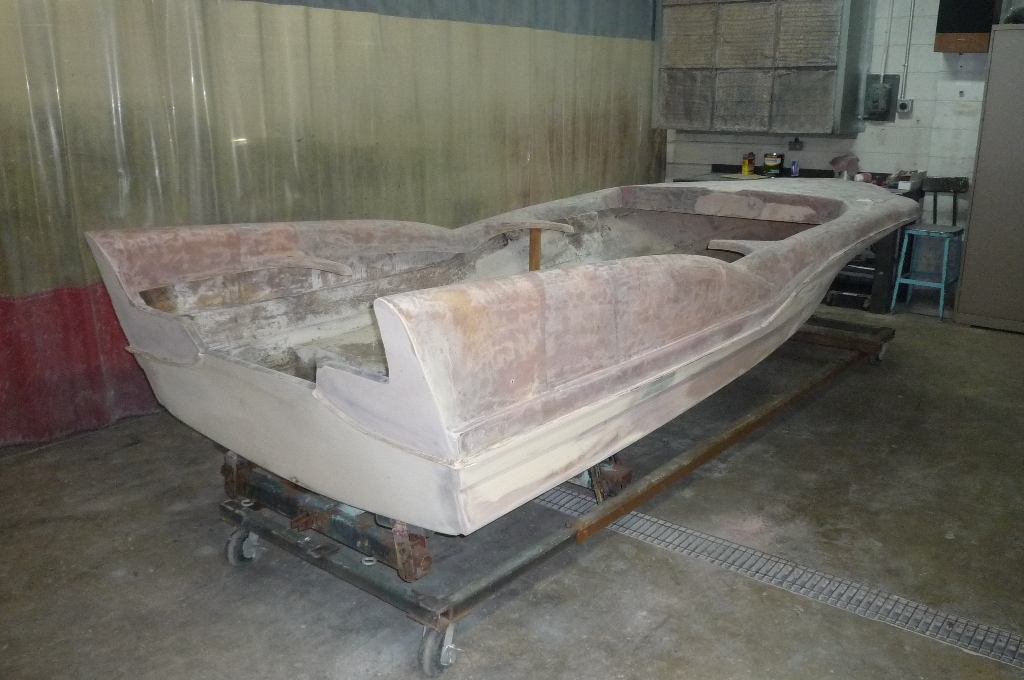

Horray! upright at last :)
