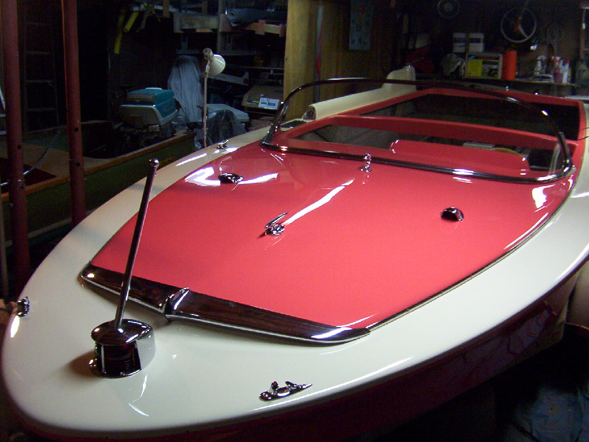

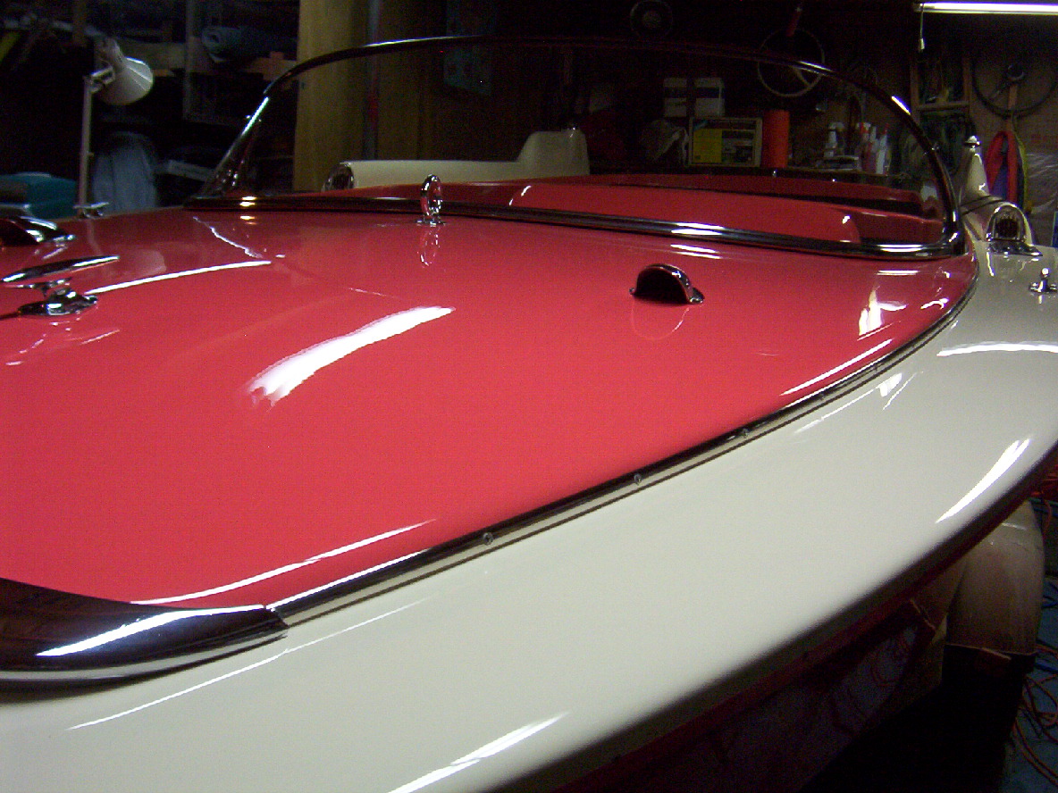

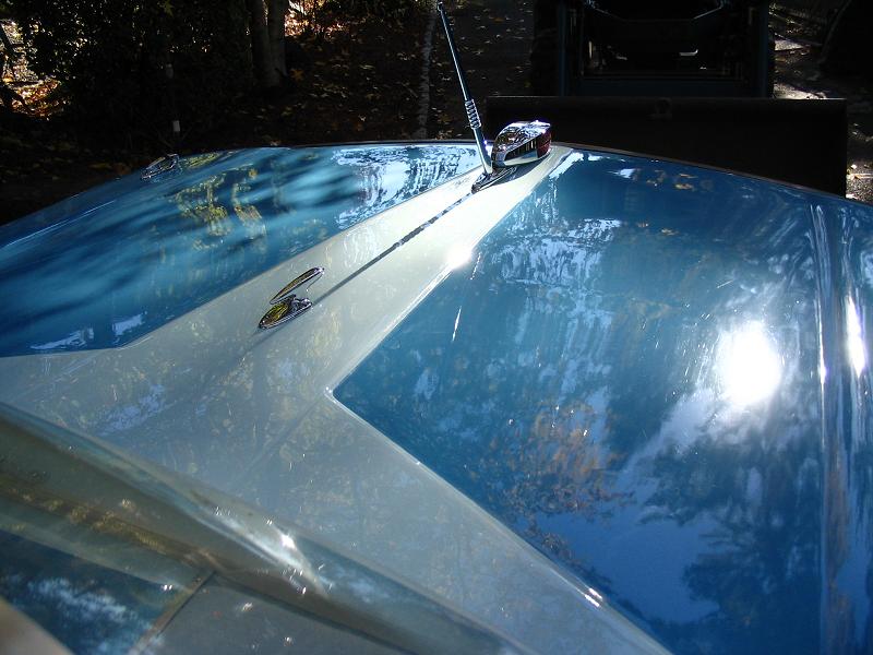

Awl Grip is much like this, great shine but hard to apply and work with for the amature.
When I did the Barracuda the White was done with Imron and the Coral is single stage eurathane, never clear coated
, just wet sanded and wheeled out with McGuires #85 diamond Cut Compound its
a ton of work, sand, sand, sand and buff, buff , buff but the results is attached.
JAG

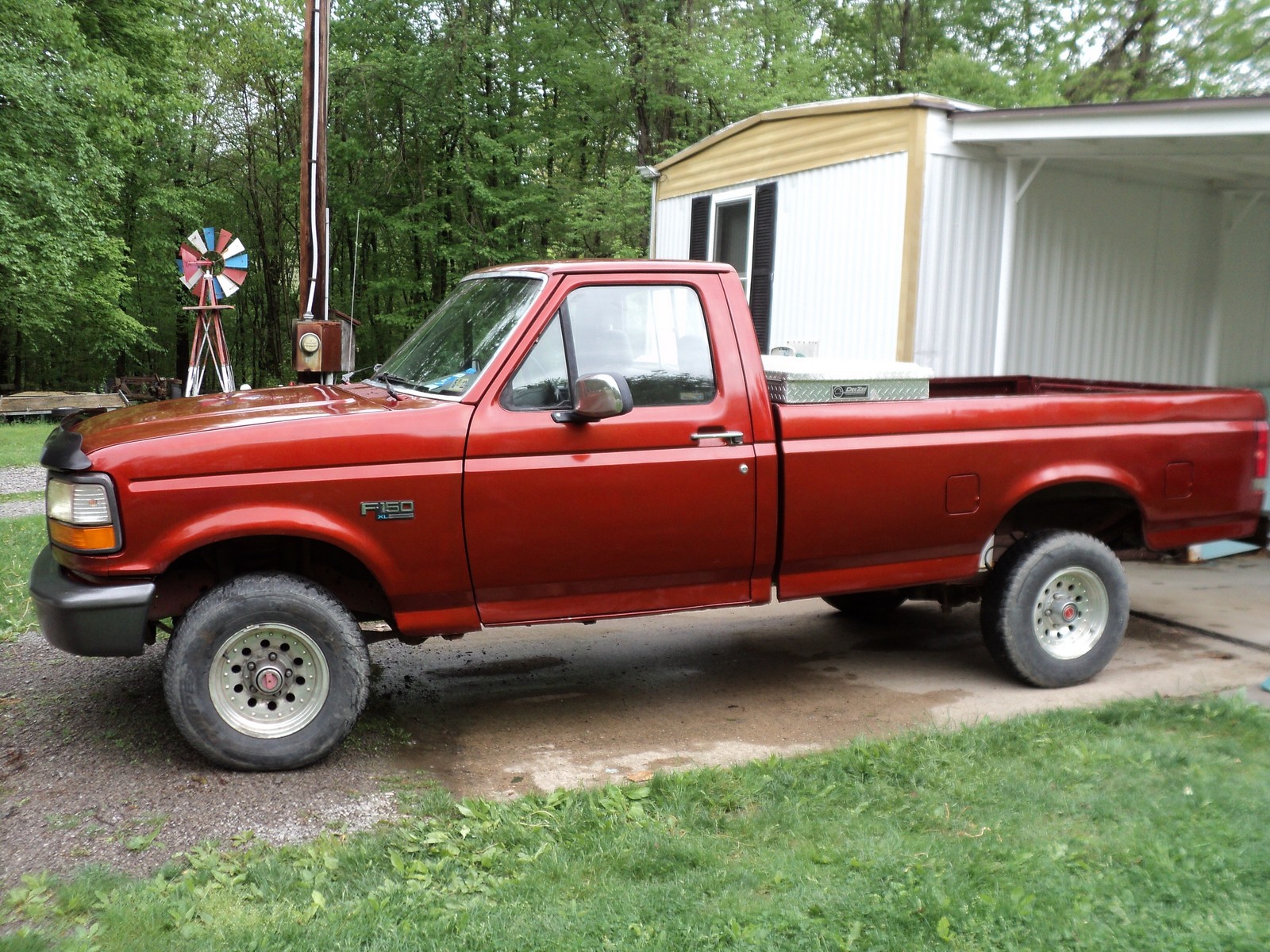

Thanks PC . Found that truck in a Junk yard that was closeing I was looking for another Diesel .He was saveing the motor and tranny for his roole off but didnt need it anymore .It was badly rusted .Checked it out and it had $6000 worth of reciepts in glove box for new long block and rebuilt 5 speed pluss new tires .Had less than 3000 miles on her since work was done .He had died and the kids let it sit long time and then I wouldnt start .Called the bone yard .The Junk yard sold me it for $700 .
Heres the Old Box
Heres getting close to paint time .New mexico Fenders , doors and rebuilt cab corners .
Box Done
Cab painted
And ready for reassembly
Its set up to run on Free Used Veggy Oil .Cost me 13 cents a gallon and registered it for life with Collector plates ...L.O.L.. Its cheap to drive , Tows the crap out of my car trailer and will haul some serious Fire Wood ..It was painted With Rustoleum John Deere Green , Valspar Hardner , And thinned with Xytol or zeylene (( I probaully did spell that right ..L.O.L...) Menards in town has Many colors of Rustoeum and the lady is smart and will blend me custom colors so your no longer stuck with like 6 ..Ive painted a few cars with it and its held up well .Including this .
Just dont tell nobody my Baby is painted in Rustoleum please ...L.O.L..Thats 7 year old paint on the Camaro in the pictures .If its in sunlight you do need to Buff her out every couple of years . Keep a cover on it she stays pretty .Just about any paint will need a Buff to look top notch after a few years outside thow . So ya Rustoleum I like . I was nearly broke when I sprayed it with rustoleum But Im happy with it now ..
