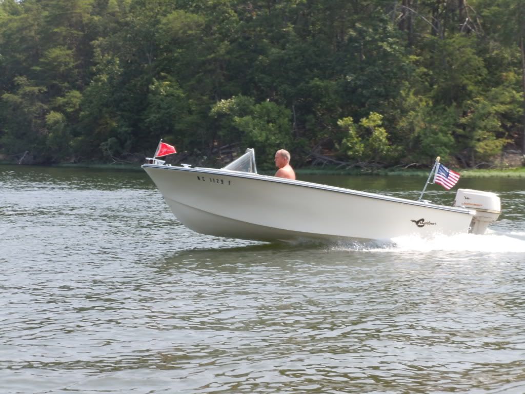

I've been noticing when I take the Crestliner to the lake,seems like the bow rides high even after I plane off and she don't like choppy water. What about putting an 80# bag of sand in the bow? What do you guys think?

your bottom picture doesnt look like its any hire than my Wagemaker empire clipper is when on plain. but I have never used a crestliner.

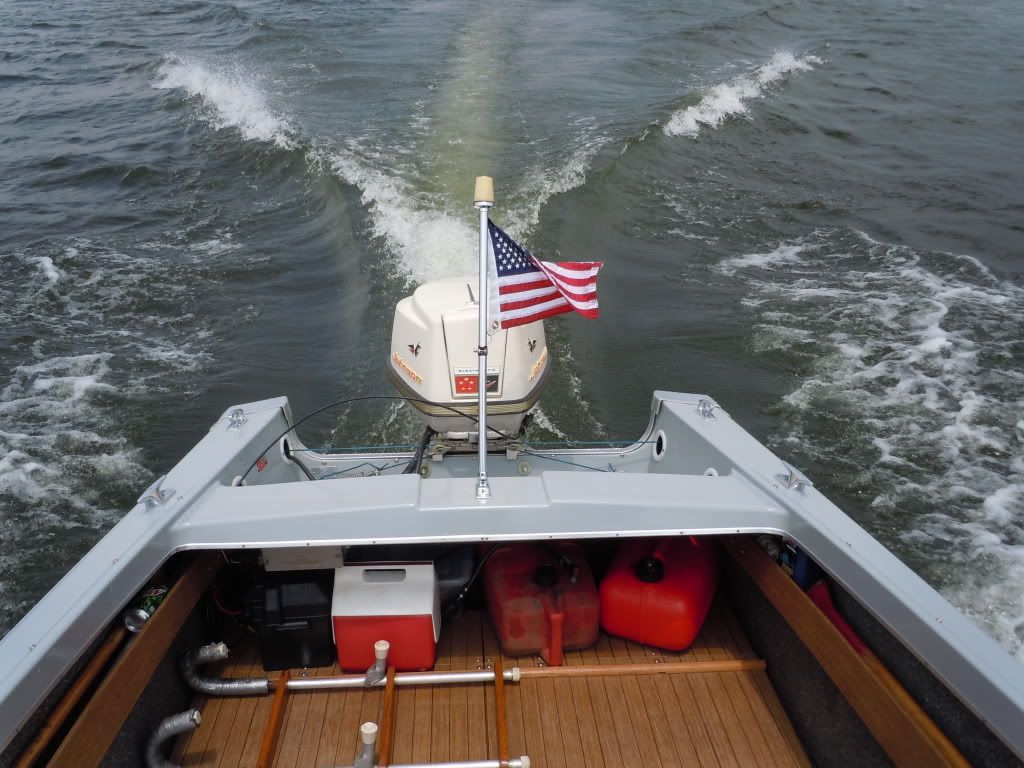

You may have to trim up the moter a bit there. go in or out on the trim holes one at a time until you find the proper plan. do you have anything overly heavy in the stern, other than battery and fuel? You may also want to make sure your engine is not to high or low in the water. That will also affect trim.

I'm sure you know but trim is huge in a small boat. I'd say to pull the motor in one notch (so the lower unit is closer to the transom). Go easy at first because if it's too close it will make the boat want to roll. Don't ask how I know but it's very uneasy feeling. I had to find the right angle for mine and then rearranged the seating to move the weight forward, problem solved.

After looking at your video of the boat up on plane you are riding just where you want to be. I have a crestliner with the same hull basicly and mine rides like that also. They come up on plane fast and allways seem to ride high. That engine could be trimed up just a bit if needed. putting extra weight in the bow useally just stresses the hull to much with all the pounding.

Thanks for the offer wavetrain,but I think I'll pass on the cavitation wings.If I move the motor one notch in, it's too much towards the transom.I have a compartment up front under a removable piece of plywood. Might add 40# or so up there just to experiment a little. ;)If that don't pan out I'm going to check on trim tabs. Thanks guys for the ideas.jim

Didn't look like your bow was too high to me Jim, once you got planed out. If you bring it down much you'll be plowing water, but guess it's worth a try. It was just you in the boat, right? If you carry any cargo or passengers it won't ride so high. I wouldn't worry about it too much, unless you're just uncomfortable with it's attitude. Just my two cents.

I guess I'm just been in the other boat too long,Mark. I'll have to say that the 75 on the crestliner has got a little faster take off and top end than the other 75 I have and it's running a 10x11 prop verses a 10 1/4 x 10 on the aristo. Could be because more of the crestliner's hull rides up out of the water.Probably a little lighter boat also.I also got to thinking about the possible plowing if I add weight. And watching the crappy video, I've noticed how tall the hull gets from the rear of the seats towards the bow and the actual bottom of the boat is planing about right. I believe you and skip are right on this.thanks
