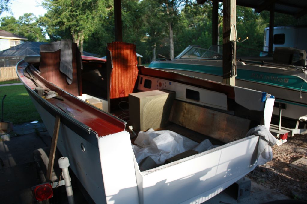

Had to section and taper the Seafair's side pockets to clear the saddle tanks. Then I had to extend the side pockets to compensate for the shortened and sectioned splashwell.

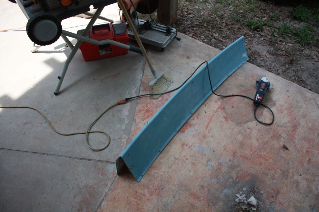

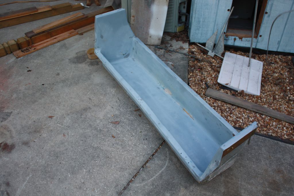

The woven roving made the form, but it's too flexible. I just went over it with mat to stiffen it up and thicken it. I'll start body-working it tomorrow. You're right, Mark; I've got myself a project... and ALL projects turn out to be bigger than we think they'll be!
