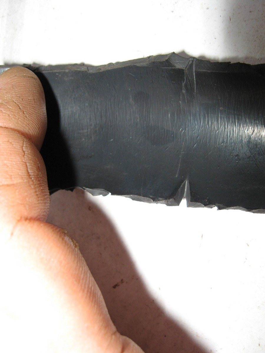

A man I know said he thought it is my fuel bulb. The gas lines are not breaking down. I cut a section out to look at them. The bulb is suspect. Alcohol is able to take the moisture right out of the air in the tank. I'm running on a three gallon can. The ethanol molecules bond to the water and carries it through the system. The stuff separates from the gas leaving a nasty brown mess. I had some in the Cub Cadet. I flushed it out before starting it this spring. Everything else was run till it was empty. Ethanol just tears up the rubber parts. When I buy the new hose and bulb I'm cutting the old one up to check it out.

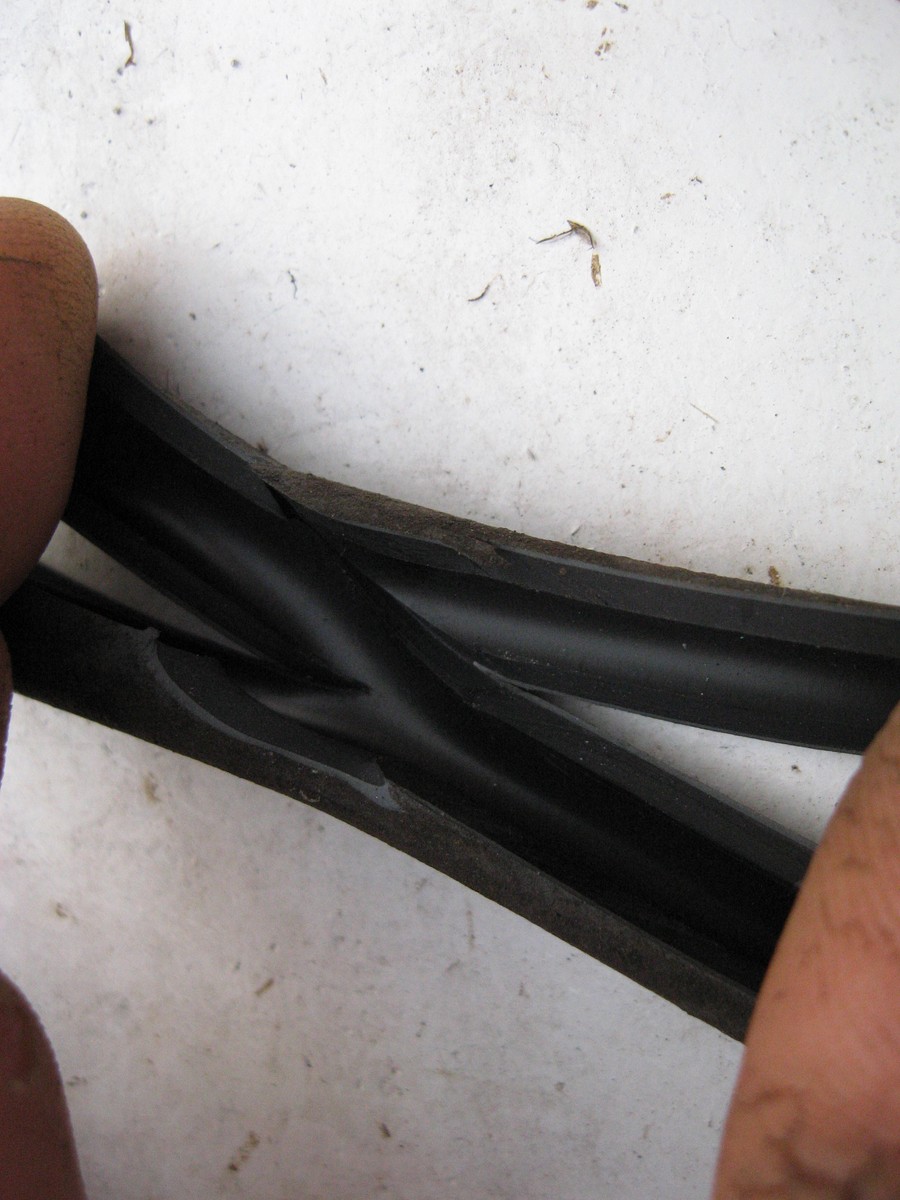

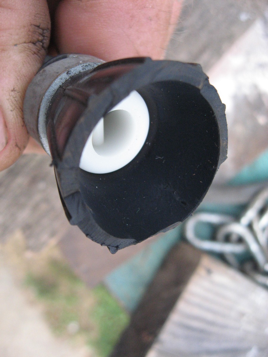

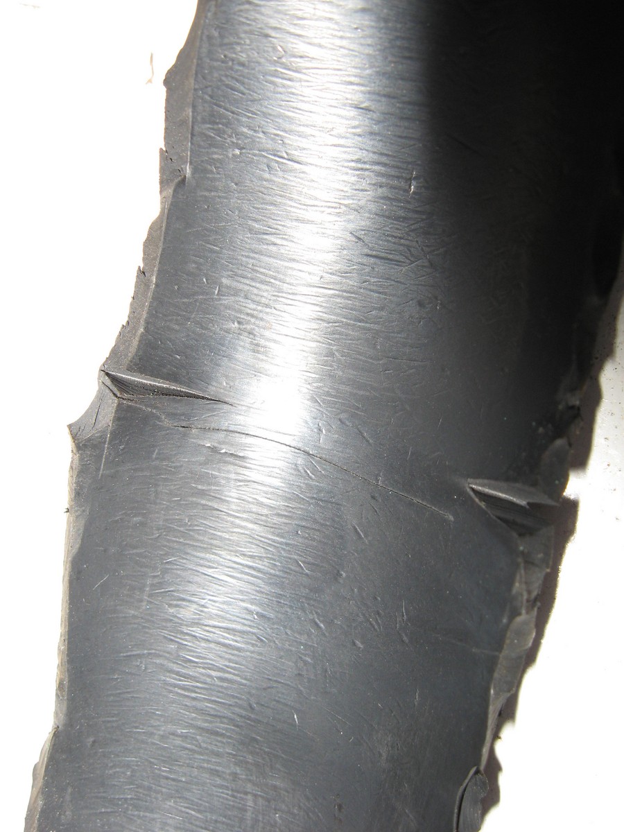

Re:Ethanol or not ???? 15 years 1 month ago #38590
Here are a few pics of the inside of my fuel primer bulb. It is a Honda item. Looks a little ragged to me. The other is the fuel line cutting.
Re:Ethanol or not ???? 15 years 1 month ago #38649
I might also add that I got black stuff on my finger from the inside of the bulb. I hope this will be the end of the problem.
