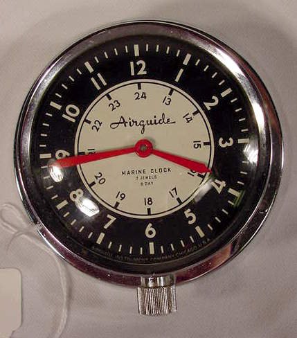

That is just a 7 jewel 8 day car clock. Can you get a pic of the movement when you get it back? Unless it has been dropped and the staff broken, all it could really need is a cleaning and/or a mainspring. I would send you over to the NAWCC board but, same as here, without pics no one will be able to ID the movement. I am sure airguide didnt make it.
I'm sure somebody has a movement sitting in a drawer. There just isnt really any demand for them except for a few restoration projects.
As an example, I recently sold a WWI british airplane 8 day clock with all the correct markings on the case for 67.00 in running condition.
Find out the info on the movement and we will go from there.

Just to be clear, this is what we are talking about and not the chiming marine clocks they sold for large ship use, correct?
Re:airguide clock... 15 years 1 month ago #38322
Yes, that is what it looked like. I got it from Brian, took pics for Ron, and delivered it personally to Ron a week ago today.
Frank

You need to go to a local family owned jewelry store that does watch repair. NOT clock. This is a plain jane pocket watch movement. A clean and oil with both <yes it has 2> mainsprings replaced should be around 100 tops.

yep thats the clock..i'll see if i can find someone local. that estimate was from a guy in houston. also does the ring have to be pryed off? i can't figure out how to open it up. staff is fine .it pulls out to set time and when pushed in it winds ..but only one way. i can also hear a sound. thanks, ron
