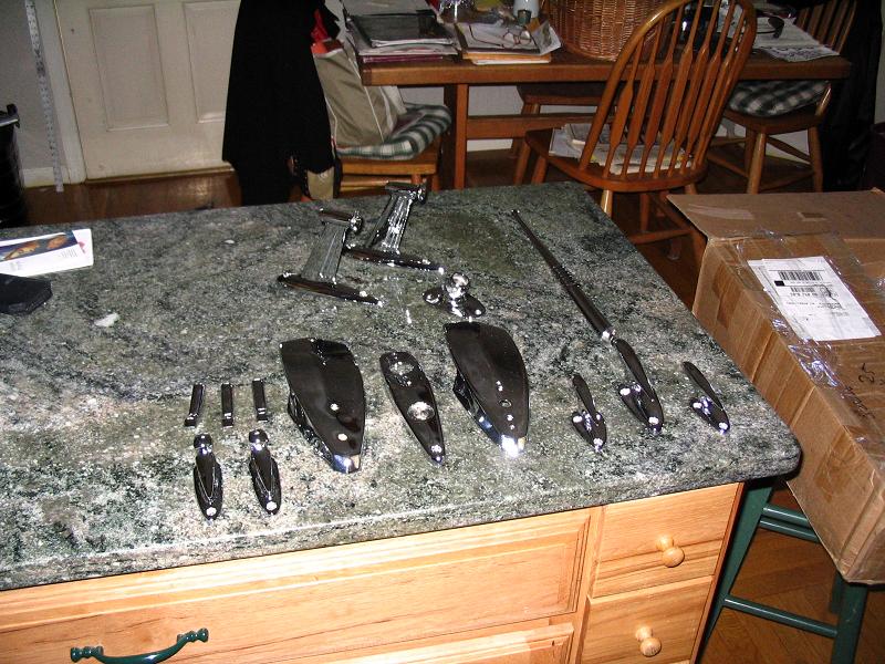

this is a little tedious , but if you look in ebays boat parts and use NOS and or vintage as the search criteria you will see whats listed daily as new old stock.or used pieces..it will take some time but I just replaced all the hardware on my Glassic this way...maybe 2 months? checking new listings
I spent $400 and 90% was NOS, it was cheaper than re-chroming but work

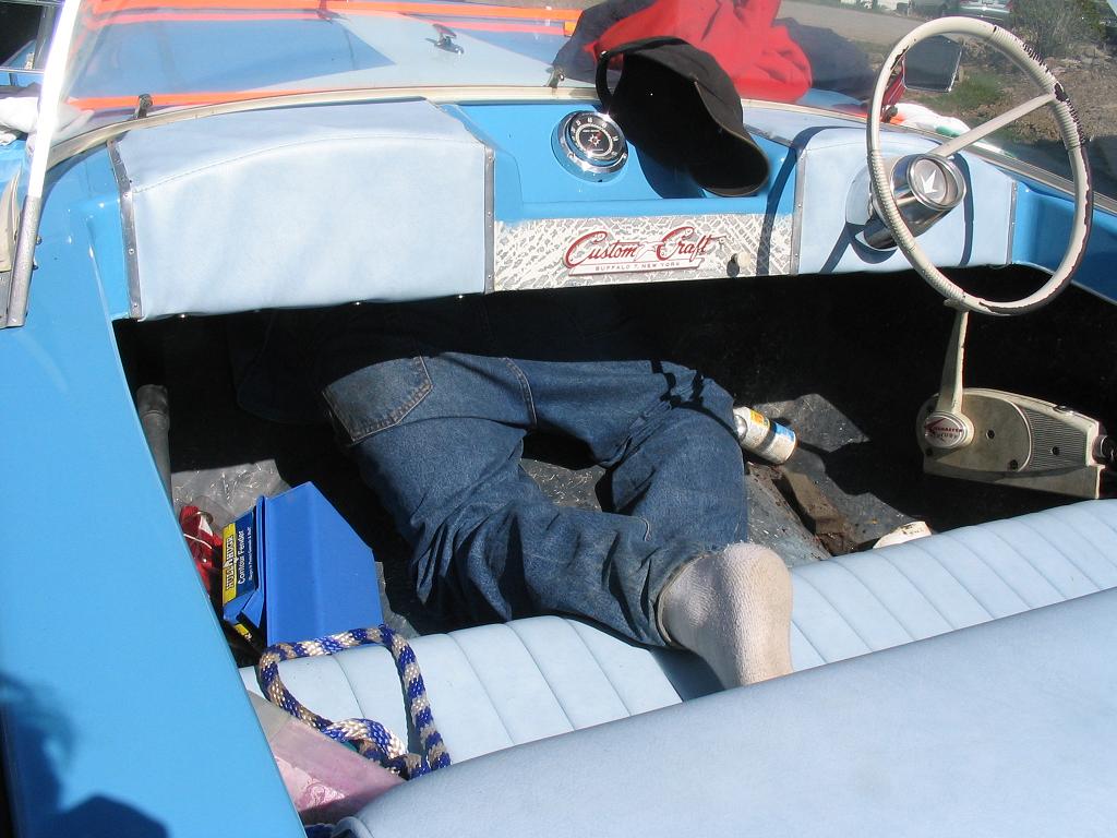

I recently experienced this same issue on my current project Clark. I noticed the wood backing inside the hull for the bow eye was rotted, and since I'm replacing stringers and floor, etc. I thought now was the time to put a fresh backing board behind the bow eye as well. When I put a wrench to the retaining nut it snapped the bolt off all too easily! Rusted through just like yours. Thoughts of that bolt snapping off while trailering down the road with a finished project Glassic went racing through my head, would NOT have been a pretty sight!
All hardware like that should be pulled to be re-bedded and resealed at the very least, that's often a source of water intrusion into your 'Glassic boat. And any signs of rust or weakness would dictate replacement for obvious reasons of safety, IMHO. Even if you don't pull skiers, tie downs to trailers or emergency towing of yours or other distressed craft would put major importance on their structural integrity IMHO. Be safe out there folks! ;)

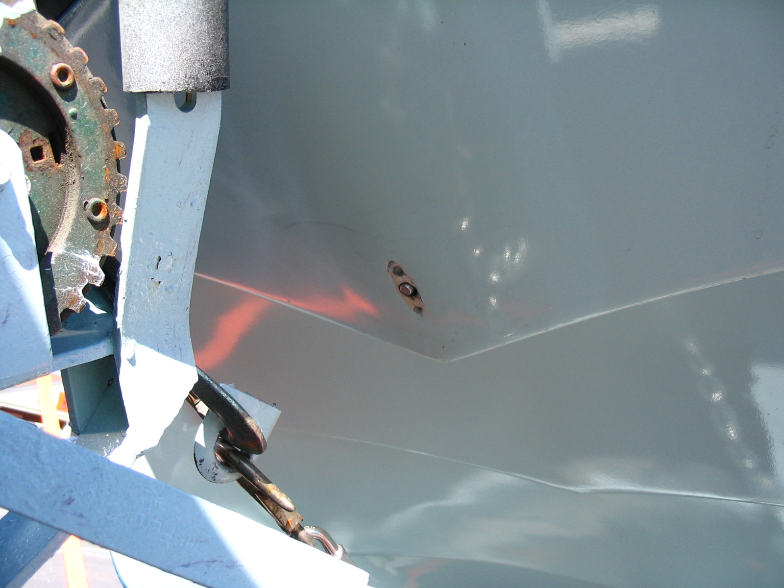

mine let go on our first trip to silver lake in 2006 doing 60mph all i saw in my rearview was the tunnel. the wind lifted it up around 4 feet. it wasn't rusted though. houston re-attached it. no way could i have gotten under there.
