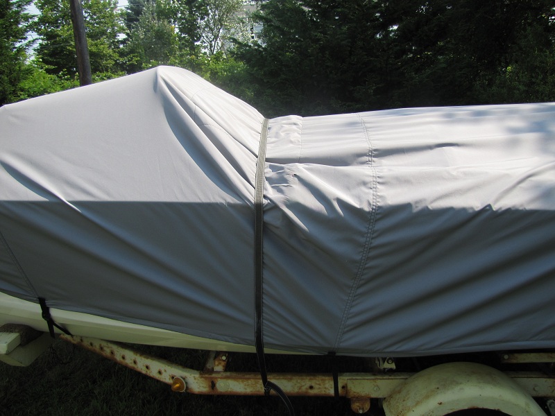

Trekking the Aqua Ray to Hammondsport this weekend was the first time I have gone any distance with the boat under a trailerable cover. I bought this as a "semi-custom" through West Marine. It needs some modification, but is not bad as a base.
One problem I noticed was the additional windage the cover created. This was no more apparent than when I was driving up and down the Catskill mountains on Rt 17 in New York. On the way out, it was a struggle to get up some of the steep grades. The cover is far from a custom fit and there is a lot of blousing. On the way back, I came up with the idea of tying the cover right behind the windshield with a piece of rope. The impact of that was remarkable. The whole rig drove so much easier. No more power problems and better mileage as well.
The pic shows a strap I will use and where it was tied. Mine is connected to the trailer, but probably could go around just the boat as well. I'll always run with this from now on.
This may be common knowledge, but it was new to me.

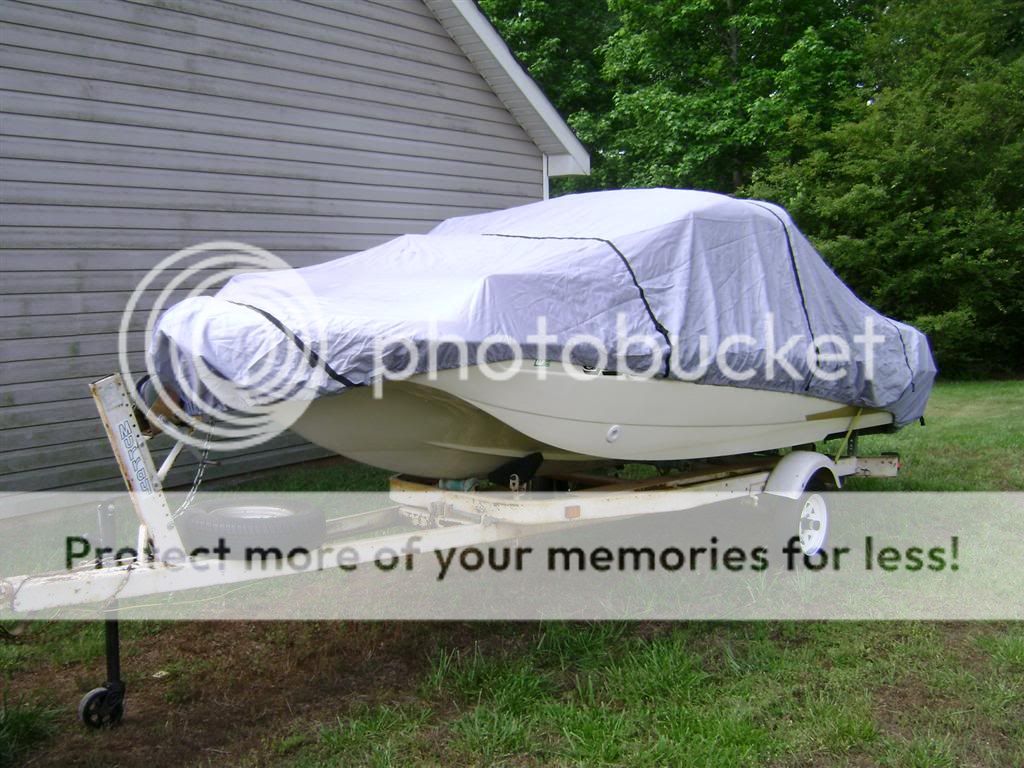

Strapping the cover over the top REALLY helps!
I just got an off-the-shelf cover for my Citation-
Its a GREAT fit, even better once the support bow is in the back. Best of all, it's only like $60!
If you look, in the same places where it is strapped to the trailer, there is another snap for a strap that goes OVER the cover when you're trailering. It prevents the cover from ballooning out while you're driving.
You can do something similar on yours- Put a webbing strap over the cover at each point it attaches the the trailer, over the top of the cover. The difference is amazing!

My only thought about having it sewn in is that it might not make it easy to gather in the excess (unless that strap was in a sleeve and not sewn on). The strap will follow the contour of the cover and not be able to cinch up very well. The separate strap will gather the excess.
One of the other modifications I will make is to sew on some triangle shaped pieces of heavy canvass under the plastic strap fittings. I did have some marks from it after the trip. Also tie off the ends of the straps so they can't rub on the boat.
TT makes some good comments, but after coming back from the Buffalo show last year in a partial rain storm, I decided the cover is well worth the investment. This additional strap that I installed on my cover eliminated a lot of the extra drag and it felt like I was towing just the boat.
