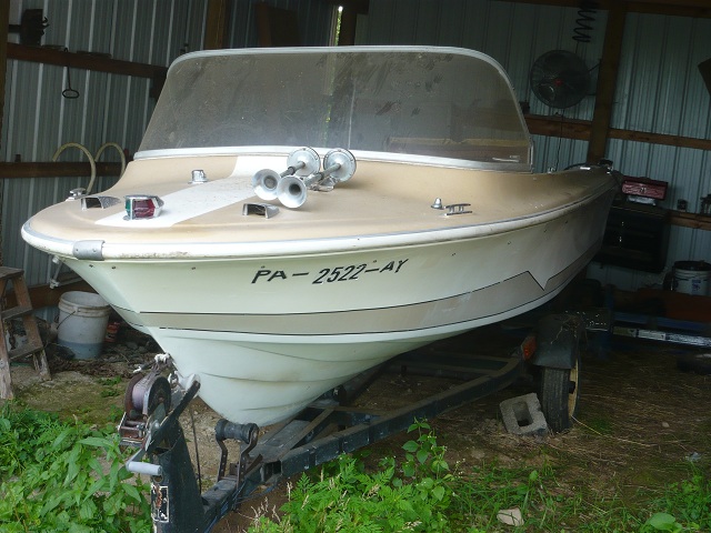

i bought this 67 larson all american with trailer for $100. it needs some floor work, i thought it was a week spot in the floor, it turn out that it was repaired before and they put the seam of the two pieces of plywood in between the two stringers so thier was no support? the floor is out and the stringers are in fair shape. this is my first boat project and any help or info would be really appriciated.

Welcome aboard, glad to have you here. Some pics of what your doing and need the help on wi go far. Take a few pics of the stringers etc. and we can go from there. Lots of good folks here who can help.

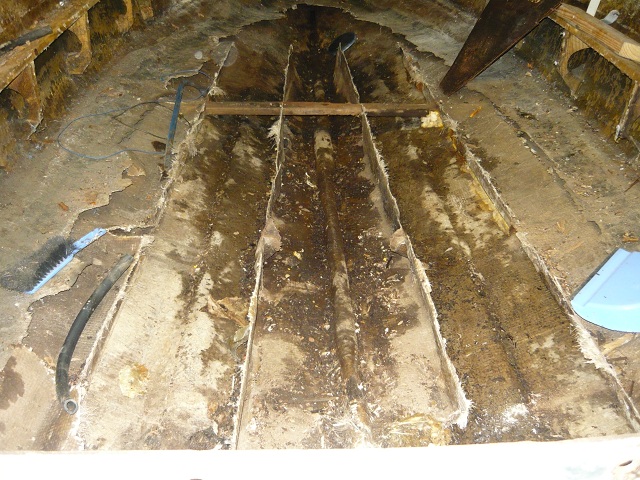

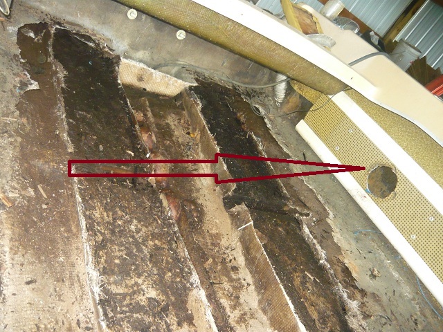

here's some photos of the stringers.
Re:larson help 15 years 1 month ago #37644
Hard to tell much from the pic, but looks like you need to go with new structure in there DT. "I feel your pain", here's the thread to mine;

nice looking boat ya got there, nice work to. i don't think mine will turn out as nice. i'm gimped up from a spinal injury, so i explain what/how to do things and my 15 year old son does the hard work...his attention to detail still needs some work. i told him he better fix things right. since he's the only child, he's gonna inherit all my toys (66 bolens 1050, 67 750 bolens, 1956 allis chalmer wd 45, 71 chevy truck, and the boat). i ask him if he wanted to inherit junk or a nice classic boat. that put it into prospective for him....now he's paying a little more attention.lol
any idea how thick those stringers would be?

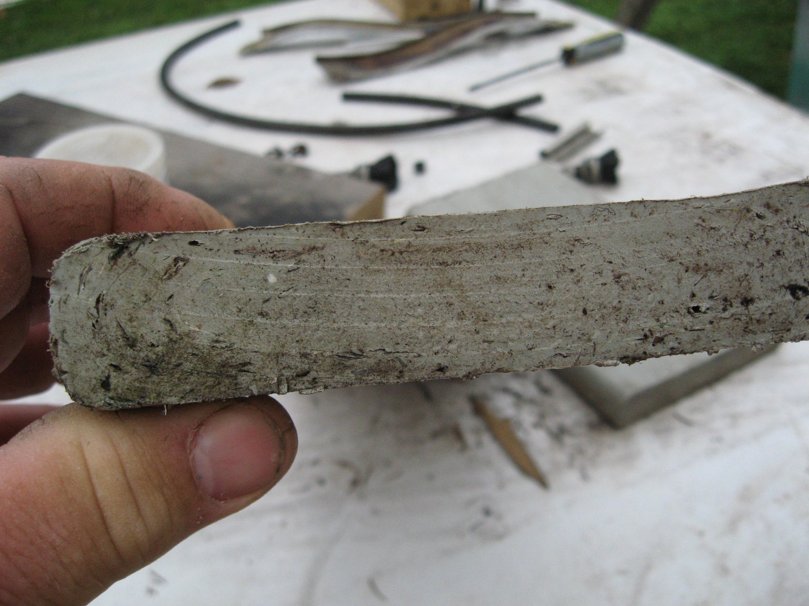

yep, stringers were junk, took the fiberglass off and the wood disinegrated like wet cardboard. the boat has been in my garage for over a year and the wood was still soaked.. well it's mostly tore out, now to find some 1"x10" treated planks some treated 3/4"plywood. sunny and 90 + degree's this week, so that should dry out all the foam. get started next week putting it back togethar. i'm thinking of glassing studs into the planks to bolt the seats to, that way i'm not running lag bolts through the glass and breaking the seal.

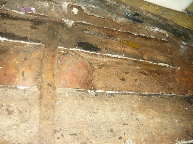

well, the floor is out. fortunately nothing was glued or expoxied to the foam, it was just sitting on it. no grinding. i left the one stringer in for referance purposes. bad news, while tearing out the floor i noticed the bolts for the motor that are going through the transome were starting to pull through. rub rail is off staples are out, just have to seperate the top now and replace the transom. ahhh, gotta love it. it ought to be good as new when it's finished. temp is up to 91 so time to quit for the day.btw sorry about the pic's, im not a photographer.

boat is now in two. most of the wood & foam (that foam is just nasty) is out. what is the purpose of the foam? all it seam to do is hold water & rot out the floor? there is no hoses to let the water drain from the front of the boat. something i will have to correct. the floor boards are just 1x4. i think i will use 2x4's. there is no floor support in the bow, the plywood was just sitting there. pulled out in 1 piece. any hints or tips you fella's have for doing this boat would be appriciated. this is my first time working on a boat.

DT,
Some more experienced guys and gals who have done this will jump in here but to answer your foam question, it's there for bouyancy. Especially, god forbid, if it flips over. It helps keep it afloat instead of sinking. As far as the stringers go, I would run two parallel to the keel about 6" to 8" either side of the keel, as far forward as possible, tapering to follow the hull line as you get toward the bow. I think 2 x 4's are over kill and will probably make the boat heavier than it needs to be. If you use 1x4's yu should be fine once they're glassed in correctly.
Just my two cents worth. Smarter folks on here can chime in and probably give you better advice than I.

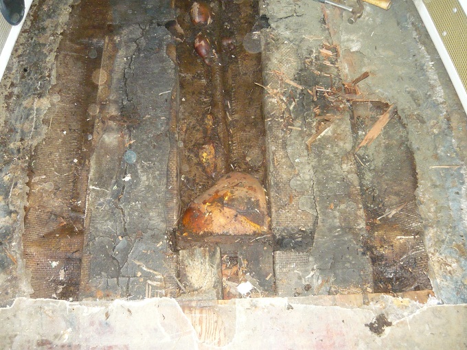

foam is out and all that is left is a 1x2 running the middles of the boat at the "V". there a small 4 inch squares 1/2thick scatterd on both sides of the 1x2. i'm relplacing the 1x2, but the squares are treated plywood and in good shape. thanks for the info on the foam, guess i'll be putting some back in.

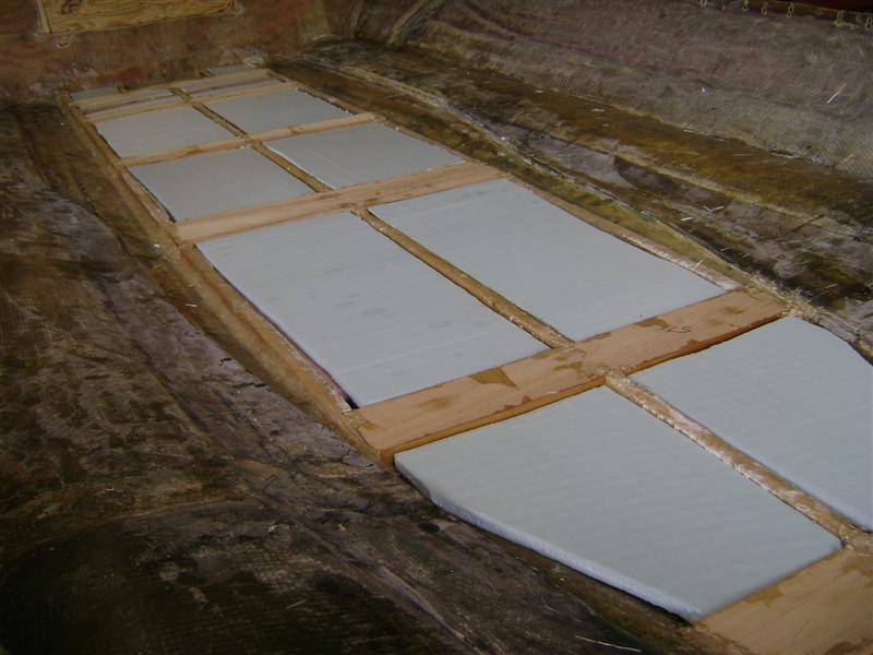

my question is wether i can use the 4x8 sheats of foam you get from lowes, or wether you have to use the pour foam or simler stuff from a boat dealer? also, the rails running down the inside of the boat. is that a factory thing or somebody's handi work?
Re:larson help 15 years 1 month ago #38927
Your boat is not ugly, DT, and there have been several responses to your questions. Sometimes getting a response takes a little time. Don't take it personally, okay!?
I used the foam you're talking about from the building supply stores, had a little extra laying around and doing my project on a tight budget. I don't think there's anything wrong with it, it is closed cell foam so it won't absorb water.
There are a few places I'll probably use the "great stuff" type foam, where it will be less likely to be subjected to water intrusion
The little hole you're pointing at looks like a speaker hole somebody cut into the boat, just my opinion...... ;)

the lowes foam is alot cheaper and i'm deffinetly on a budget. i'm thinking of running pvc plastic pipe (3/4") down the center of the boat on both sides of the v & on both sides of the foam, to allow any water (there better not be any after all this work) to the back of the boat were the drain is. using the great stuff to hold the pipe in place. then using the sheat type foam above it. wet foam and wood don't seem to go well togthar. from what i've seen on this boat.

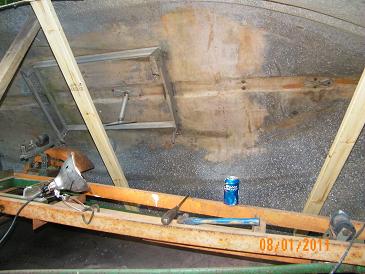

Here's a little tip before you flip your boat. Get some cheap 2x4's, I usually pick up the ones that are tossed by construction people. cut them to the width of your hull and screw them in place. I use regular drywall screws with fender washers. This way you brace the sides, keep the intrgrity of the hull and you can flip the shell over without worring about cracking it in half.
Here's a picture where you can partially see what I'm trying to describe.
