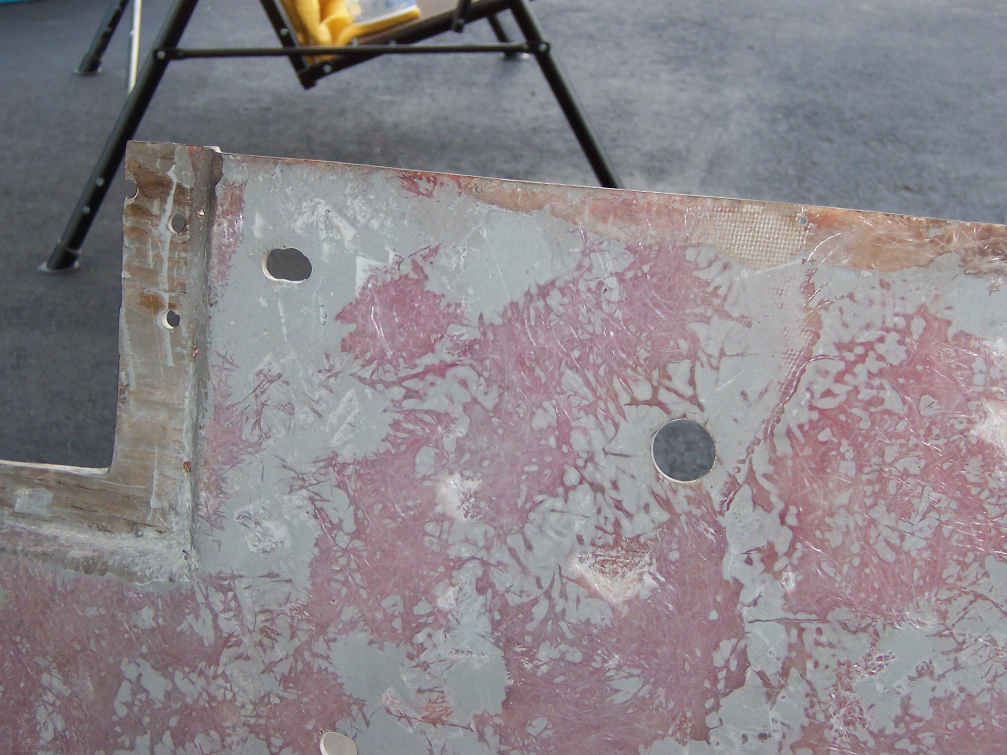

If you are putting a new transom on, the general practice I believe is to use a layer of fg cloth between the outer layer and the new transom. I use epoxy when "gluing" so I'd sand the area enough to get a rough texture and then use epoxy then fiberglass cloth then the new transom. You can mix epoxy with microballons to get it thicker to help fill in all voids.

I don't understand why anyone would bond the glass to the plywood transom with a putty, could it be a layer of epoxy? In any case, if it were my project, I would get rid of it so you have a good surface for a solid bond to your new wood... I would sandwich a layer of thick mat, saturated with laminating resing beween the original fiberglass shell and the new plywood, clamped very well.

My boat is registered as a 14' 1970 Star. I am not sure about this because there is no plate on the boat anywhere. I would post a picture but the deck is off of it now. It has a closed bow and sits low in the water. It looks like a small speedboat. I have a 1975 70hp Johnson outboard for it.
The stuff I thought was putty could be epoxy. It is grey in color where the fiberglass is pink. I have posted a picture of it below.
I think I will try to sand more of it off and add a thicker mat or two before the plywood goes on.
