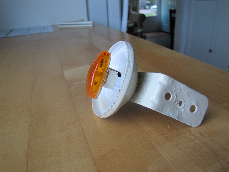

I still haven't done the trailer project yet, however, the original lights are finally completely shot and I need to upgrade. The plan was still to use the original fixtures and convert them to LED. Yesterday I was at West marine and bought the cheapest LED light they had and decided to give it a try. LO and behold, it fits in the existing socket perfectly! So I gutted the rusted part, cleaned up the fitting and away we go. Now to figure out the tail light.

Good work Todd, great idea. Someone recommended these guys for replacement bulbs too;
marineledshop.com/
I think the tail lights would be an 1157 bulb, they make an LED replacement if you wanted to go the same route as the markers.

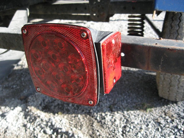

Re:LED trailer light conversion 12 years 11 months ago #64048
I didn't retro-fit mine but replaced the whole light with LED ones and I can't say nothing bad so far. They are bright and I have not had to replace any as of yet. I went through regular bulbs like a change of a shirt it seems.
