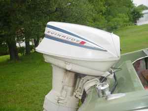

Found a 1968 Glastron center console not sure of the model, it was made in Austin. It has a 68 Evinrude 40hp ES this was in great shape and tried to fire up in a bucket. Cables, wires everthing looked great.
I got a price of 200.00,is this motor worth the investment?
The boat needs transom and floor (total rebuild). Trailer was there needs paint and new tires soon.
Please reply quickly the deal will not last long!

200 for boat/motor/trailer,,seems okay to me. The transom repair looks like you will have to pop the lid or use the pourable method.Is it worth it? are you up to putting some time into it? Trailers go for 1-200 all day and the motor with controls if running and has good compression is worth 3-500 as well.Do you want a project or are you looking to flip it for a small profit.If your asking after I restore it will I be able to sell it for a profit,,probably not.

I was wondering about the motor. Are these known for having any major problems? With the electric shift I was a little leery. I have a 1960 Lido waiting her turn for rehab. And that motor would look great on her. The rest would be scrape unless a Glastron dude would wanted a project.
Two transom / floor jobs a century is all I will allow myself. One has to pace themself on how much fun they have. :S

I too personally shy away from the Electric Shift OMC gear. Too many times someone did not use the proper LU gear lube and the solenoids etc suffer. That said there are thousands Im sure still out there running like a top.
I would say if you can at least verify good compression it should be worth while gamble for $200. If it ends up toast it is very easy to tear apart and part out the good stuff and you'll get decent money in scrap for the rest of the aluminum(best money if you take the time to separate the steel(some bolts etc) from the aluminum)
Good luck with your decision

With regards to the electric shift if it currently works you should have no problem, just use the correct lower unit oil. The pushbuttons on the control tend to get worn and have poor connection. If these are all right no worries. The controls are getting harder to get and parts for the switch are impossible. There is an access plate on the side of the exhaust tower that you can remove and expose the 3 wires that run to the gear box. An ohmmeter will tell you if the solenoids are ok.

If you understand the electric shift then you have a different opinion than those who are puzzled as soon as " electric " is mentioned.
Make sure the generator is installed and working as that is a key component of the system.
Those motor often have cracked ignition coils ( unless recently replaced ) so that also needs to be checked.
They are not solenoids !! , just electro magnets.
With key " on " put it in gear.
Prop should " drag " one way and lock up turned the other way.----Electric shift is good and reliable.

Randy, before you try it out in the lake make sure it's got a good water pump impeller and will not disintegrate and clog up your cooling system. The way I check out the electric shift on my stuff is 1st remove the coil wire from the coil.. 2nd hook a battery up to it.. 3rd turn the switch on and then put the shifter in forward and try to rotate the prop backwards .. It should be "in gear" and lock solid to the driveshaft/powerhead. To check reverse, put it in reverse and try to rotate the prop forward. Should lock. It don't do the forward spring/electromagnet any good to rotate the prop forward when shifted in forward(hard on the forward spring when twisting it backward).my2cents
