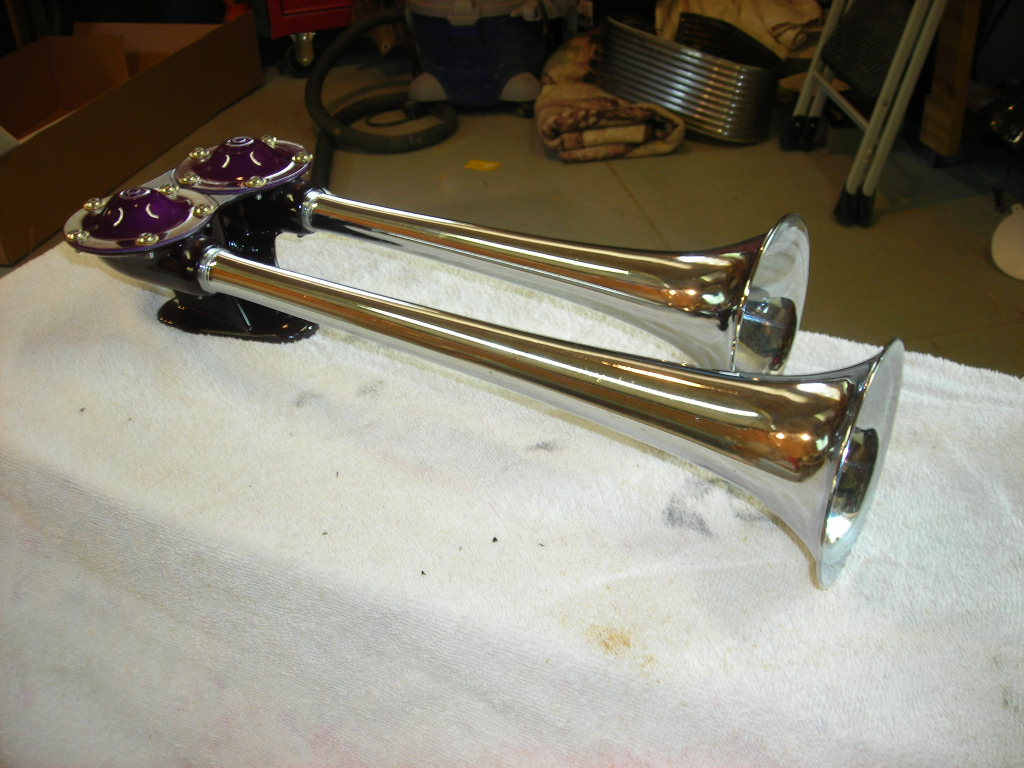

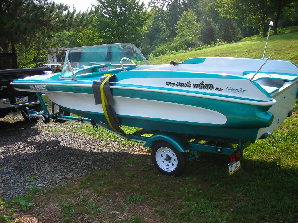

after skips horns are done i have to finish the windshield visor,with paint and vinyl,then paint the motor and install some stainless sheeting ,i dont want the cranks crackng anything.

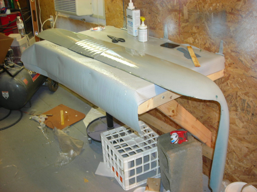

then we will put the motor on it and hook it up,i gotta hurry the best i can ,the hammondsport show is the 16th of this month,im glad im going to have ed here.i worked on glassing the visor while the top of skips horns were drying.i scratched the top while tring to put the screws in,i hate slotted screws.john

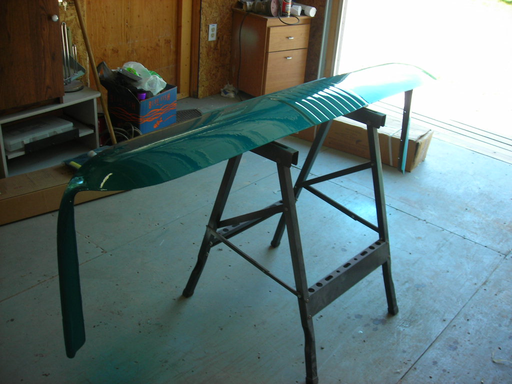

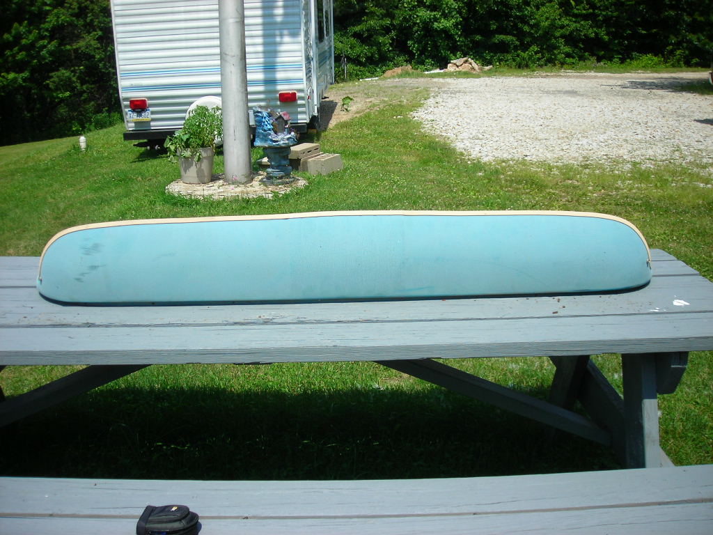

here is the only pic i have left of the visor on the boat. next comes the sanding.

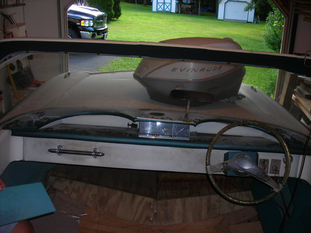

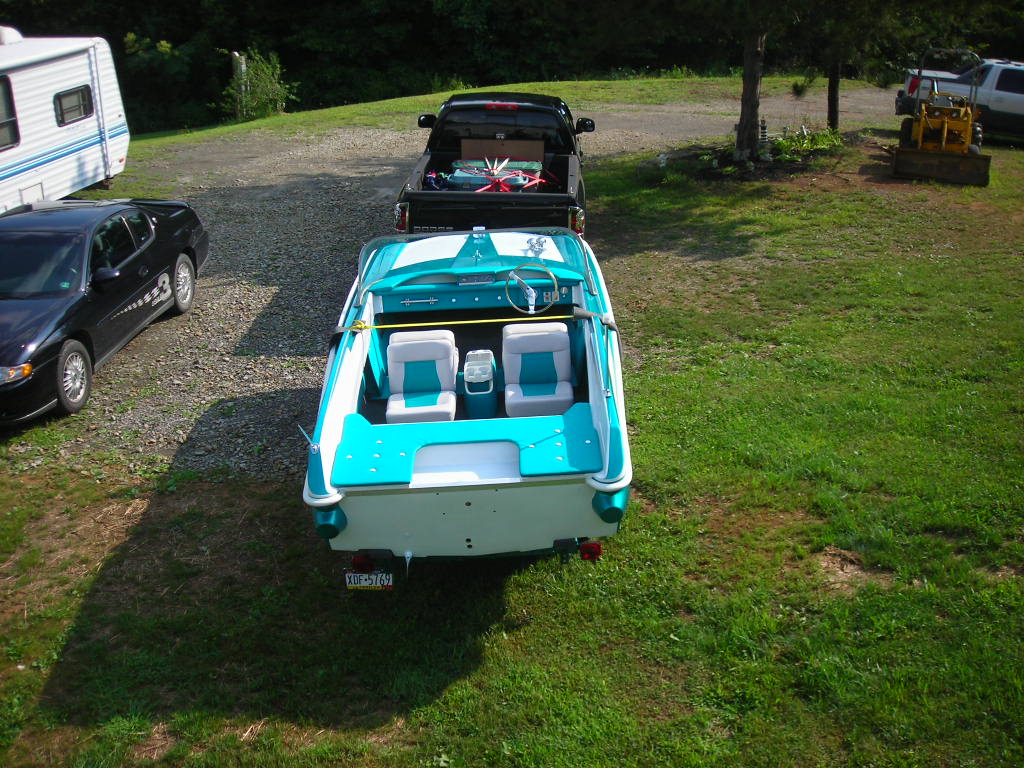

by the way for the new folks here is what the dash looks like now.

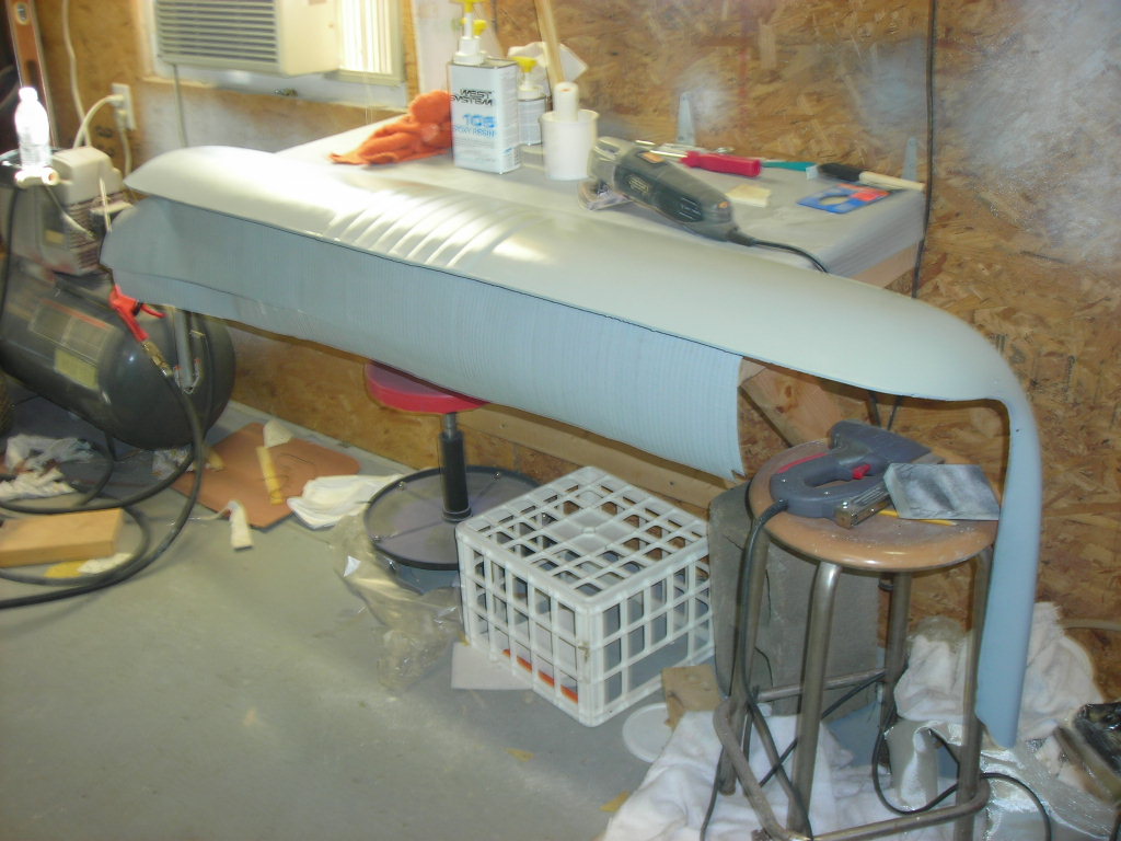

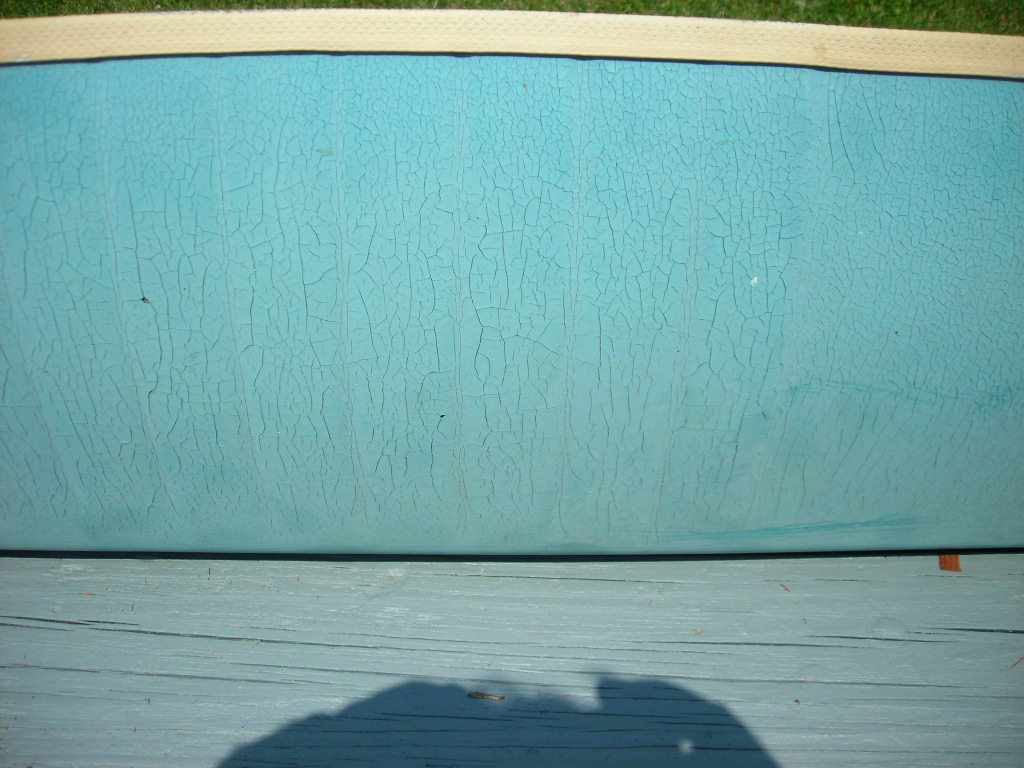

1st of all I have to say of all the runabouts that show up on these pages that Sunray is my absolute favorite. Looking at the 3rd photo of the visor the gel coat looks pretty bad and was wondering if you ground it all off or just used a filler? If I remember correctly you recommend a resin jelly. What were the steps you used? Thanks.
Melanie
Re:still working on the sunray 15 years 2 months ago #36079
  • john-gibson
  • Posts: 4014
  • Karma: 324
hi mel,and thank you that a very high complement.
mel i used a filler primer,then sanded,cleaned with rubbing alcohol,then glassed it,i will sand it smooth then reglass it,then sand again,then paint on the top side,and vinyl to the under side,i usually do use resin jelly ,just not this time.
this is kind of an experiment for me,just to see if it works without the cracking,i will let you know,if it does crack again i will glass cloth over it,john

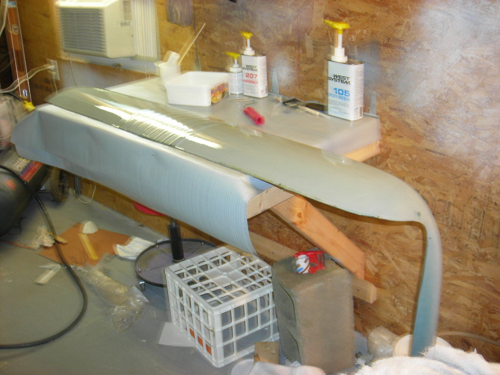

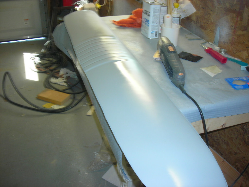

compleatly sanded the visor smooth and added another coat of resin,which will also be sanded smoother before primer and paint,then vinyl underneath.john sorry about the blurry pic,lol.

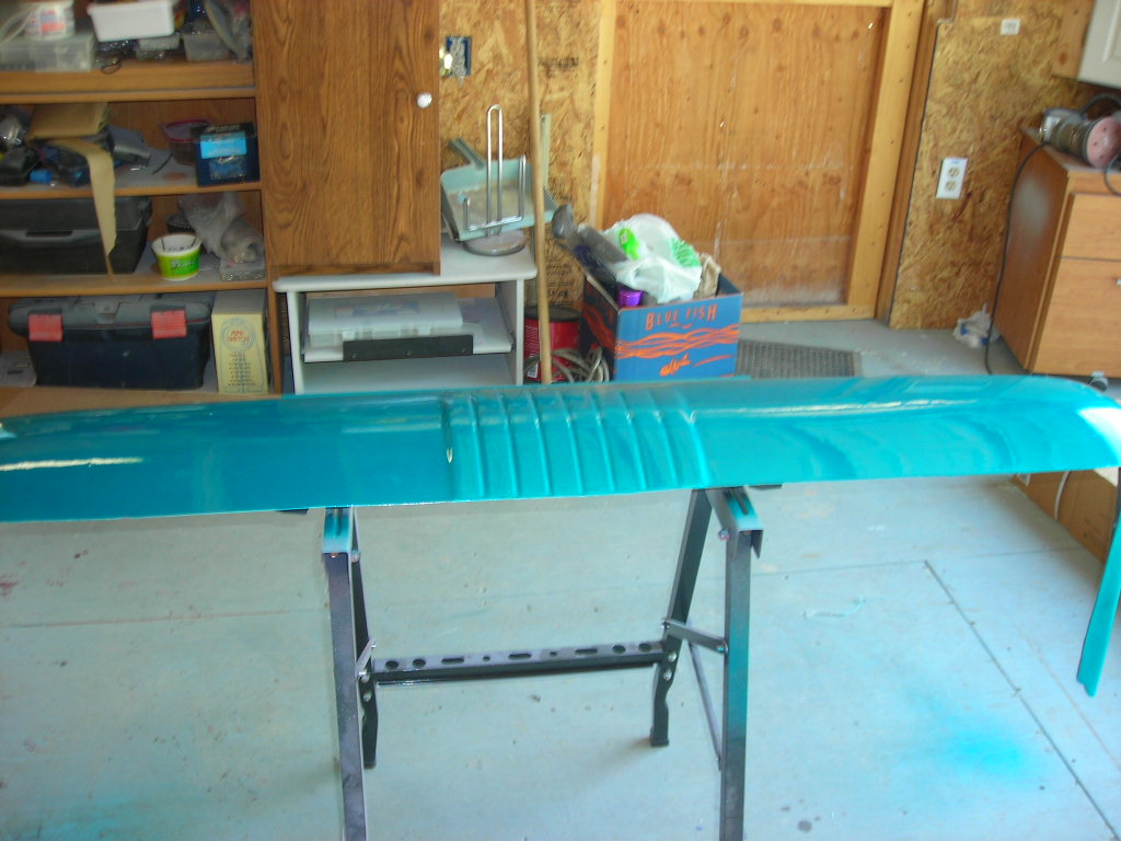

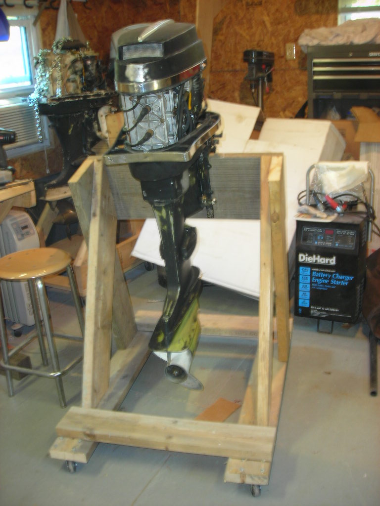

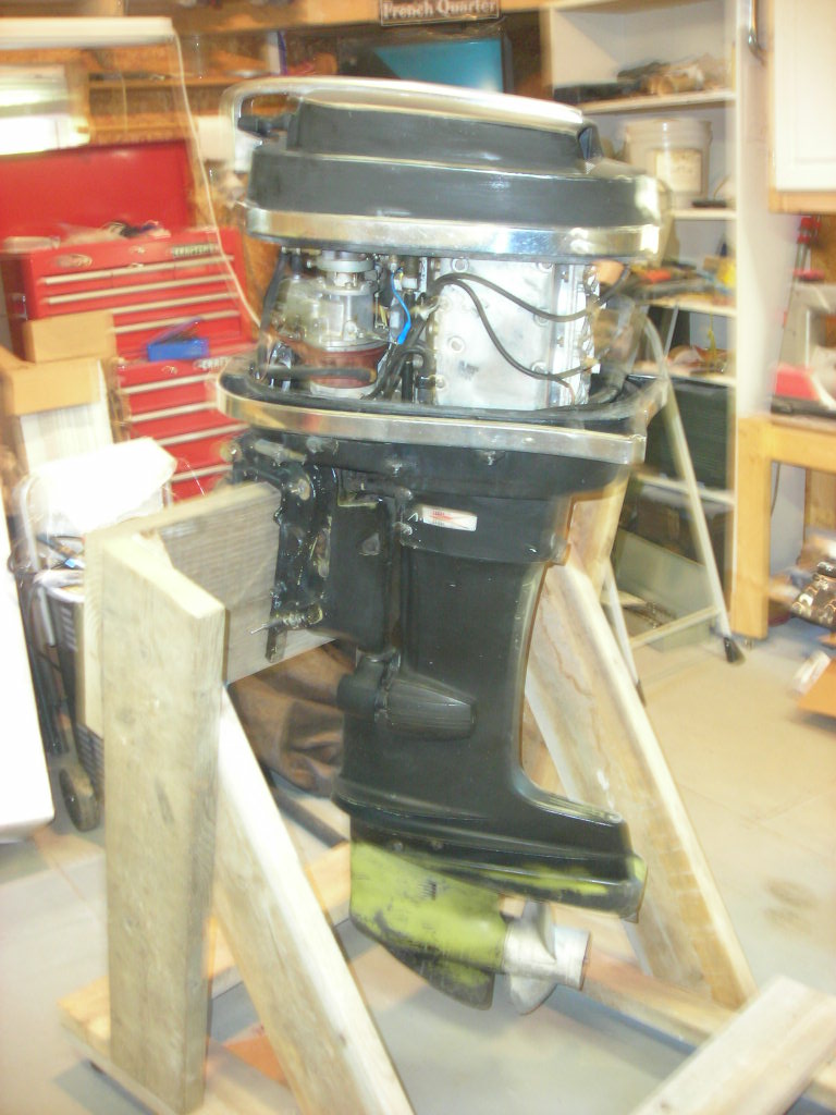

i just finished putting primer on the visor,after alot of sanding to get it dull.i am now waiting for it to dry,then sand the primer and paint it.
next i have to take apart the old 50 hp mercury and finish sanding ,then primer and paint,this is what it looks like now,john

Boy Gibby, you're doing great. Is that motor in motion, or is it the photographer? LOL!

frank,im not sure,lol,i think my camera is screwing up.
thank you frank ,bob and mel,i just painted it with the matching teal ,tommorrow im going to attempt to mask it off and add white to it,i dont know if it will recrack or not,im hoping not.
i almost threw it away it was so bad,now im glad i kept it.i bought a very cheap touch up gun for it at harbor freight,it seems ok,just some minor adjusting.john by the way those things you see are my roof rafters reflecting off the paint.

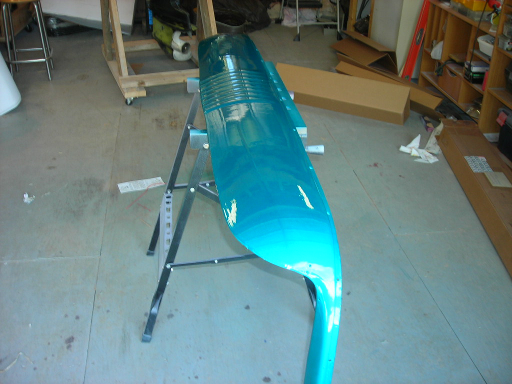

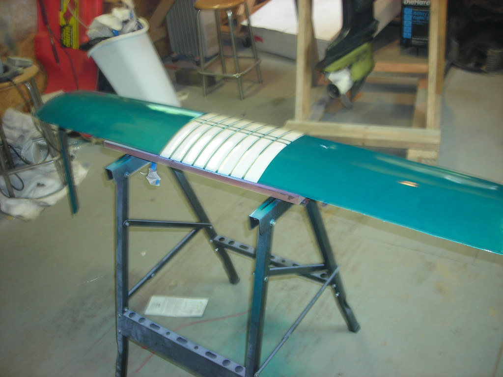

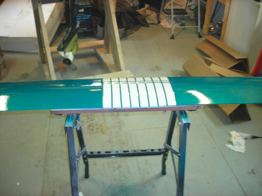

i just finished the stripes on the visor,and also wondered why my pics are coming out blurry,i just looked and i had it set to macro,close up,crap,john just put this pic up to see the color ,and if theres much difference,this is a new batch of paint ,and its enamal,without clearcoat.and i dont have the boat here,its at eds.

Looks very nice John. I like that you didn't just paint that area all white but masked off the teal between the white raised molded portion. BTW I assume the teal color is an automotive paint. What is the application? That color might be a candidate for our Pacific Mariner Stiletto. You really do nice work!!!

thanks mel,i sprayed it with a siphon gun,acrylic enamal,at least on this part,the rest of the boat is basecoat clearcoat.your comments keep me going as well as the comments from the others,thanks,john
