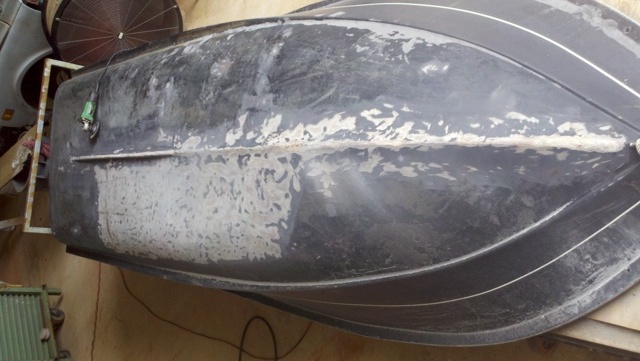

Well I've put off the next stage of my budget project. I bought this shell for $50 with the idea to just patch the bottom and make it float. just the minimum to get it on the reservoir with a trolling motor. but once i started sanding i couldn't stop..:) now all the primary bottom is scuffed and i am considering putting a fabric epoxy skin over the entire bottom.... gel coat and all...
I got the cloth free and have left over poxy.
In the area that is sanded through the gel coat, the original skin has come loose from the wet wood. i thought about attaching my vacuum to a one inch hole in the hull for a day to try to draw out as much moisture as I can then patch and add new skin. It might take years to dry out completely if i waited on that to skin it... i guess..?
Over all the boat seems quite solid (rock solid transom) and mostly original except the PO cut out the front deck..!!! original interior white with black splash finish with few blemish's.... no hardware or seats..
Sort of worth the effort just to make it a floater... but not sure if i would be committing some heinous crime if i do this..
it is a 1961 Norris craft. I know there is no single solution to this.. but drop some comments if you feel like it..:)

Its your boat - do what ever you wish. I will caution you against spending money and time on this hull though. Because the front deck was cut out, the boat is of no value to any collector. It likely isn't even safe to use, because the front deck gave the boat a lot of structural stability that it no longer has. Take a little time & look around for a more worthy project - they are everywhere once you start looking. If you need practice on your fiberglassing skills, this might be a good project. Other than that, I encourage you to look for a better prospect. They can often be had for free or very little money - less than it will take to fix the one you have.

thanks for the insight Bruce... just what i am in need of.. hmmm compromised hull integrity without a deck... that would not be a good thing.. might have to reconsider..:)

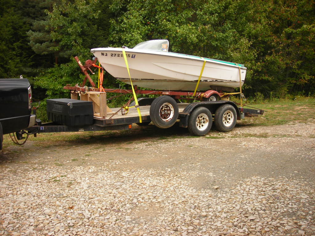

suttree,i have to agree with bruce,you have lost some of the boats streangth,its a shame really it looked like a nice boat,i bought a trailer that still has a boat on it that is cut like that one but someone put in a fishing deck on it,im probably going to end up giving the guy the 50 bucks for the boat and junking it.

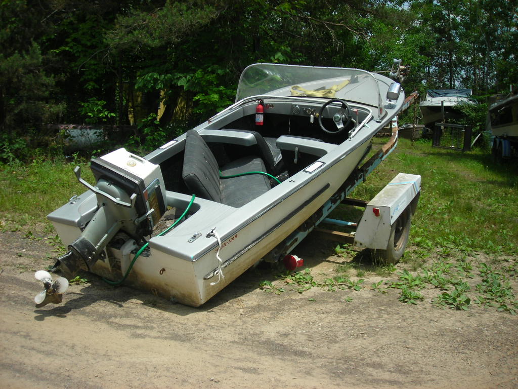

Now my 58 MFG once had a 44 inch mahogany deck on it up front. It is plenty strong without it. But It is a very solid built boat everywhere else. It also came new as a utility type boat without a deck. If it does not seem strong I would not put to much into it. I can't see the boat and I'm not there. That Larson John is a pretty solid hull and with that deck it should be strong enough. If you just want a fishing boat it will do the deed.I know I could not venture in 6 inch deep water with it. I would be sitting on the sandbar. Does the hull flex if you push on the front. I seen a few boats that did without their deck. You can pick some of these boats up for just a few bucks.
Re:Decision time 15 years 2 months ago #35926
yeah the larson is a very strong boat,i got the trailer a little dude,now i need to get rid of the boat.but your right it is heavy,the boat i just picked up for the motor is the one for shallow areas,john

I work at an Airline company that does a great deal of big composite work and have been there for years. i am actually a machinist. i think i feel comfortable enough to say that i am able to see the strength of this hull and it seems to be very stout. when i bought it we rolled it over a time or two and there was zero flex. while working on the bottom, i have been sitting all over the hull... zero flex.. i think i could jump up and down on this thing and have little to no flex.. i wish i had an interior pic to show the bench's and front V buildup..
The missing deck issue may be more of a sticking point for ya'll because of the "collector harm" that has been done... while i don't like it either, it's not a killer for me.. as long as it will be generally safe... i have considered a heart pine deck. i have a stack of 100 year old HP siding ready for the planer.
i hate the thought of squandering time and materials though.. just to make something float..
the curves of this hull also were part of the reason it hooked me.. i'm also no great fisherman.. just like was mentioned... just want to putt around in something other than the typical john boat and maybe wet a line while there..

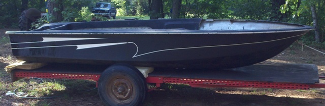

Suttree, I'm going to take a little different tack that the rest of the crowd. That is a sweet looking boat with some cool graphics. The cut out deck makes it useless as a restoration, but I would look at putting a deck back on it and pimp the thing up. It could be a great ride. Not every 57 Chevy is a Barrett-Jackson ready restoration, but there are some great street rods out there. Start looking at hot rod designs from the late 50s to mid 60s and get some ideas. Then plan on the restoration for the next boat, if you want.Good Luck.

thanks for the input Tudor... your ideas pretty closley match mine... although at this point, im not quite ready to go custom... but i still very much have the view that all boats don't need to be returned to their original glory.. a little creativity and originality works fine for me.. as long as i'm not damaging something that has been well preserved..
BTW.. the white graphics are in the gelcoat... when you look from the inside, the graphics show by letting a little light through .. in one little area.. this was new to me..
