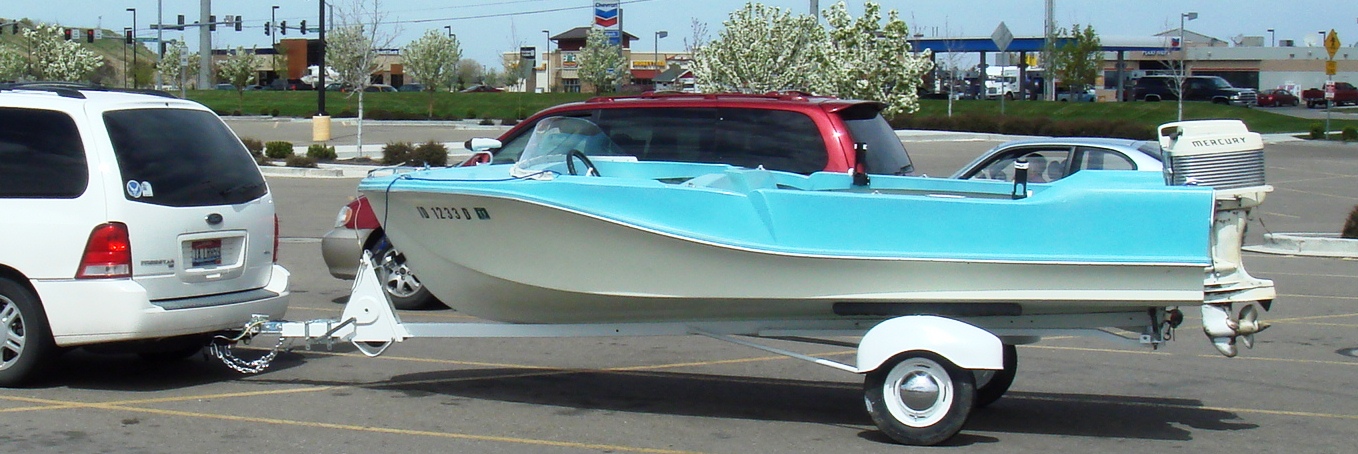

I have always trailered my boats with the outboard locked "UP". The theory was that it would not hit on the ground when going over dips in the road. This required that I had different methods of holding the outboard up and keeping it in place. Some methods worked better than others. I was always concerned that by putting the motor up, I was creating additional stress on the transom.
On my latest boat I am choosing to leave the motor "DOWN". Now I am considering having the boat sit a couple of inches higher on the trailer, or maybe putting a "drag rail" on the back end of the trailer to protect the bottom of the motor when going over dips.
Any thoughts on this? Both pro and con? What method do you use?

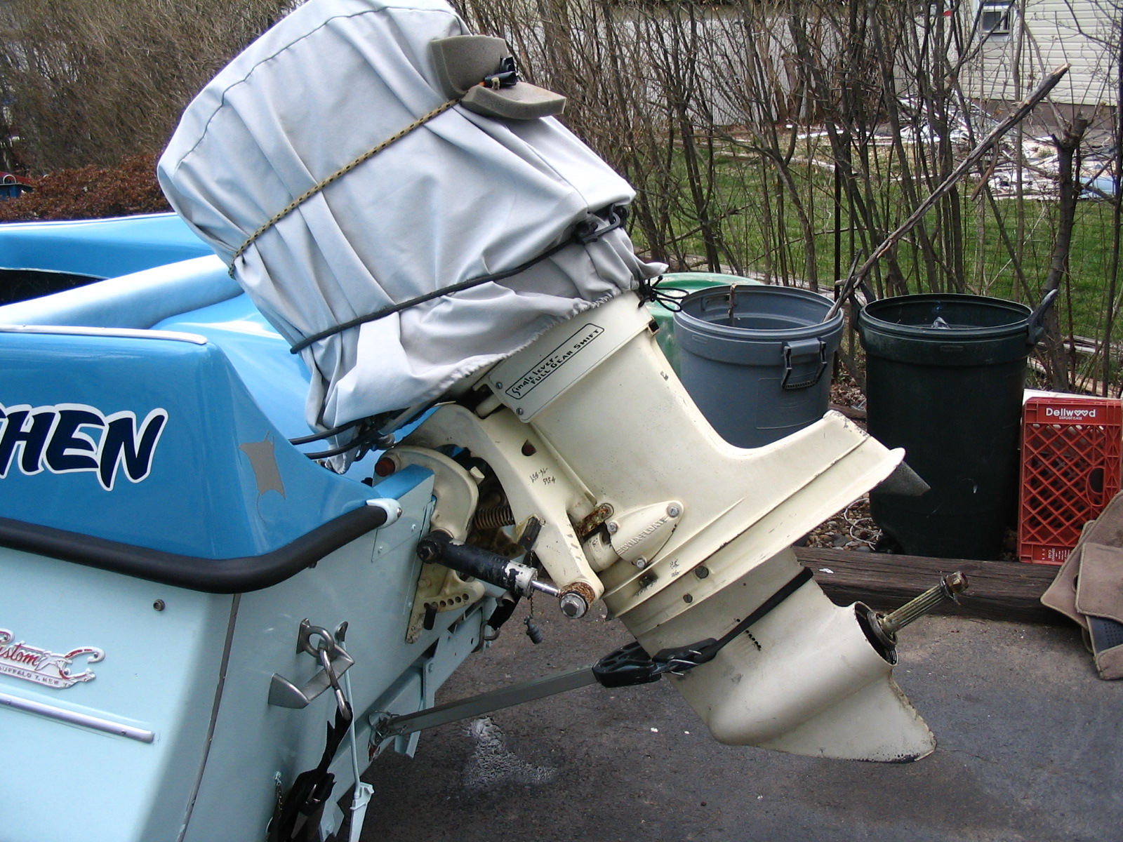

Nice looking rig. It looks like you have quite a bit of clearance under that little Merc now. One option would be a "transom saver" which is a bar(some are spring-loaded) where you prop the motor up a desired high and a rubber crutch holds the leg of the motor and another one hooks onto the back of the trailer or over the last center roller etc.

Lets see if I can explain. The motor is fastened to the transom at the bracket only. Locked up or down, the weight of the motor is bearing on the bracket- now drive on a bumpy road. The mass of the motor is bouncing against that bracket and stressing the transom. Ever drove behind a towed boat and seen how much the motor bounced when a bump was hit? Now add a transom saver. Now the motor is prevented from bouncing due to an additional anchor point. Much more secure, much less stress on the transom AND motor.

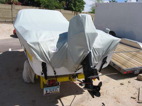

Up. Locked and supported. Wheel straight. Prop covered if you can.
I have seen props with dings and even pieces missing from flying debris. It just makes sense to protect boat/transom/motor/prop while transporting.

Always up with a transom saver and a trailering cover.

I haven't used a transom saver, but it looks like a good idea. I Googled it and there seem to be two types, one which supports the load on the boat and another on the trailer. Any thoughts on which is best? Any issues using these on vintage trailers? Any good designs that would work with a vintage trailer?

Todd, I personally think the ones that brace against the trailer or keel roller are preferable, it takes more stress off the transom.
The issue with a lot of vintage trailers is the lack of a cross brace at or keel roller at the very back. (ie;Holsclaw, probably others too). You may have to fabricate a brace/bracket/whatever to mount the "saver" to down there, but well worth the effort, IMO.

I have a '59 Thompson Sea Lancer and one of the first things I did was buy a transom saver. I think the weight of the motor bouncing and twisting on the transom is harder on the boat than the torque of the motor being used. The bar keeps the motor from bouncing and transfers some of the weight to the trailer. There is also the possibility of breaking your tilt lock with the motor bouncing when you hit bumps in the road. Just MHO.
