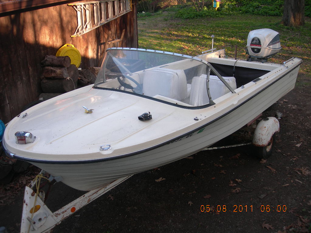

I am looking at a 1969 Seaking/Starcraft. It appears to be a clean, solid little boat. But my concern is an area of glass cut out at the stern to expose the decking. You can see the area of concern in the bottom of the first pic...the are under the gas tank. How can I verify that the stringers and transom are solid? Let me know what you experts think. This would be my first glasser. Thanks in advance.

welcome bunker,boy its very hard to see with that pic ,but i "think",that whoever repaced the floor didnt take it all the way back,thinking it would be better for drainage,and the wood in the floor woudnt be sitting with water on top of it,at least im "thinking"it was replaced ,make sure the wood is glassed well if you can feel it by sticking your fingers under the floor ,between it and the hull.
and im not sure if the stringers went all the way back, they probably did,but lke i said i cant really see anything in the pics.so i am probably way off base,lol,lol,john

I can not tell anything from that photo. You need to take a better photo. How do you know it was cut verses the way the boat was made? Also walk around the floor does it feel solid? If it does not feel solid you have a problem if it feels solid it is. The boat looks clean maybe it was cared for the way it was supposed to be. Next and last grab the motor. Can you flex the transom? try and stand on the cavitation plate of the lower unit. If the transom bows and flexes it is shot and needs replacement. Tap the transom with a plastic head mallet (gently) and listen for a change in the tone as you tap. Bright sharp tones should indicate good lamination of the glass and wood dull tones will reflect rotten spots.
Other than buying a moisture meter for about $300 to $400 that is about the best way to tell. Also look for any obvious signs of de-lamination of the fiber glass and wood.
Don't over think it. Just get in it walk around it and see the the transom flexes.
Jim

Thanks fellas. I walked around in the boat and it felt solid. I also tugged on the outboard and it didn't seem to move much. I just don't want to get into something over my head for a first boat. Everything appears ok, I just wanted to get some advice before jumping into a boat.
I am going to take a closer look tomorrow. If I can't find anything obvious...I might just take her home.
Can anyone ballpark a value on this boat?
