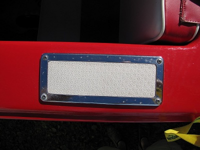

I made my own for the Tomahawk. Bought the thin sticky-back pads at Defender. Cut one piece the full size of the frame and another the size of the opening then stuck them together. Not totally authentic, but so far so good.
