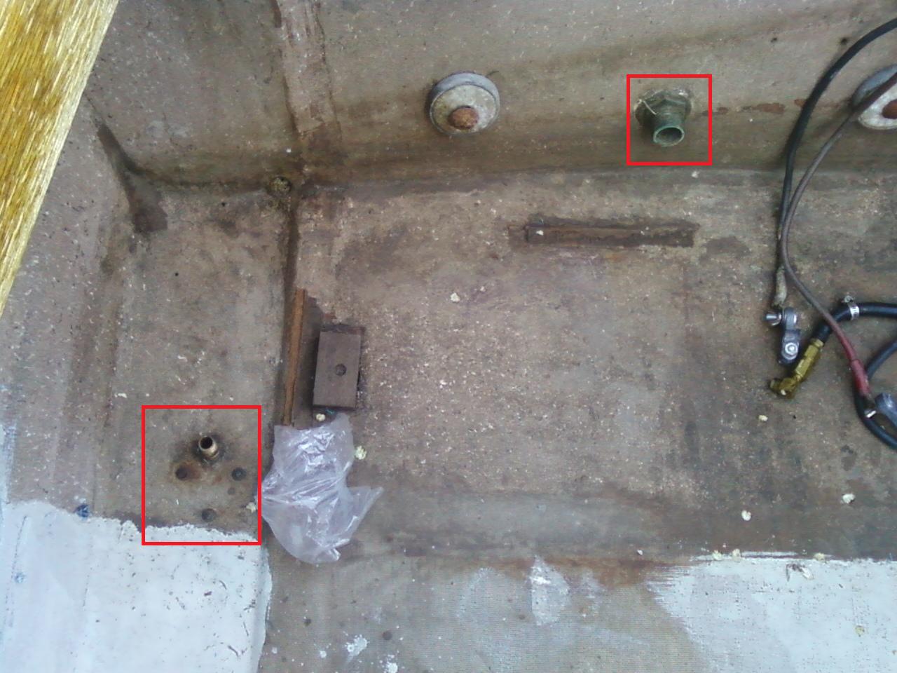

I just recently accuried a glasspar delmar i was told it was a '56. i know the motor is to large for it as it is an 85hp.. but she seems to run like a top and i was currious if anyone happened to have cabin/ interior pictures of this model.. The hull seems to be in great shape,buffed out the the gelcoat on it.. interior seems to be a bit aged but from what i can tell its mostly complete.. the wood is in pretty dang good shape for its age only needs a good sanding and a fresh coat of varnish,It has a wood seat with tackle drawers and a bench lid with a swordfish punched out in the center was this original or added? Also could anyone tell me if the motor mount setup is original or added ( I know that the plywood mount is not original)but is the small rear deck? Also there is a water pickup in the starboard floor and what looks to be about a 1 1/2 in outlet in the transom
about 6" up from the floor any ideas what these would be for??

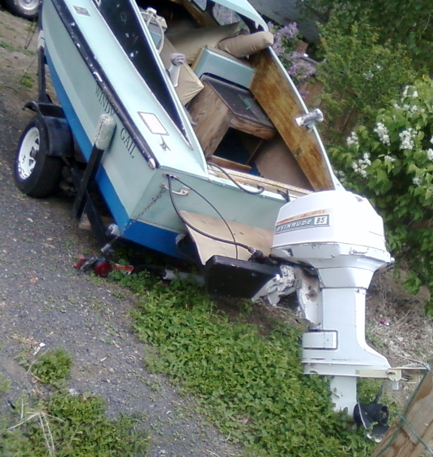

shot of rear of boat i will get some better shots of the rear deck and transom up soon

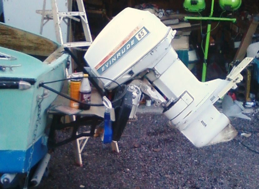

another shot

Welcome Damen .. Ive got a Delmar Im restoring . Search for Operation Delmar and its got plenty of pics of mine being restored ..First your transom has been modified .Its suppose to be curved in back .85 is a bit much for that boat .Yours has that step back on it to like a jack plate .I think some people put them that way to give more room inside .Ive seen 2 others set up that way . Its rated at 50 .I havnt driven mine but have been told they get squirely if you push them to fast .The pad they ride on in the back is curved and I can see that making them want to walk around at speed . Im gonna run a 50 hp mercury on mine .Interior wise I dont know . Im thinking they must have been open in the back and people made them what ever they wanted .I havnt seen 2 pics alike . Yours sure has Great potential ..

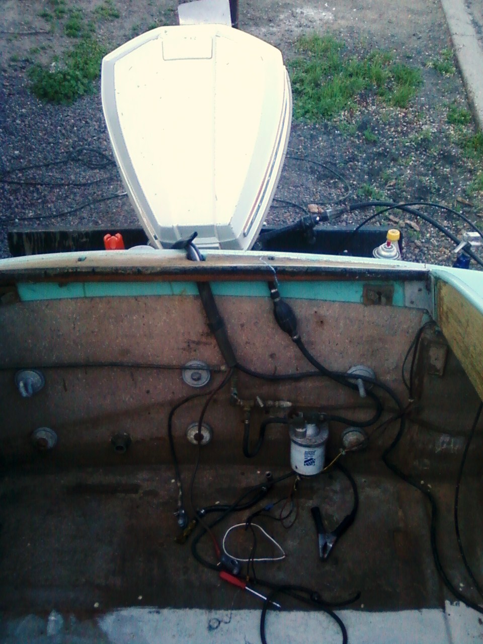

I would guess that your water pick up tube and outlet ftg. were for a live well.They would use a pump to bring the water in as water will only seek its own level,which would be the water line.It was set up for fishing and they put the outboard "bracket" on to free up the stern area.

..C.: WELCOME, NICE MODEL . We have a LIBARY section here on the site, up top tool bar, & go to GLASSPAR, brochures for 56 - 58 have some DelMAr www.fiberglassics.com/library/File:Glassparb58005.jpg Sort of known as a Day cruiser, with a open bulkhead or dah partition. Could have sliding or fold down partitions for night / rain sleeping. Should have maybe two side bed partitions. That 85 HP to big & too much set back. Use on another skiff or sell to fisherman. Two cyl 50HP or 60 Hp mid 80's be a good rig. One of the early members Brian Fenwick Az/ Ca had mint light Green one that won big award & sold maybe over $ 10 K..! COMMANDER from N.W. redid a few in two tone & wood floors, that were stunning. We love Glasspars & they have a good following. . ENJOY

I was kinda thinking the pickups were for a live well but was not sure... I am defently going to replace the 85hp with a newer 50hp model. going to run her easy this season, but the going to get the right equipment on her for next year i have a few more pics enjoy..

Re:new boat owner need help... 15 years 2 months ago #35409
another

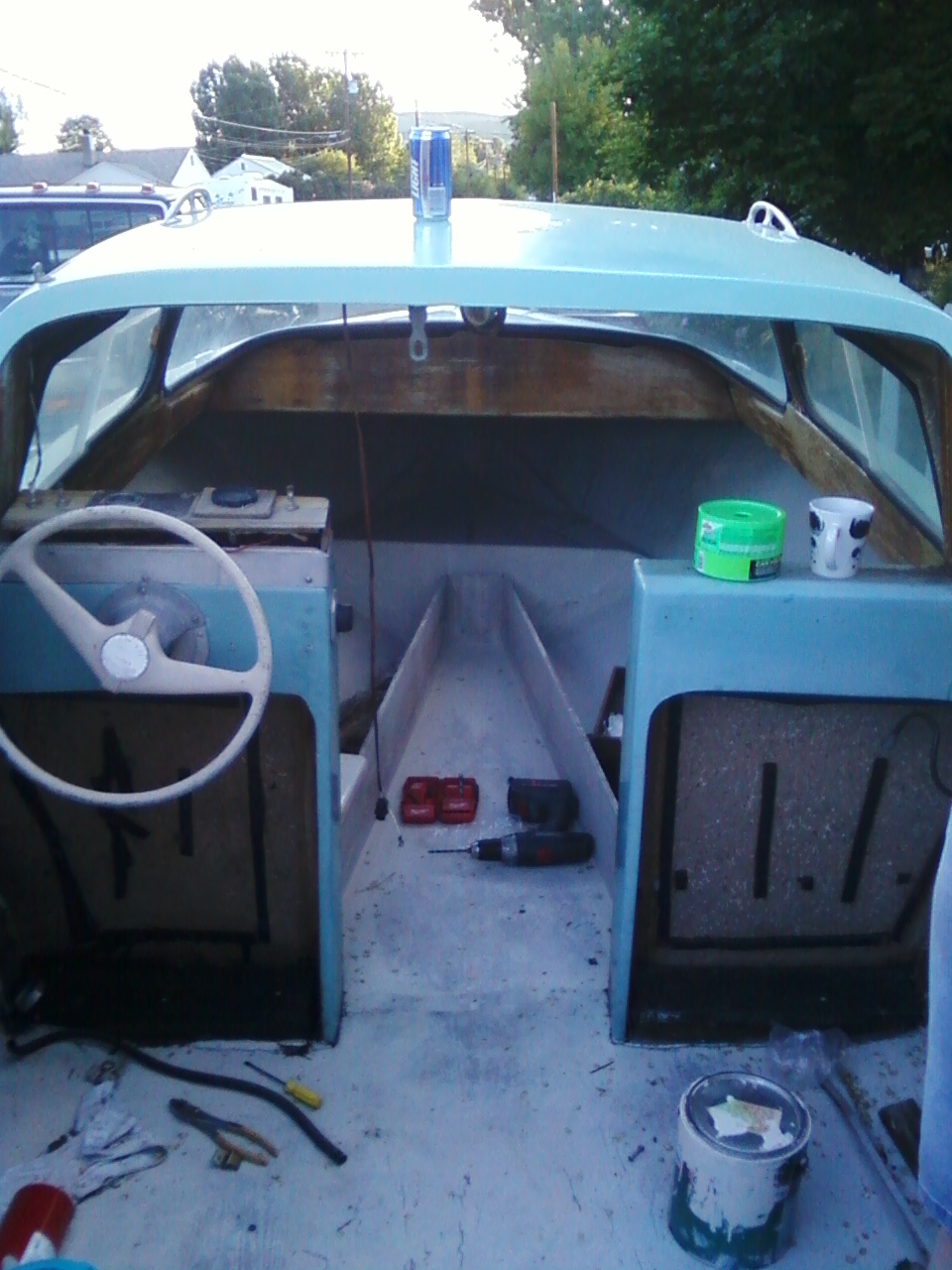

Re:new boat owner need help... 15 years 2 months ago #35410
heres one more..

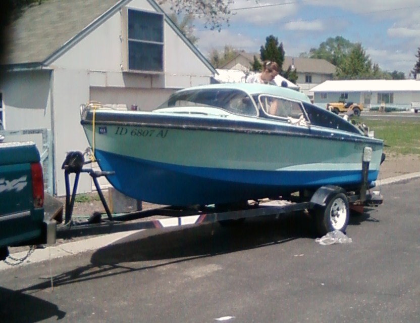

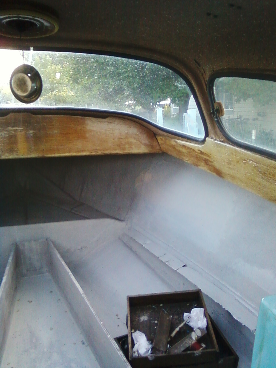

Re:new boat owner need help... 15 years 2 months ago #35411
and heres a shot of the cabin minus the interior padding.. still has a built in potty thing... lol (think thats coming out and getting put away..

If you have a woman in your life... DON'T get rid of the "built in potty thing"...heh. A small thing that will make her many times happier with the boat... hence you will get more time in it. ;)
