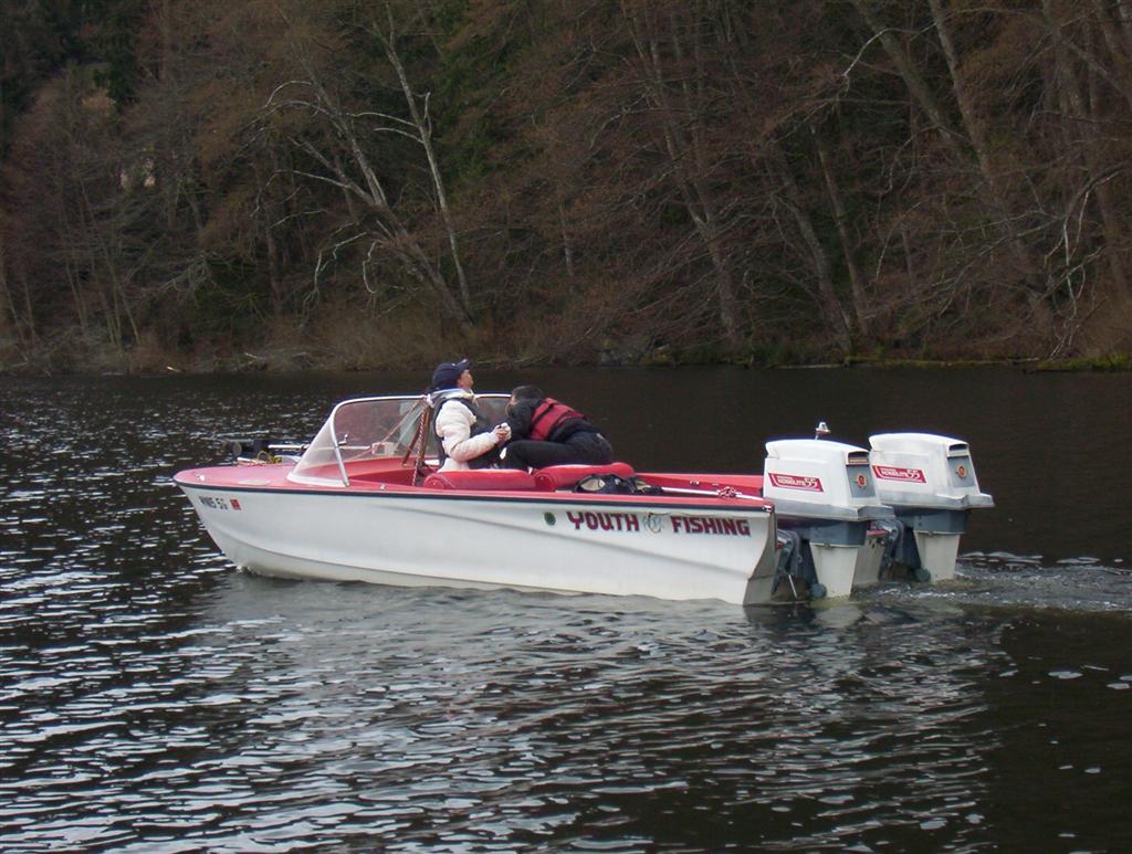

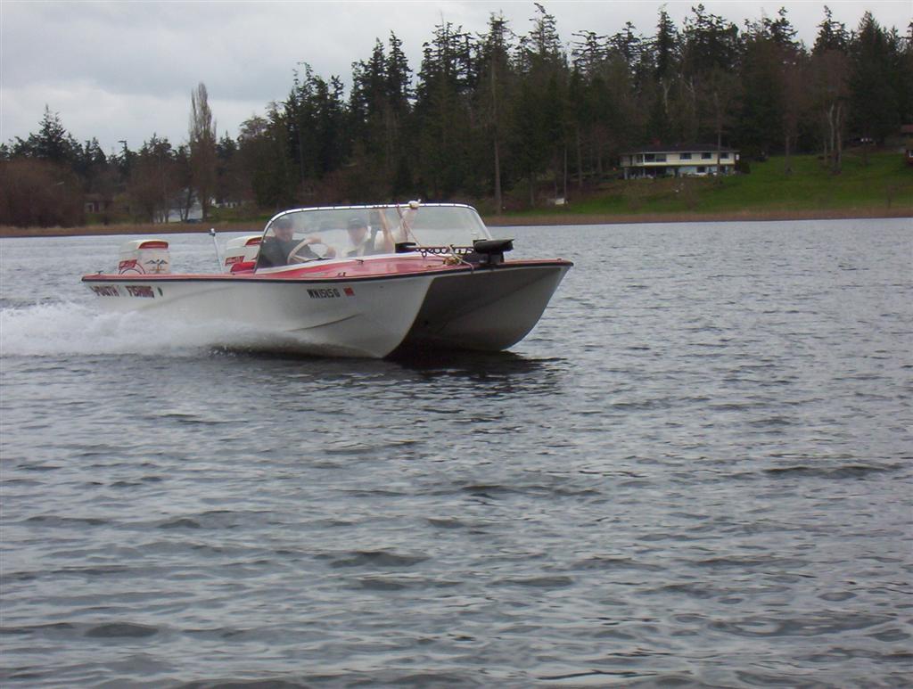

Power Cat 18 DC is in the water and running like a top. Both 62 Larks fire right off. Had to replace a freeze plug on stbd side, and once I did that the motor runs beautifully. The 4 blade props make a big difference. Lowered the pin position 1 slot. Both motors winding out nicely. Man what a smooth ride. Amazing how an 8' wide tunnel hull rides. Later guys. Doing this from my BlackBerry and can barely see the print.

Yes, the ride is soooo nice.
You have less weight out back than I did running the twin Bearcats.
I liked running mine at 20-24mph and she was nice n quiet at that speed.

Looks mean from the back. I'll race ya with my 8 hp Honda. HA Ha
