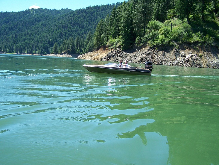

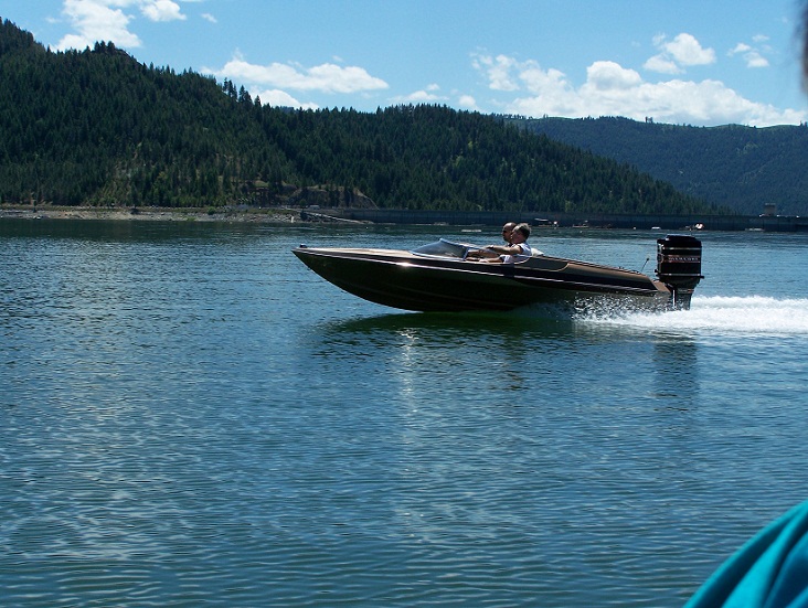

She goes pretty good.

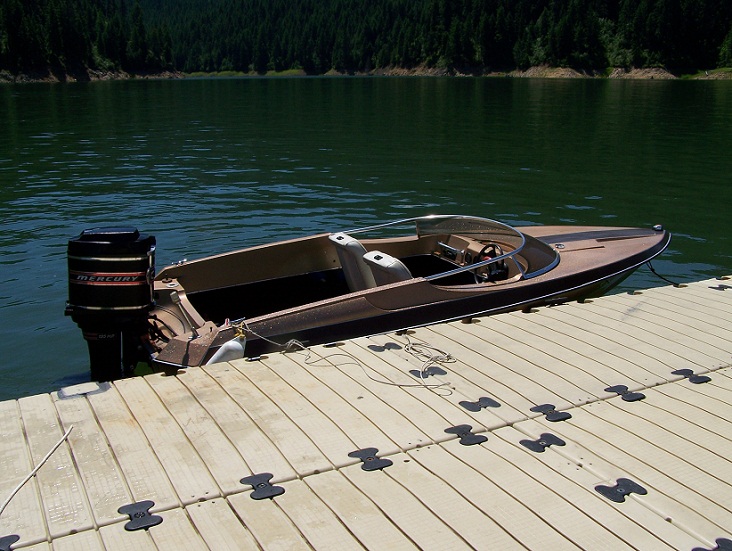

Larry The tag says Sunset Boat Co. Silverton, Ore. Model-Chetah
someone posted here saying a Sidewinder clone. All I know is the whole package was $200.
I ran in the second to last hole for tilt, turning a Solas 21 pitch aluminum 3 blade, 5000 on the tach, 64 GPS. I also had in the boat an extra battery and a electric trolling motor. My buddy with me weighs in around 195 and I had 12 gallons of gas.
If I shed some weight and spin a 21 stainless maybe I could get to 70. It is a pretty light little boat so I gotta watch out, if I sunk the boat, oh well, but if I lost a 1350 Tower in 275 feet of lake, well that would be NOT good at all.
