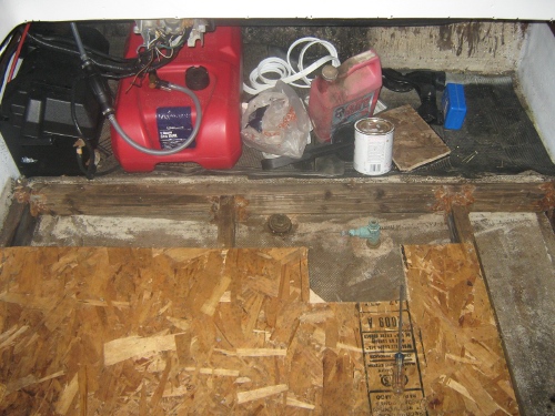

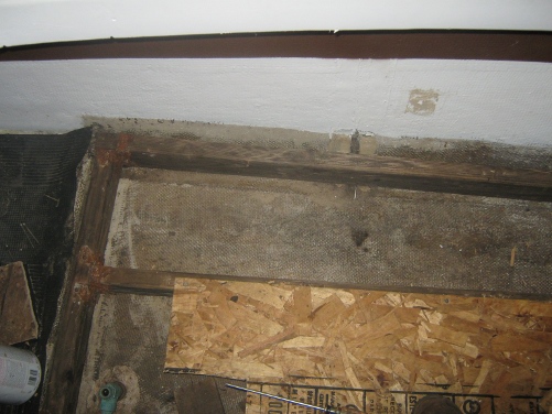

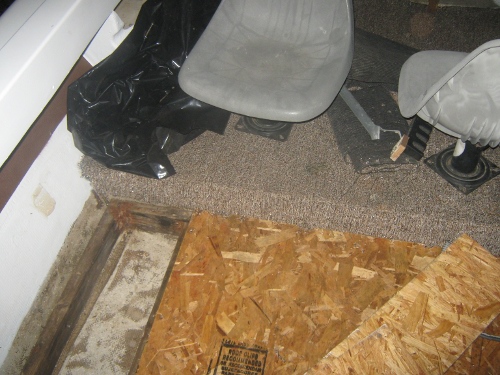

I have a 1968 Nylox, and I just removed pieces of the floor the previous owner replaced (poorly) and found the hull has no stringers fiber glassed into it. There is a frame which is similar to wall to a house that basically makes contact along the sides of the hull and is raised in the center, although only a little as the back half of the boat is pretty flat.
There is a fiberglassed raised area under the splashwell, a raised area where the drivers and passenger side seat would go, and a raised area under the bow.
Is the way the floor done correct (the framing anyway)? Did the boat not have a floor from the factory and was added?
Any help would be great!

Floor frame side.

Floor frame front

I am not familiar with your hull.Having said that I would probably epoxy/resin/glass the existing "stringer system" in place.It does look like it adds strength to the hull,if attached,which is a good thing.I would not use particle board for anything on a boat.Exterior plywood with a liberal coating of resin would be my choice.Or marine plywood if I was flush with cash.Hopefully someone will chime in on your question about the stock stringers.

I'm not quite sure what you are asking. I have included a picture of your sub-structure showing your stringers and bulkhead. You should NOT use the Chip Board shown in the pic for your deck or for that matter ANYWHERE in your boat. Ext. Grade Plywood or Marine grade only. All stringers and Bulkheads should be coated with resin, covered with a minimum of 2 layers of CSM and I layer of either 17 oz woven Roving or 1708 Biaxial cloth and tabbed to the hull 4 - 6" on either sided.

The subframe is not fiberglassed in nor is there any evidence of there ever being any. The reason I started pulling up the floor was because of the chipboard and I found the subframe looking different from what I have seen. Is it possible it didn't have a floor originally it was just open? That being said if It never hadstringers fiberglassed should I still or do I need to glass them in?

Well, I can Guarantee you that when it came from the mfg it had stringers that WERE glassed to the hull and a DECK that was also attached to the hull. They are integral to the overall structural integrity of the boat and with out them the hull can and will flex and depending on the amount of this flex could lead to catastrophic failure of the hull and the boat sinking. Thereis NO WAY this hull should be restored WITHOUT restoring the stringer and bulkheads to an acceptable configuration.
