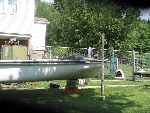

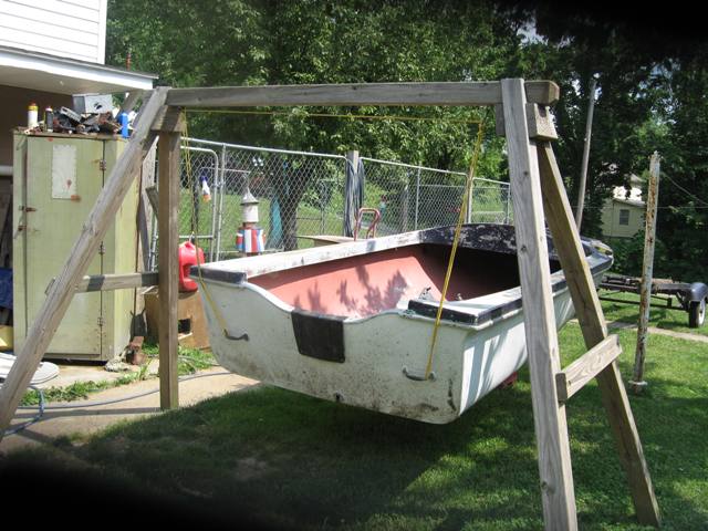

We've talked about it before. Here is how I do mine by myself. My boat is only a 14 but you might be able to employ it on a bigger scale. I lift the back of the boat off the trailer and hang it from an A frame built for a wooden porch swing. I slowly pull the trailer ahead and push the boat back when needed. When the bow is on the last keel roller I put something under the boat for support and drive away. It takes just a few minutes. I'm working on the Tee Nee right now. It will be in the trailer section.

Robert,
Nicely done, I like it.

Great idea. I could use the kids swingset for my boat - if I can weave the trailer back there???

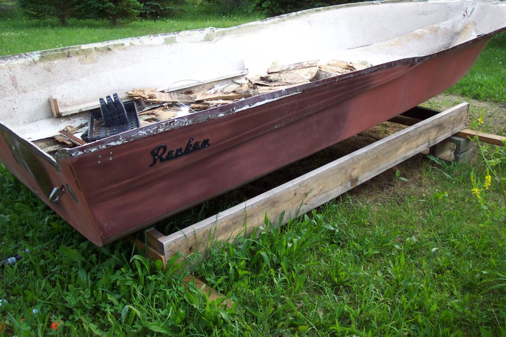

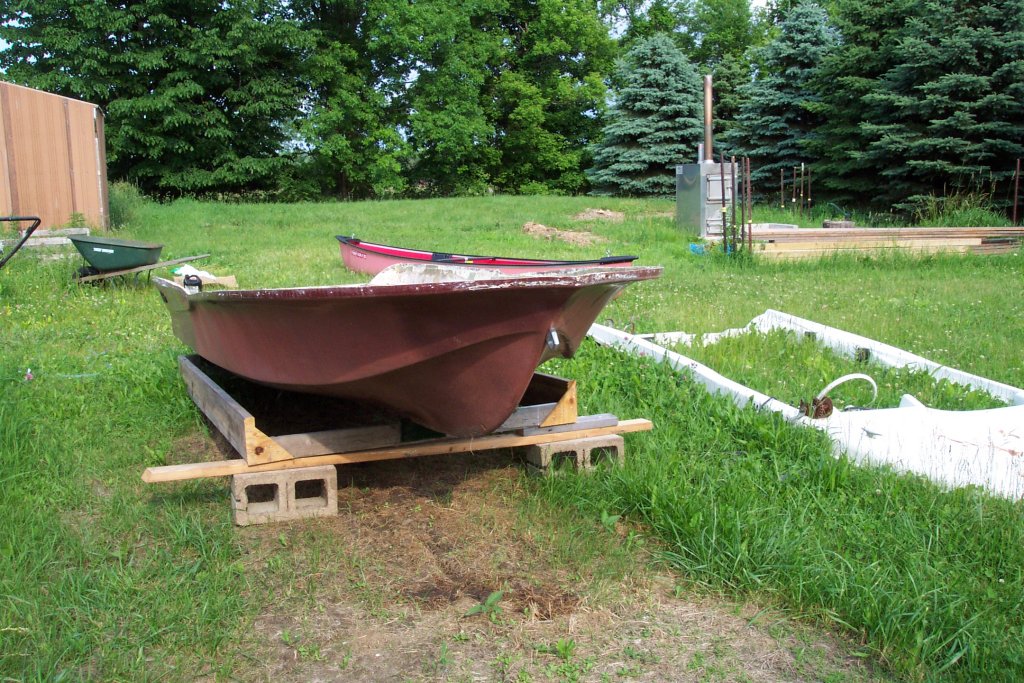

Here's the Rolling cradle I use when the boat's off the trailer. Easy to roll it around when I need to FIND THE SHADE!!!!

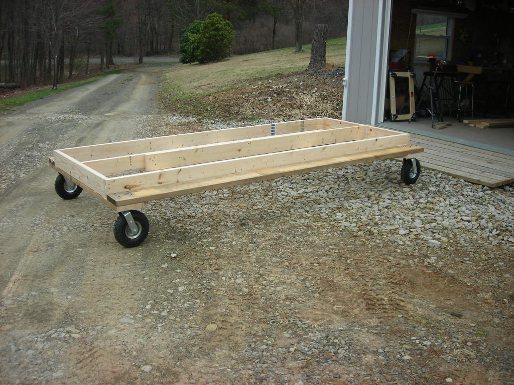

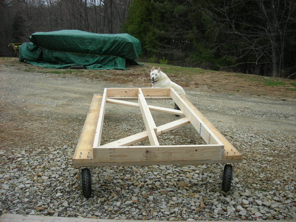

here is the rack i built ,it has 10 inch air filled tires on swivel castors,mostly because my drivway isnt paved.
the way it is i can make a cradle for most run a bouts,its 5 feet wide at its widest point ,4 foot wide on top,and 10 feet long,i used it lately as a table for my compound miter saw when we were building the porch roof/room,i just threw a sheet of osb on it for that, now i will take that off,so i can configure it any way i need too.john
