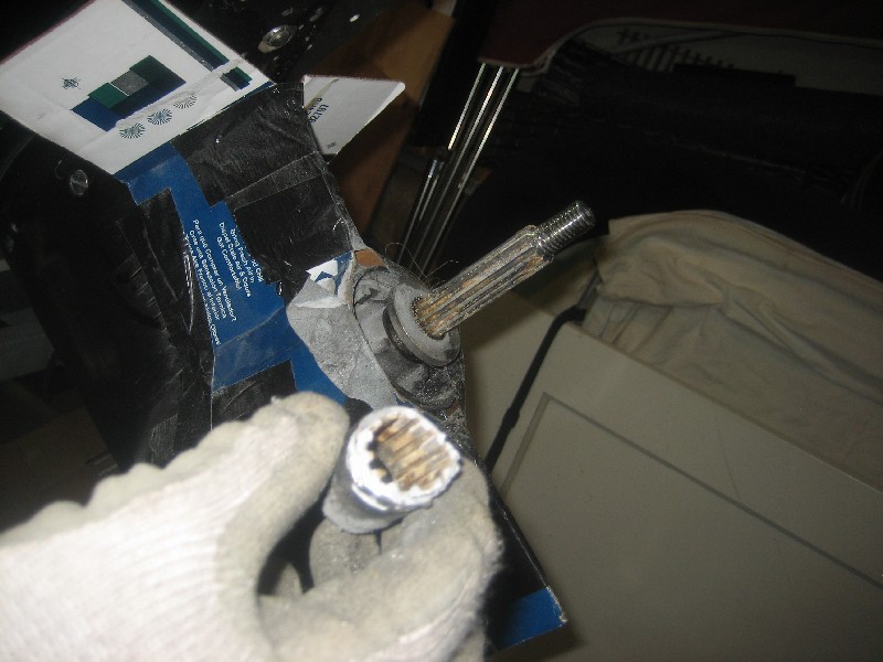

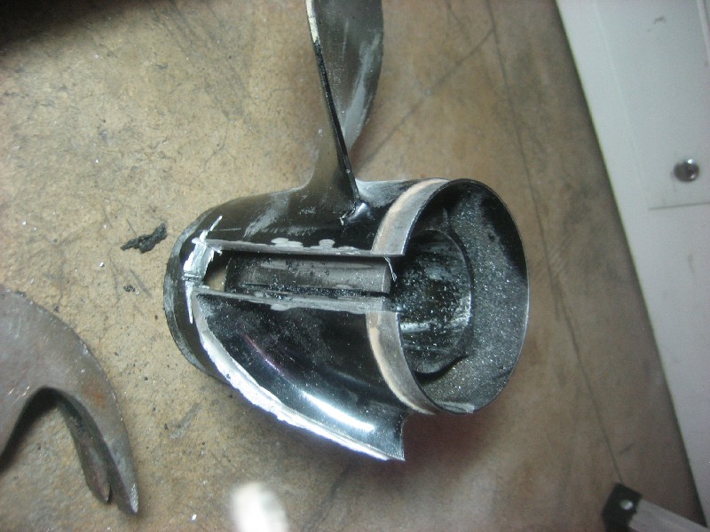

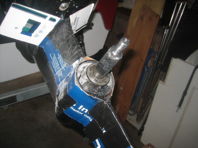

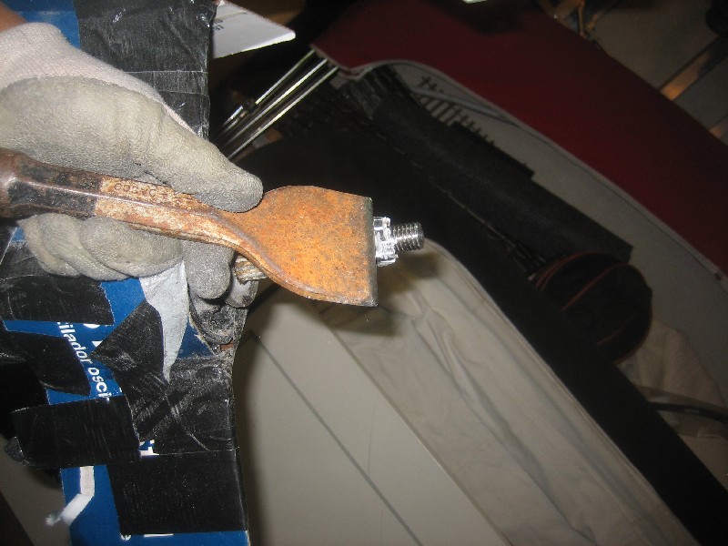

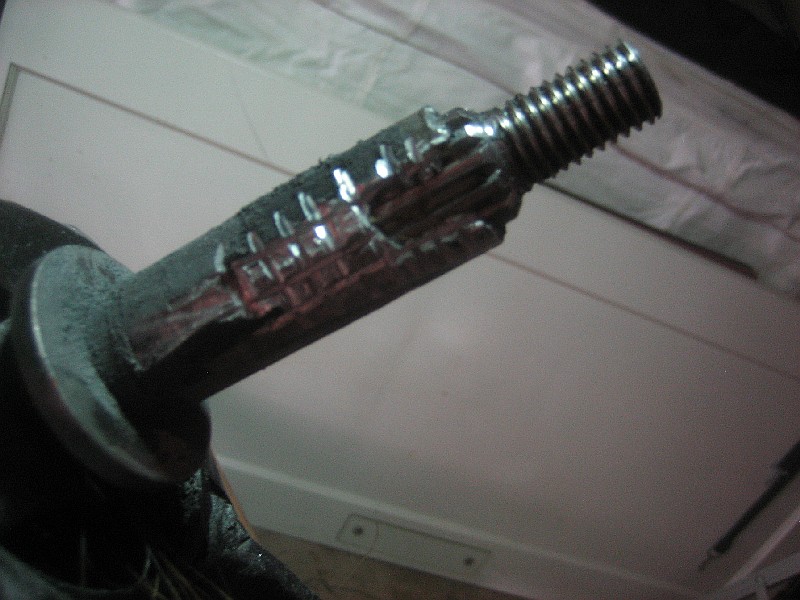

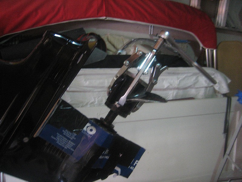

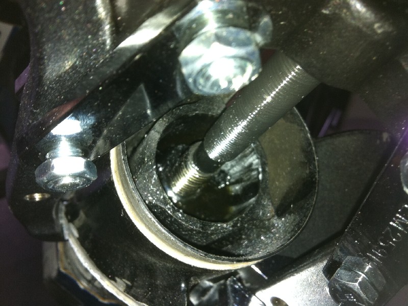

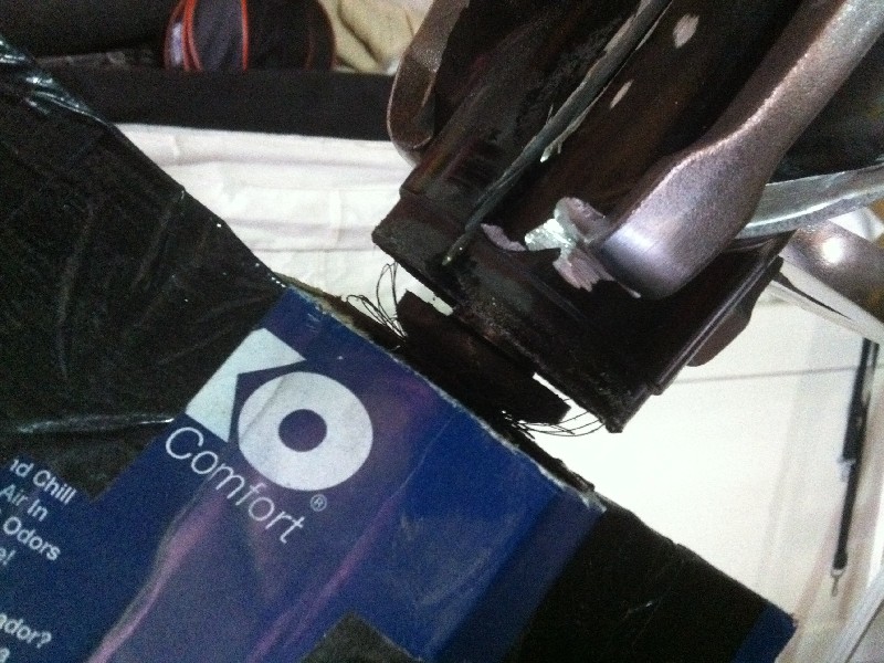

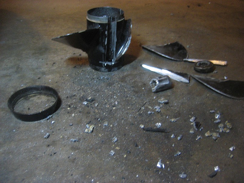

...after several hours. Last weekend, decided to go at it. It was very frustrating at times and my patience was definitley tested. Spun prop was the reason why I wanted to removed this prop in the first place. I was wandering if it was actually that after torquing on the extra large puller that I recently bought. That prop whould not budge. I created three notches at the front of the prop blade to accept the puller. The top piece of the internal spline snapped while trying to remove the prop with the puller. That allowed me to drill out as much of the rubber hub and I was able to remove the prop all together. That of course after I had cut away two of the blades and spliced a couple of lines on the prop. Grinding off the blades took the most time. Now that the prop was off, it was time to attack the spline. I couldn't use the puller at this time because of the tapered washer between the spline and the lower unit. With my grinder and metal cutting blade, I cut along the spline making sure not to hit the prop shaft. Then I cut accross the spline creating little squares. I then chipped away one square at a time. 2/3 of chipping away, the spline finally removed. You can see the corrosion. I cleaned and greased the prop shaft and new prop installed. I tested the motor on the water the next morning and as far as the new prop and lower unit, it's working as it should.
If you haven't greased up your prop and prop shaft in a while, do so soon.
