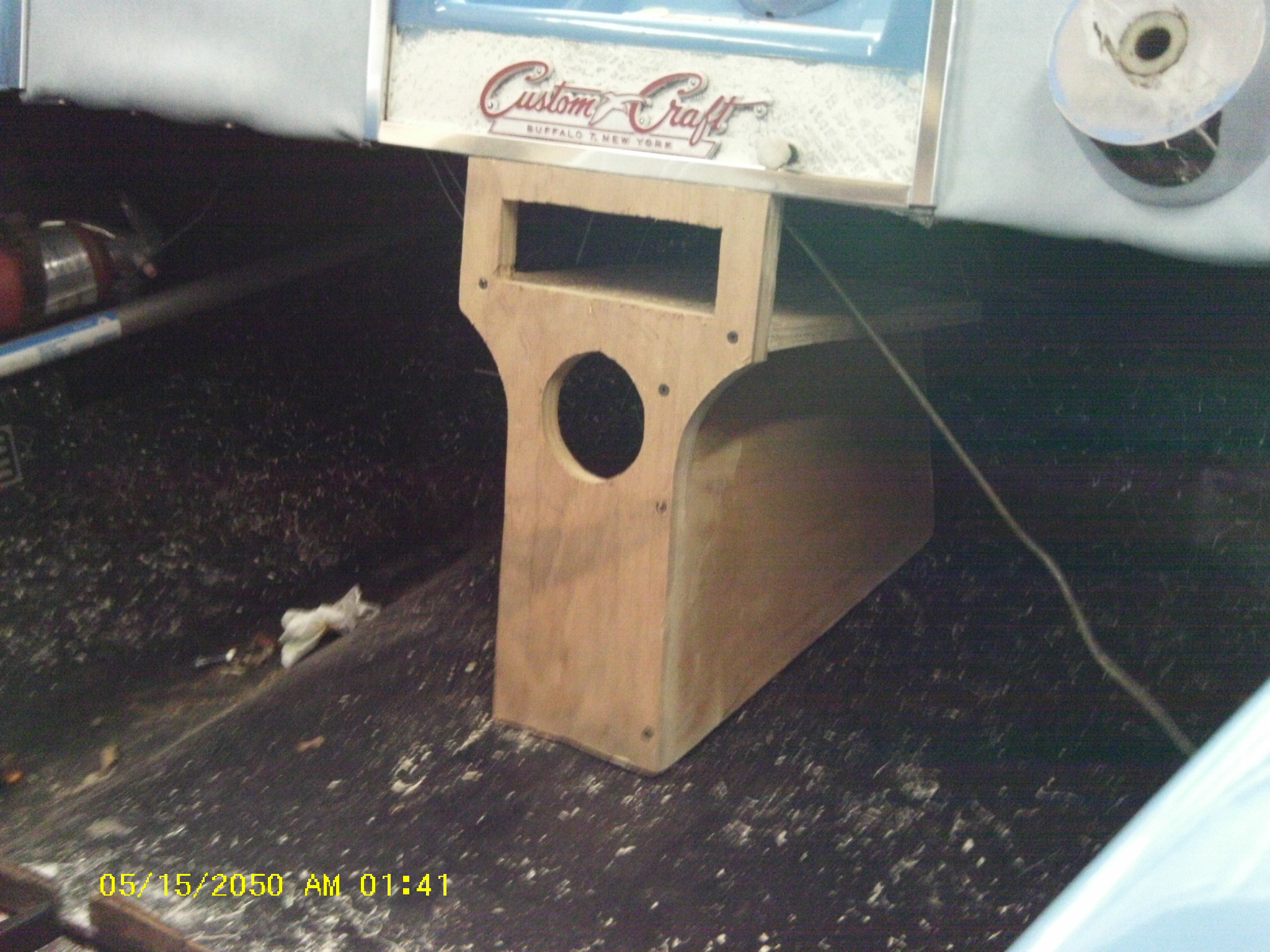

  • Karma: 324

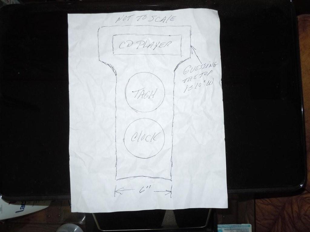

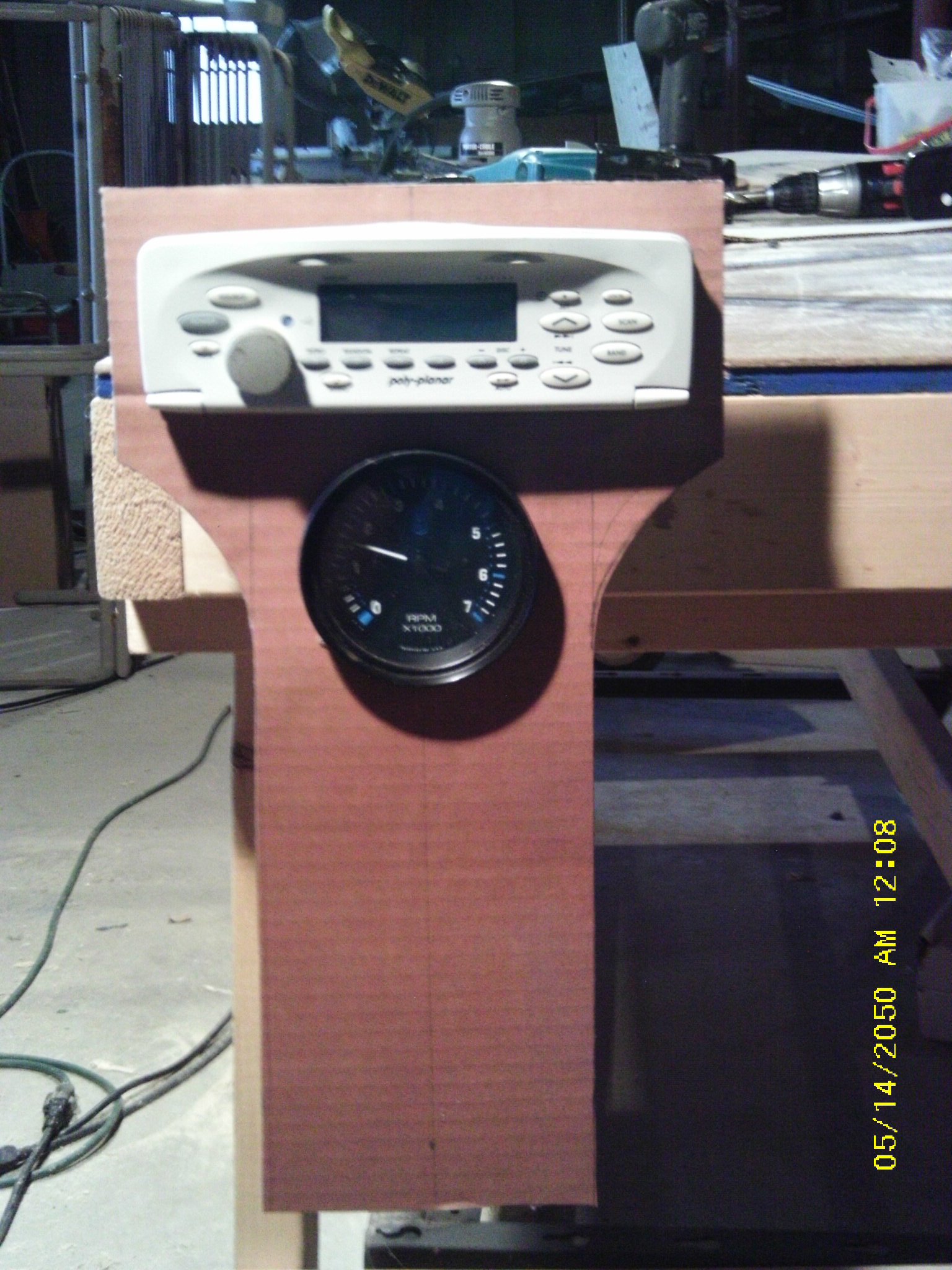

ron i got your drawing ,for the console front,how does this look its close to your drawing and demensions,its taking a little while because im making it out of fiberglass,so i can get the curves in it.this is just the cardbord templet,john this doesnt have a place for a clock since you couldnt get one,john
Re:ron,hows this look 15 years 2 months ago #34219
That's great John! Of course, I can't speak for Ron, but I'm sure Sue will be very happy with a mounted CD player for all those "remember when" tunes Ron so likes to play...
Ron can't get a clock? What's with that? Sue won't let him have one? :laugh:
Keep up the great work there John, it's good to see you playing with boat stuff!
Frank
Re:ron,hows this look 15 years 2 months ago #34224
  • john-gibson
  • Posts: 4014
  • Karma: 324
thanks frank,its great to be working on a boat,im hoping to finish soon and get going on my boat,for hammondsport,but if i dont its no big deal,at least im helping a great guy.
as for the clock he cant find one.
Re:ron,hows this look 15 years 2 months ago #34226
perfect john!
frank...Remember Then..Remember Then...lol i can't find a vintage clock.
Re:ron,hows this look 15 years 2 months ago #34234
John,
That looks like it should work great. Can't wait to see the finished product.
Ron, your a lucky man. ;)

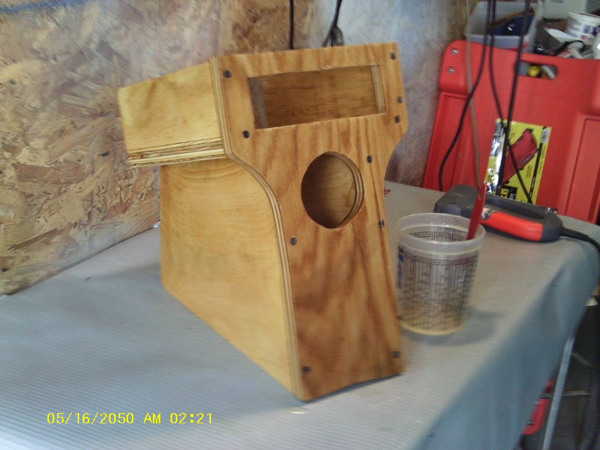

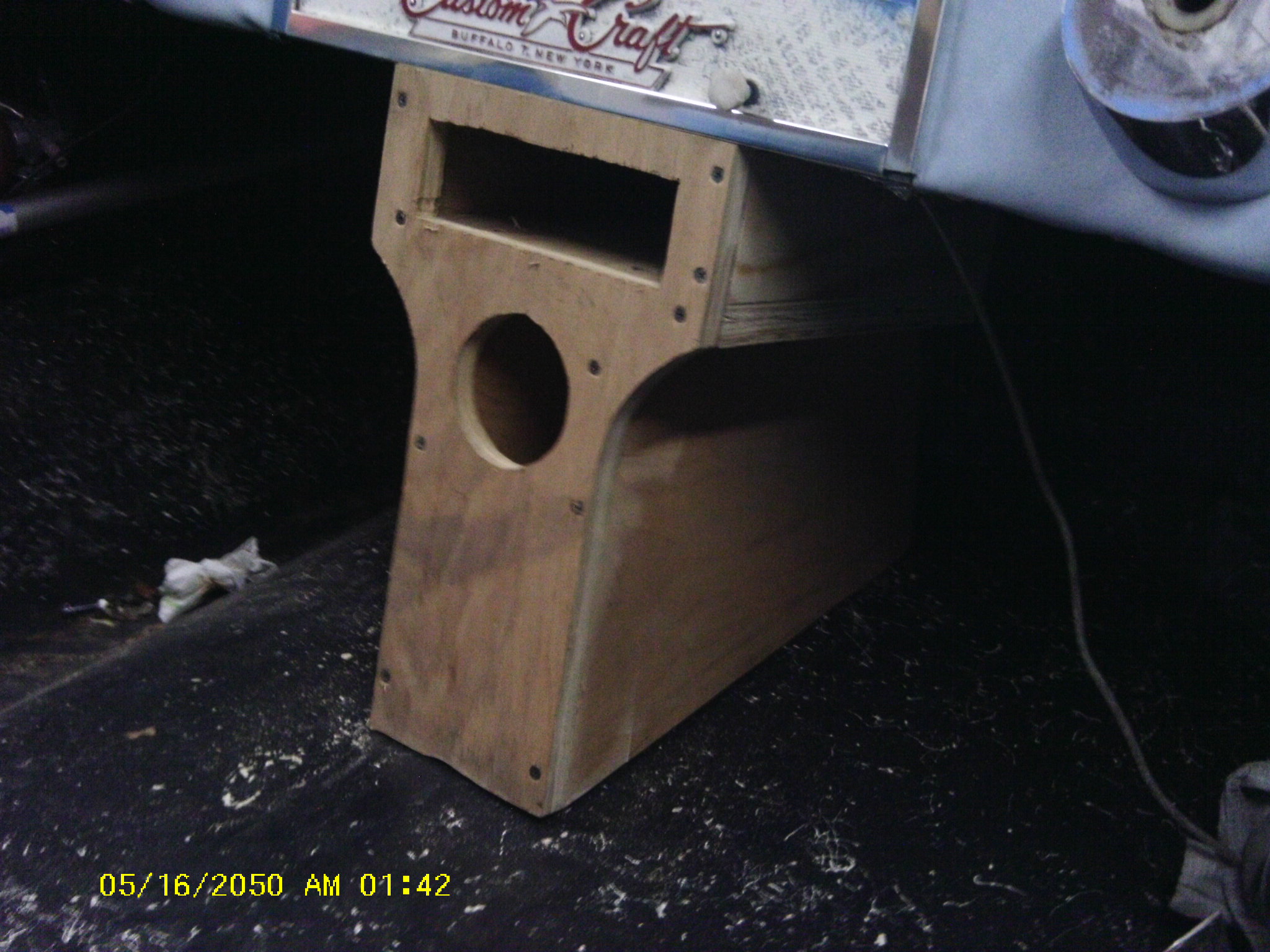

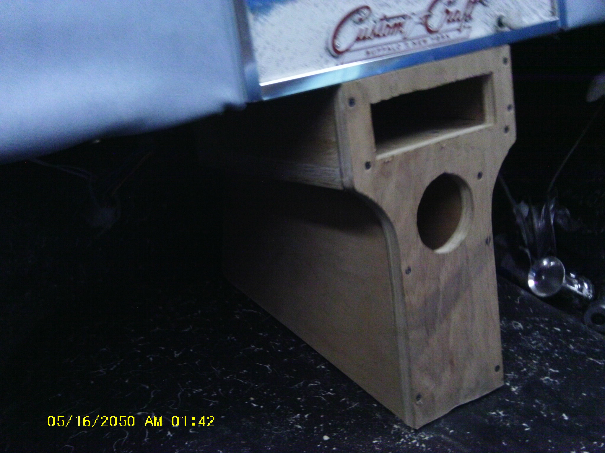

Re:ron,hows this look,new console 15 years 2 months ago #34281
  • john-gibson
  • Posts: 4014
  • Karma: 324
heres what i have so far,it took awhile to get it all to fit,i have to enclose the space where the cd player goes and put the other side on,then fiberglass the whole thing ,especially the curves,lots of cutting measureing and a ton of sanding yet to come,lol,im trying to get it to fit perfect,especially with the rounded floor,john 1st console
new console,i like it ron.

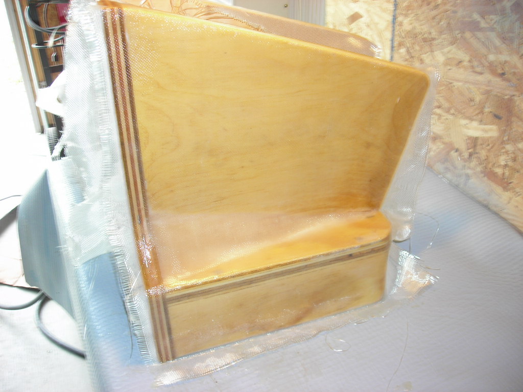

Re:building rons console,stages 15 years 2 months ago #34443
  • john-gibson
  • Posts: 4014
  • Karma: 324
here is where i am so far,1st coat of 3 coats of resin,then the cloth and resin to make the curves and make it more streamlined.john

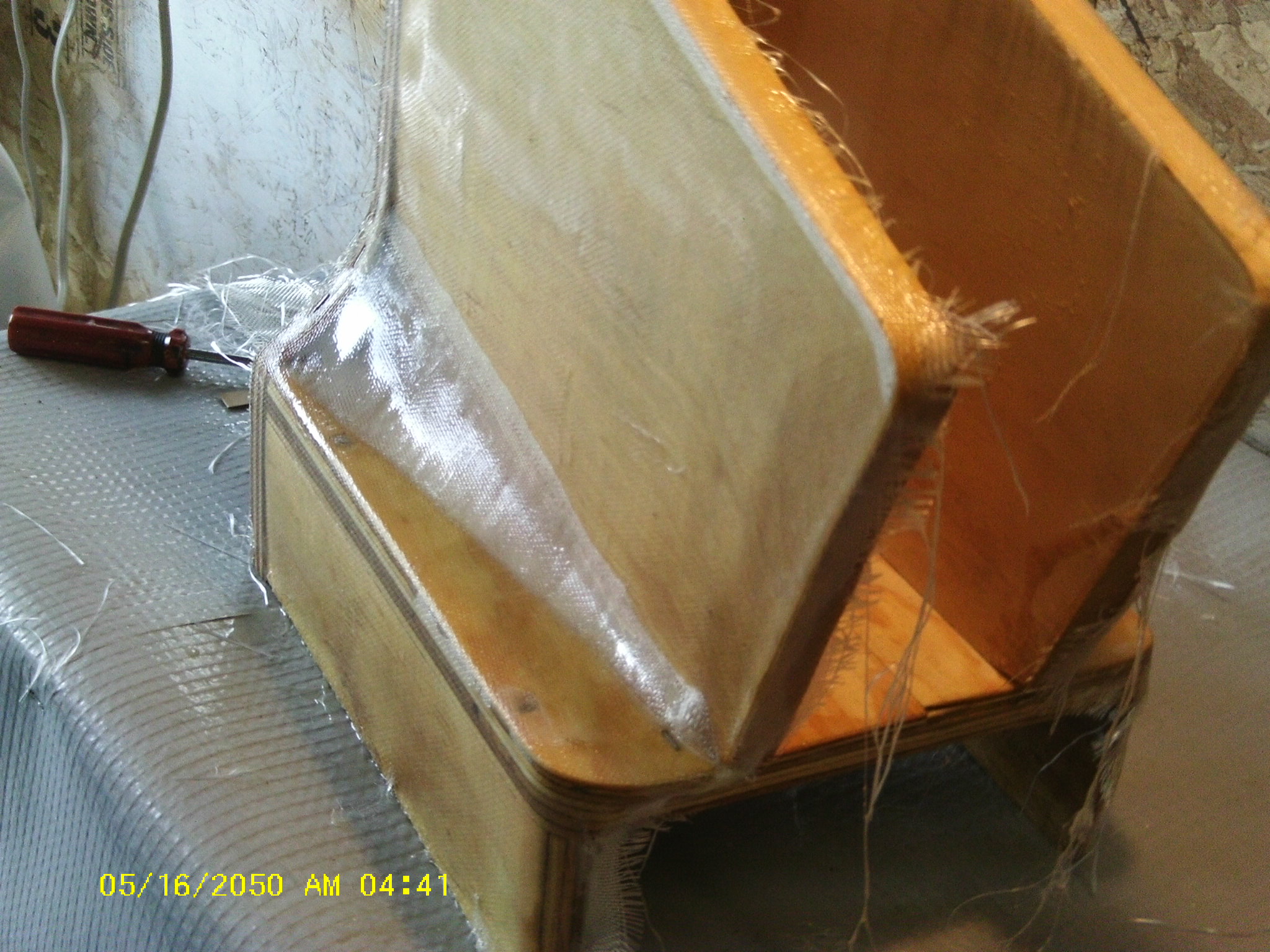

Re:building rons console,stages 15 years 2 months ago #34462
  • john-gibson
  • Posts: 4014
  • Karma: 324
thanks frank,the same goes here.
good ron im glad you like it.
58,thank you,i was a capenter most of my life and doing this kind of stuff on the side,i have found its alot harder to build something crooked then to build it straight,lol,i hope i can help you along the way,and by the way nice to meet you.
i just came in from working on the console,i just finished laying the first of 2 layers of cloth annd resin on the sides,after the second layer i will do it to the front and hopefully get it very smooth.
ron,this 1st layer of cloth is just to get it to look more streamlined,i hope ya like it buddy.,john the second layer will be much smoother

Re:building rons console,stages 15 years 2 months ago #34465
  • john-gibson
  • Posts: 4014
  • Karma: 324
neil i cut the whole thing with a jigsaw,and used a random orbit sander,a small table beltsander,and a multitool sander,i have a whole lot of sanding to come,lol.john p.s. all the strings will be cut off before the next layer.

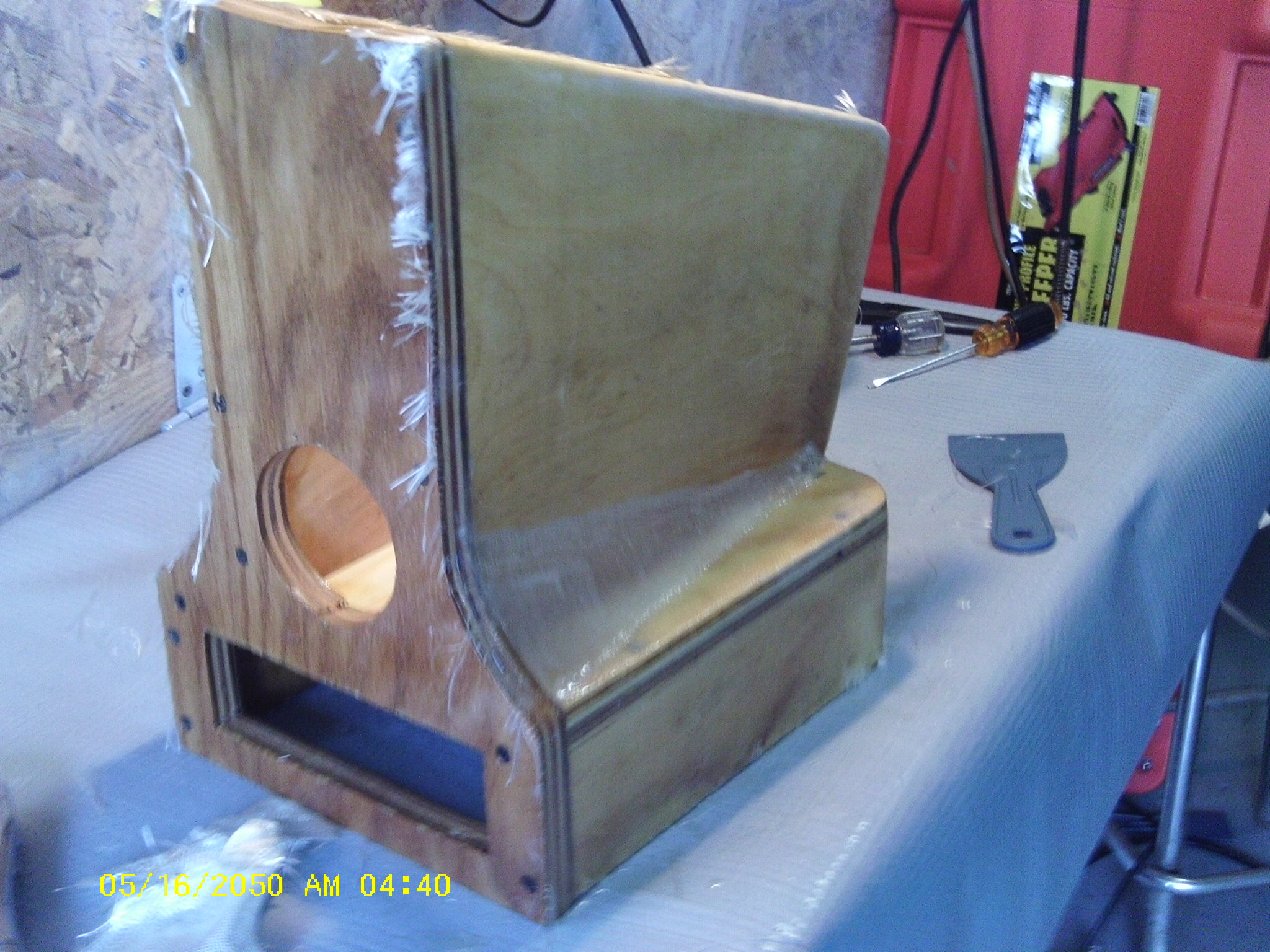

Re:building rons console,stages 15 years 2 months ago #34552
  • john-gibson
  • Posts: 4014
  • Karma: 324

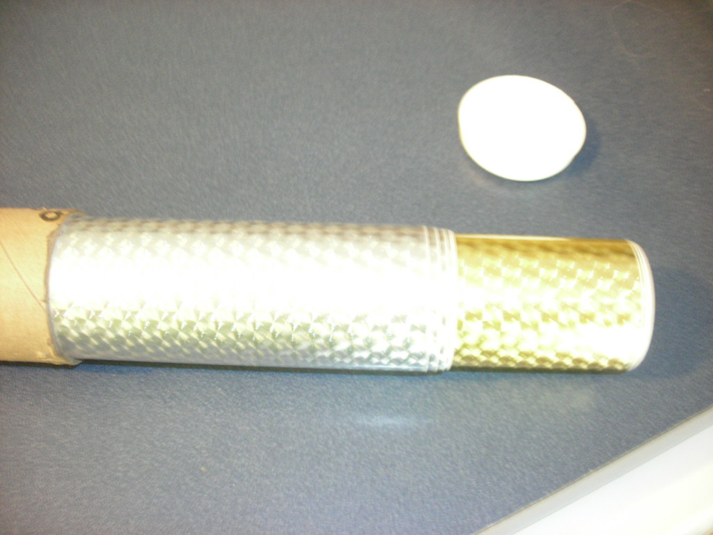

i just came in from putting another layer of cloth and resin,it doesnt look good at the moment,but i think it will after all the excess is cut off and sanded,then to resin the front to a smooth finish,im expecting a delivery today,i was going to use it on my boat dash and console it was a secret,lol,but if ron likes it i will use it on his console,pics when it gets here,john
Re:building rons console,stages 15 years 2 months ago #34559
  • john-gibson
  • Posts: 4014
  • Karma: 324
well,it got here its engine turned aluminum vinyl,its guarenteed to last outside for 2 to 5 years,so it will work great for a boat that isnt outside constantly,even if it was it should last 2 years,if you like it ron let me know,im putting it in one or two of my boats,john
Re:building rons console,stages 15 years 2 months ago #34579
gold aluminum or is catching color from somethin else.
Re:building rons console,stages 15 years 2 months ago #34627
  • john-gibson
  • Posts: 4014
  • Karma: 324
ron i have both colors,aluminum (chrome)and gold,its the way they were shipped,one inside the other,i just didnt want to take it all the way out,its in there very tight,lol,john
