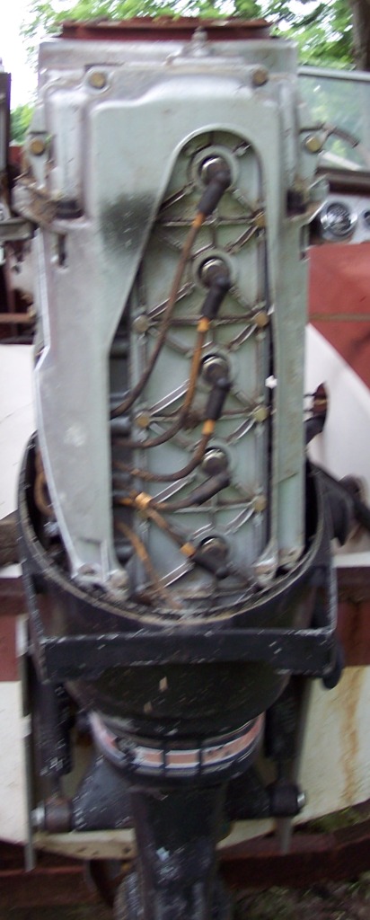

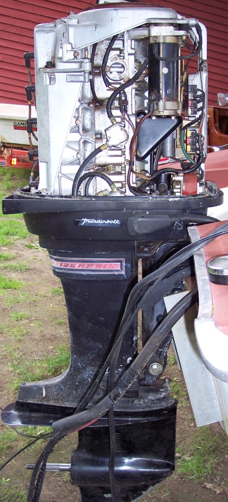

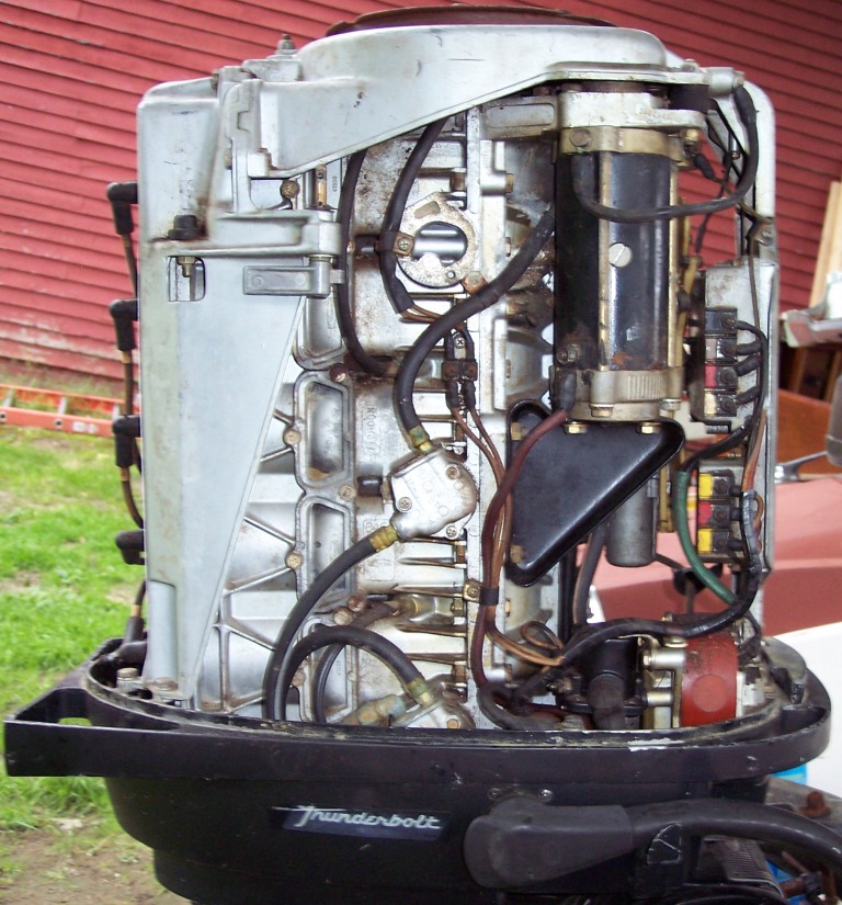

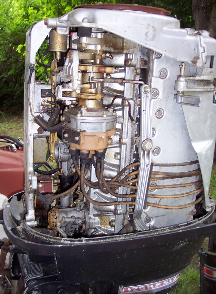

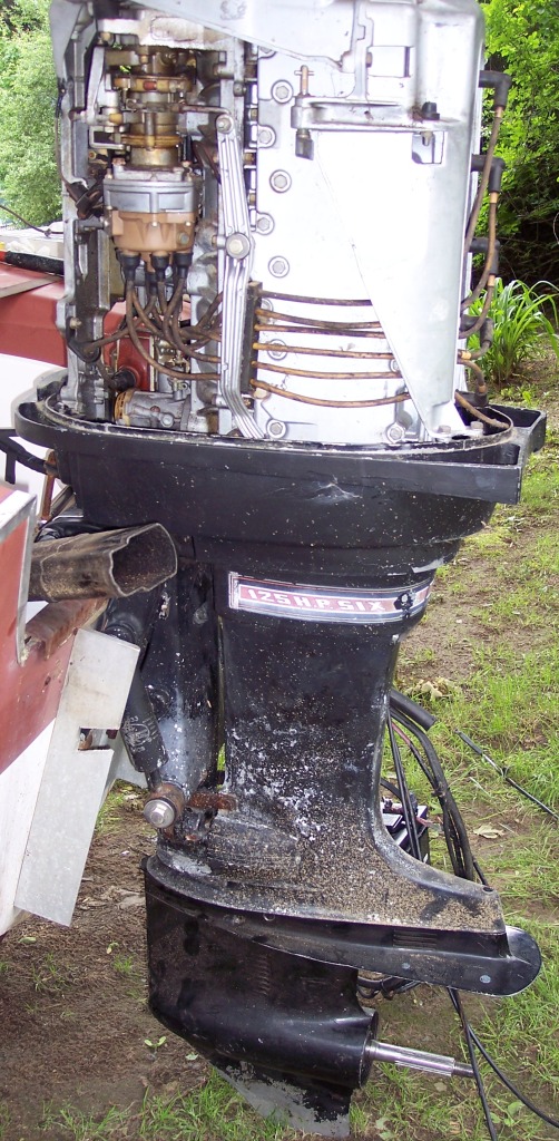

I can't get a compression reading yet because the starter has been sitting so long that the brushes are dirty and she will barely crank and her electronics appear to be in order. The wiring is not as crusty as you might think.
Pull starting the motor as I said the compression feels good so I sprayed some sea foam into her to get her cylinders oiled from sitting so long. No soft spots while pulling her over by hand.
She has great blue spark and when I sprayed a bit of starting fluid into the carbs and pulled her over by hand off she fired. A favorable find for sure. After that I sprayed straight fogging oil into her cylinders so she will sit like that for a few days until I find another starter or clean this one up. She also needs a spark plug wire on # 6 I am sure I can dig one out of a pile of em.
The weird....missing the exhaust tube that comes down from the exhaust adapter plate. They are too wide to fall out all the way so someone had to have taken the head off??? Also it was missing a water tube. When I put the lower unit from the 1100 on I inserted the water tube.

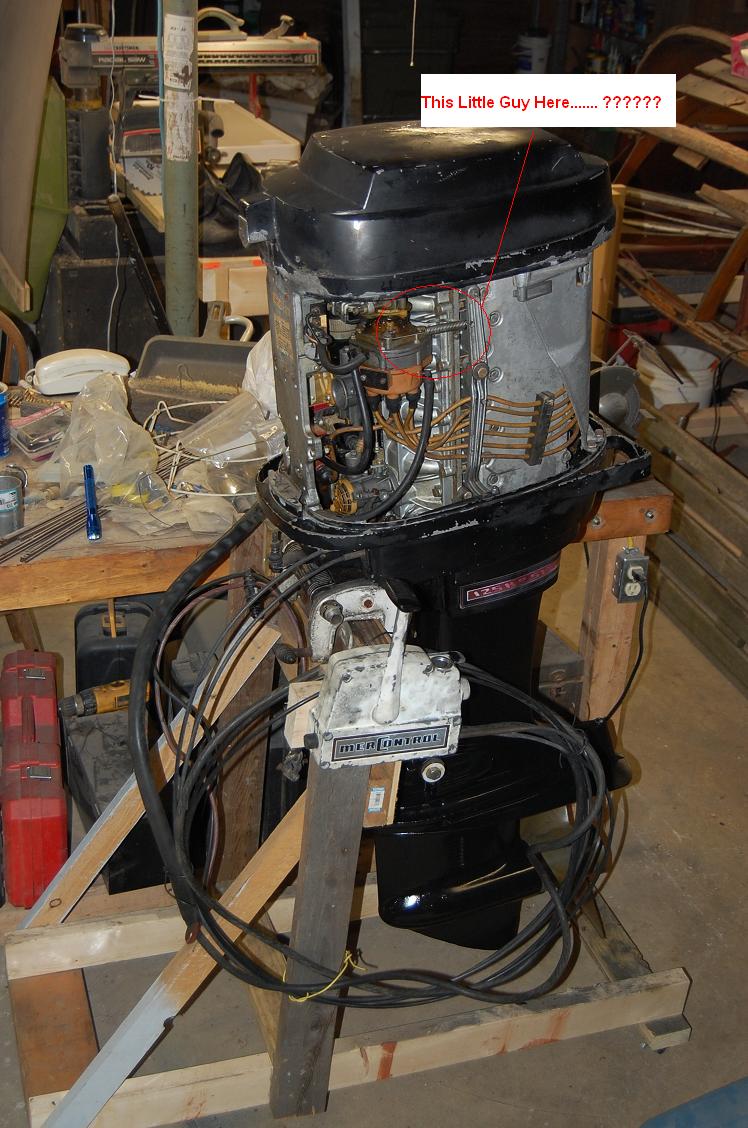

Hey Jim,
Quick Question. I see that 1250 doesnt have the spring from the throttle linkage to teh dist like my 68 has? Whats the purpose of that spring any how? and ... yeah... basically Whats it for and is it crucial? .. Cant wait to use mine!
Re:oh well.............hate it when this happens 15 years 2 months ago #34146
  • g3jim
  • g3jim's Avatar Topic Author
  • Posts: 1009
  • Karma: -27
uhhhhhhhhh i d'no let me look at the manual also why not post a pic a yers?

Um.... Best I can do here at work is this one....
That boat is just too Oddly cool for words!
Re:oh well.............hate it when this happens 15 years 2 months ago #34151
  • g3jim
  • Posts: 1009
  • Karma: -27
probably just a tension spring mine may just be missing it
