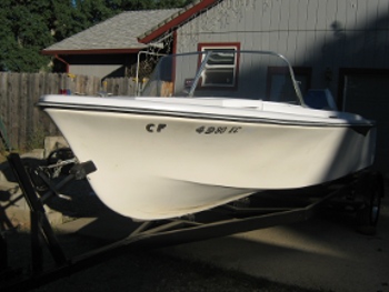

Here is a pic of the boat. I looked under the Glassic Library but there wasn't much about Nylox boats. The owner says its registered as a 68 but its a 62. Says the model is a sierra but I haven't been able to find any info on the boat.

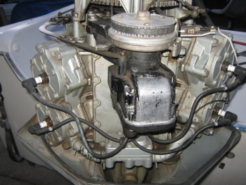

Ok so im getting this boat and I got the model off the motor and found out it is a 1960 evinrude starflite II 75hp motor. Are these motors any good? It seemed to run well.

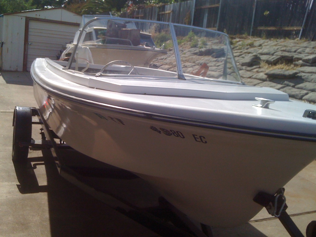

Here it is and its now home with me! Im very excited this is my first Glassic. The steering arm is back by the motor seems to be free floating which doesn't make sense. I was curious how they normally attached to the hull. The drain plug is also in a strange place as far as boats I have had. The drain plug is directly on the bottom and is under the floor. The previous owner replaced the floor and put a door to gain access but it doesn't seem right to me. Next to the drain plug there is also a water inlet, is it for a live well or?

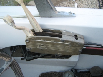

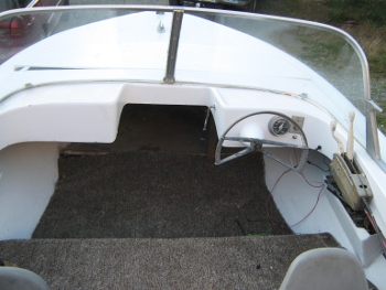

controls. The throttle cable is froze so I need to find one but the shift linkage seems perfect.
Re:1962 Nylox 16ft 15 years 2 months ago #34355
Dash

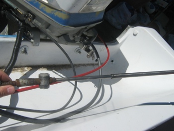

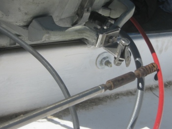

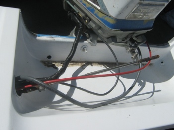

Can anyone post a picture of how the steering cable is attached to the boat by the transom? The cable is free floating right now and doesn't make sense, although I can see any mounting holes anywhere so im curious how it attaches to make a good steering set-up. Its not a cable and pulley set-up its a single cable that goes to a round cover attached to the dash behind the steering wheel.

Sounds like a rotary style push-pull (single) cable system. They mount back near the motor in several different styles; Some have a mount where the cable passes thru the motor well opening, some have a separate bracket in the splashwell, some pass thru the transom brackets on the motor. If you would post a pic, that would be helpful. ;)

Here are some pics of the steering arm and motor
Re:1962 Nylox 16ft 15 years 2 months ago #34419
Motor and arm
Re:1962 Nylox 16ft 15 years 2 months ago #34420
This is the steering cable. It comes into the splash well and is free floating.

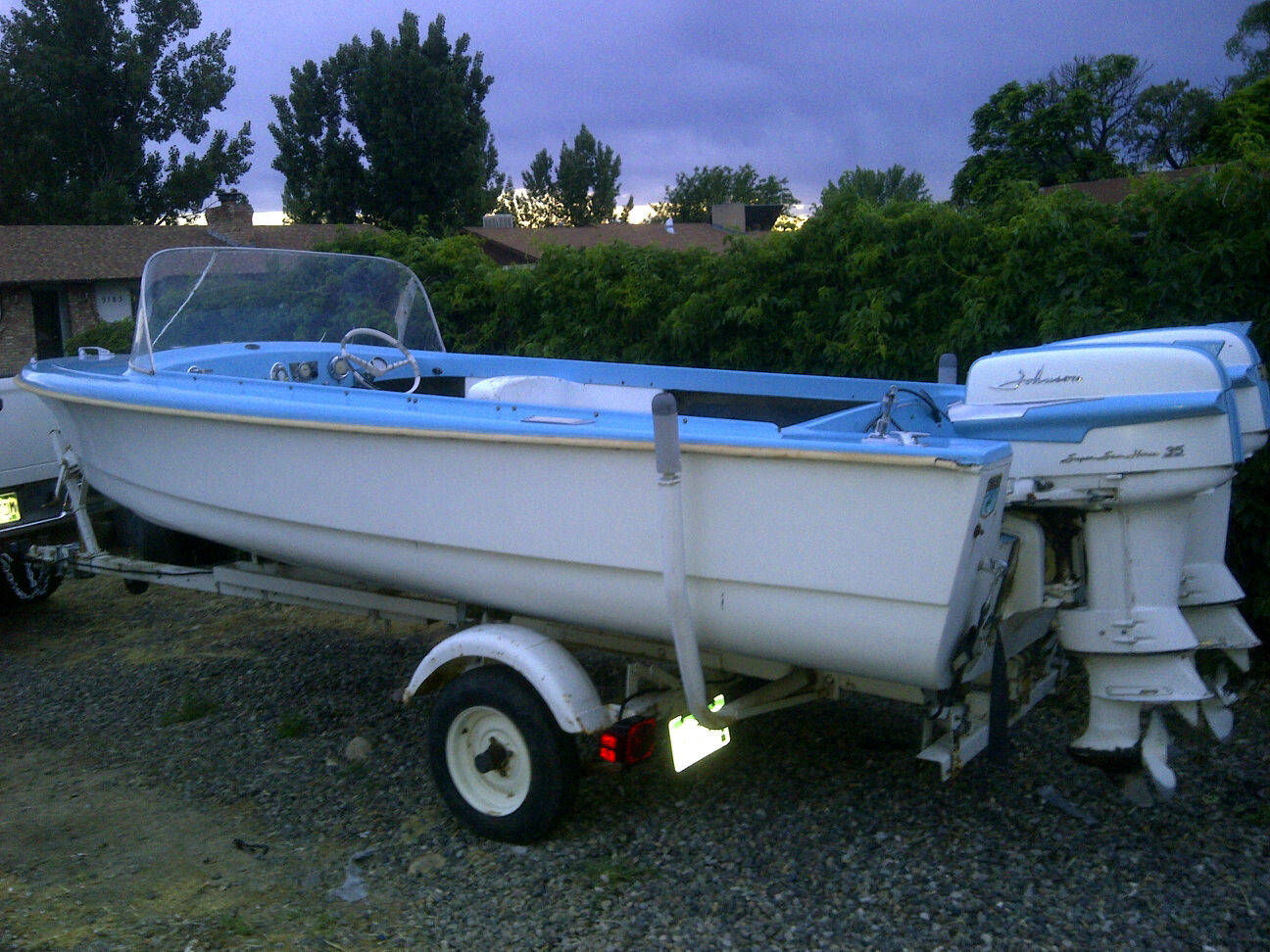

thats a great looking boat,i have a picture of our 63(i think)75 hp starflite v,its a light blue with white top/blue.
im not sure about your year,put a post in the "jego"section,it stands for (johnson evinrude gale outboards)the guys there can tell you alot about your motor.
is it pumping a good stream of water out it,"the talltales",if not replace the impeller,heck if it has been sitting around awhile you might want to replace the impeller anyhow.
is it a selectric shift?if so it takes a lighter type of lower end oil,but im no expert on these motors,check with the jego guys,and most of all have alot of fun with it,john

im probably wong here,but it looks like your missing a clamp that clamps the steering cable to the boat,and the clamp the connects the cable to the engine,i "think" that motor was originaly made for cable/pully steering.

Its not a selectric shift. It has a standard manual engagement forward neutral reverse with a dual lever set-up. The engine runs good and pumps out a large amount of water. I did find that the earmuff style water adapters don't work well but when i put the motor in a barrel it was great..
Thanks, Ill post in the JEGO area about the linkage as well.
