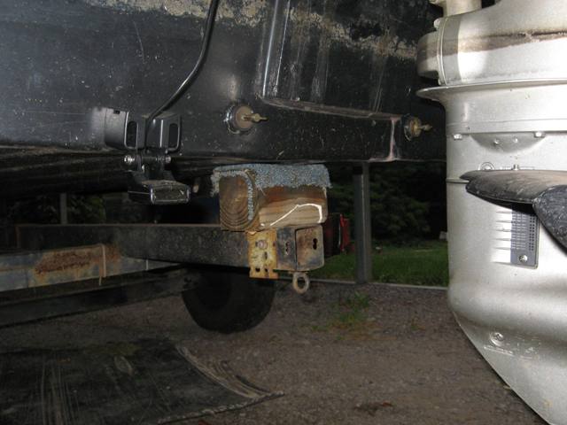

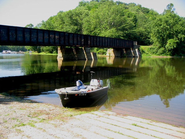

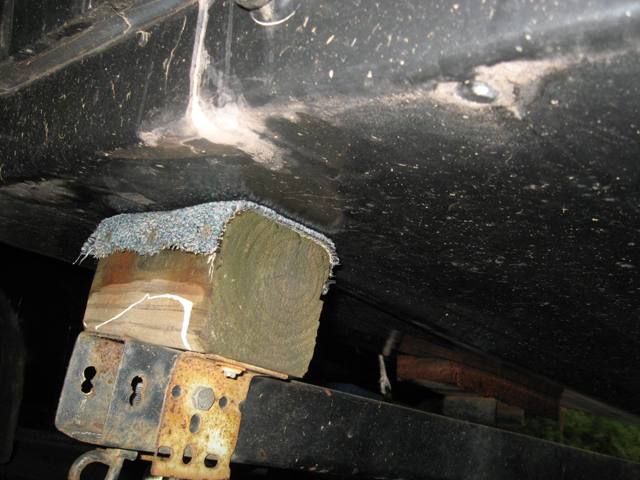

Well someone just had to go fishing before the storms came this morning. I stayed out until it was almost upon me. I hurried and got the boat on the trailer and pulled it to the top of the steep launch only to see it had backed down a good 16 inches. The winch line had broken. Many years ago when I bought this boat the wooden keel had been hogged out a bit, meaning it had an upward bow in the middle of the boat. It was caused by lack of support in the back. I had put a block covered with carpet back there to take the weight off the transom. I would put 6 inches of water in the boat during the week for a while and it both softened the wood and allowed it to go back into shape. I then left the keel dry and it was once again straight. That improved the way it rode. I left that block in because it did not effect trailering the boat. Well that is what stopped her from just rolling off the trailer.

At that time the only thing securing the boat and trailer was gravity and the winch line. It is also the enemy. I usually go to the top of the ramp before I secure the boat. I've been rethinking that. This ramp has concrete pads running across and a washboard action.
