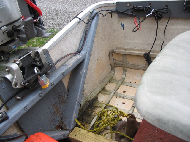

Hey folks, I have a FIBERGLASS boat question!
How do I remove the drain tube flange thingy without destroying the surrounding fiberglass? This is a thru-transom drain for the splashwell. It is not the bilge drain. The flange is all corroded and needs to be replaced. I do not want to wreck the fiberglass of the transom.
This is in my 1966 fiberglass Chris-Craft by Thompson 17'-6" Corsair Sport-V outboard.
Andreas
Outside of transom:
Inside of splashwell:

Re:how to remove drain tube 15 years 2 months ago #33645
andreas,in the pictures ,the plug itself doesnt look too bad ,(its hard to tell by pictures though)but have you tryed to buff it before you take it out,i would use a rotary tool with a buffing wheel.
but if it is too bad,and you arent able to get it out using the other methods,(good suggestions by the way),you can tap on the opposite sides of the tube ,on the inside 1st until it collapses,then repeat on the outside the same way,then pull out with pliers,it has worked for me before,john

Re:how to remove drain tube 15 years 2 months ago #33652
how do I grind it off without destroying the adjacent fiberglass surfaces?
Andreas
