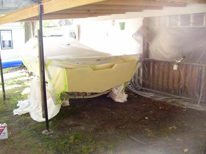

Boat back from the glass guy-

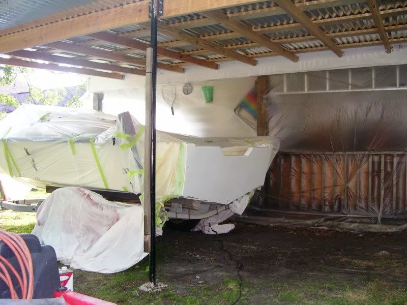

Faired and primed-
Painted-
