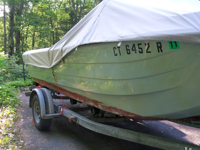

I just finished the 1st part with a Jamestown Dist. buffing kit.
It is looking better. I was expecting little, but it already looks a lot better.
Do I need to finish this very soon? (I am wiped out already.)
Will it ozidize in the next week if I don't finish it this weekend?
I may do the second buffer tonight after the sun gets over the trees.
Will I need to wax asap, or can I wait a few days?
I am not going to be around much this Sunday and when I do get home I will be tired.
How do you clean those 3M buffer pads or are they disposable?
I will use the other side for the 2nd buffer.
I also have several vertical areas that look like rust staining. Yes this buffer works, but the major flaws start to show also. They are 6-8 inches wide and evenly spaced. I doubt there is anything I can do, but suggestions are welcome.
How can one remove very old duct tape? I have some small areas that just seem permanent.
It is now 2:45 pm, a little warmer, and the Finesse-It II glaze isn't acting like this morning's Imperial Compound. It looks done and shiny, I go to wipe it with a rag, and there seems to be compound still there. It gets white and smudgy and very difficult to buff off with a rag. What am I doing wrong?

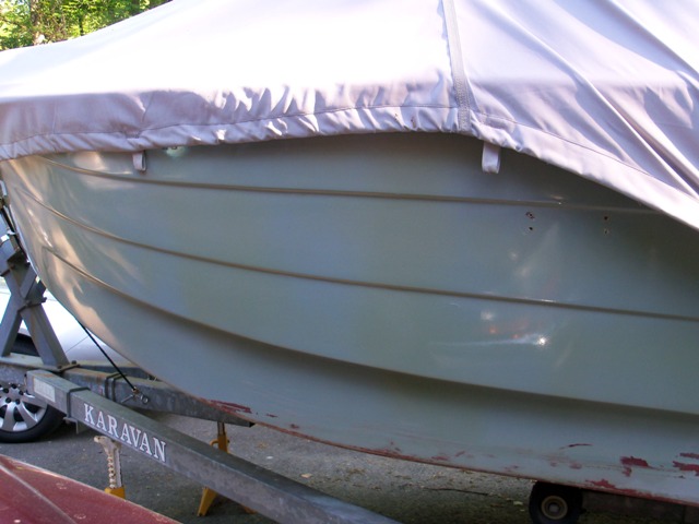

How can I clean the pad now that it is dry, or is it junk now? I didn't touch it after the two sessions. It is $50 so if it is salvageable I would like to be able to use it in the future.
It is double sided so I flipped it between buffings.
The boat does look good and shiny, but there are areas of discoloration. They were there before and no buffing is going to fix it. I just wonder what caused it?
Also all the impacts, cracks and crazing now are obvious.
It still looks way better though.
According to the previous owner, the boat was used hard for many years, then sat unused for 13 more.
The green looks better, but I actually think the green/brown is the original color. When I took the Starcraft emblems off the green/brown was under there.
All in all the buffing kit was worth it.
Jim
