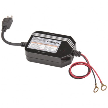

You may want to consider a trolling motor battery charger used by bass boaters to recharge their deep cycle trolling batteries. Designed for the task, many mount in the boat so you just plug them in instead of dragging the charger out after every trip. Similar to this. www.basspro.com/Bass-Pro-Shops-XPS-Intelligent-Technology-Series-OnBoard-Marine-Battery-Charger-XPS-iT-5/product/10210664/-1759705

I think I've got something like that. It's on the battery all the time, plug into the wall when you need it.

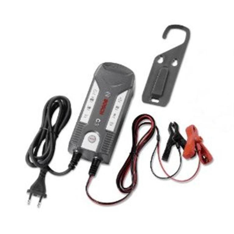

Sounds like you're set up pretty good then Z-man, happy Boating! Here's my new charger;
www.fiberglassics.com/glassic-forums/20-product-reviews/33509-bosch-qsmartq-battery-charger.html#33509
Shipster, I know there are a lot of boats set up the way you described. They will work that way, but as Mr.88 described and you have already found out, it doesn't do much for the life expectancy of the deep-cycle battery. If it were me, I'd leave the selector on the start battery, and save the "Both" setting for emergencies. Charge the deep cycle as described above, and they'll last a lot longer!
