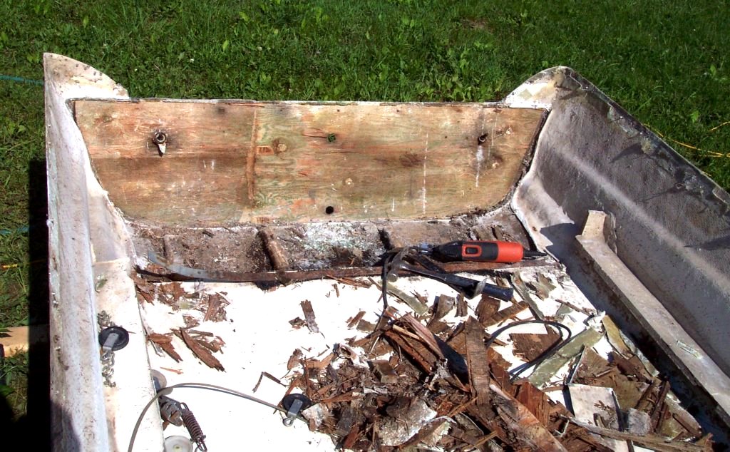

Good day, got the transom core all stripped out and it came out in about 3 big sections (albeit messy ones) but it seperated from the outer skin very easily. They had a scarf joint right in the middle of the transom (hm couldnt find a piece of ply that was 5 foot long by 16"? Reminds me of how they build mobile homes, dont waste a single scrap, but in a transom? oh well).
The floor is so rotted I can just crush it in my hand once the skin is off it. It seems my stringers are only made of solid wood about 3/4" by 1.5" looks like plain old pine. Also only the inner 2 stringers support the floor, the ply was nailed to the stringer and then covered and then the outer edge just glassed into the hull. So I'm sure I can do a better job than that.
Tommorow I will grind and sand the whole deal to where it is prepped for a new core and clean it all up with the shop vac. Now I will have to find other things to do until I can get the new ply (88 bucks for a sheet of 1/2" hydrotek/meranti) and some resin/cloth/filler and tools to do the job. Suppose I can clean up the old tape where the deck met the hull and stuff like that in the meantime. Loving that multimaster tool more everytime I find a new use for it.
Re:Advice needed please. 15 years 3 months ago #33286
$88 bucks! That is a deal. I paid $130 for a 3/4" piece.
I am glad you are doing your transom simultaneously with me. Perhaps I can avoid some mistakes by watching you. I have my transom and floor area ground and sanded clean, ready for hole filling. My biggest fear is actually cutting that precious piece of ply. Gonna do it in the next couple of days. I am going to pick up the epoxy and hardener tomorrow. Say, have you seen the automatic measuring pump system West has for their products? Big pump goes into big can, and little one in the small can. One pump of large to one pump to small and I understand you have your precise formula. No more messy guessingI am going to pick that up for sure.
