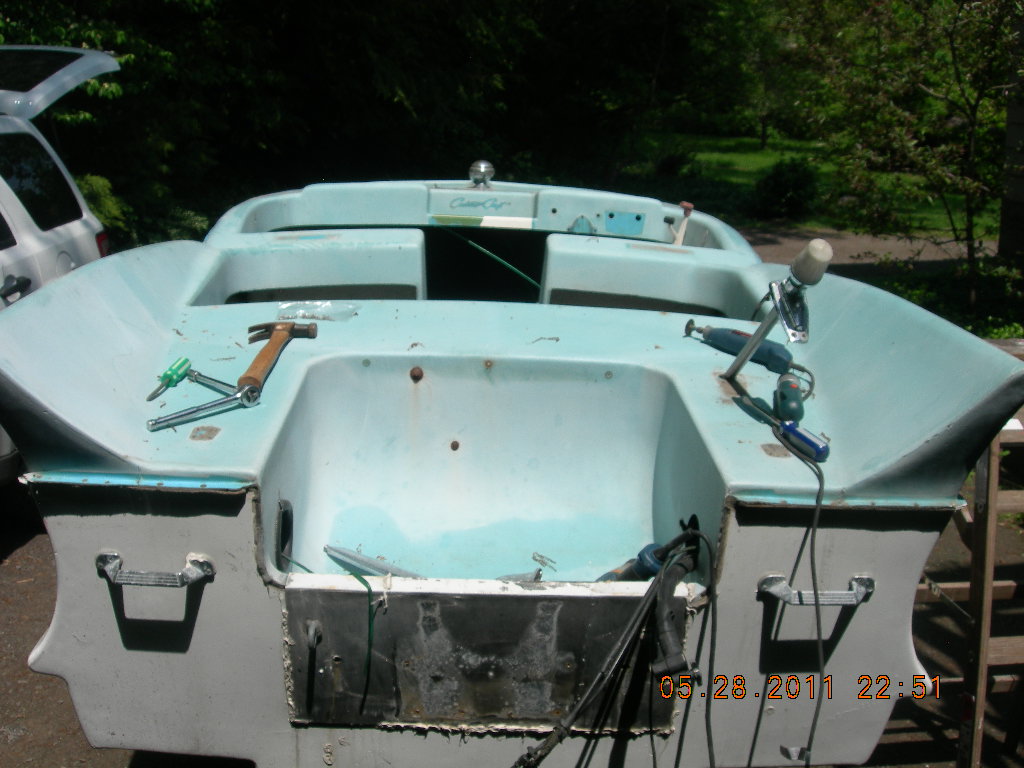

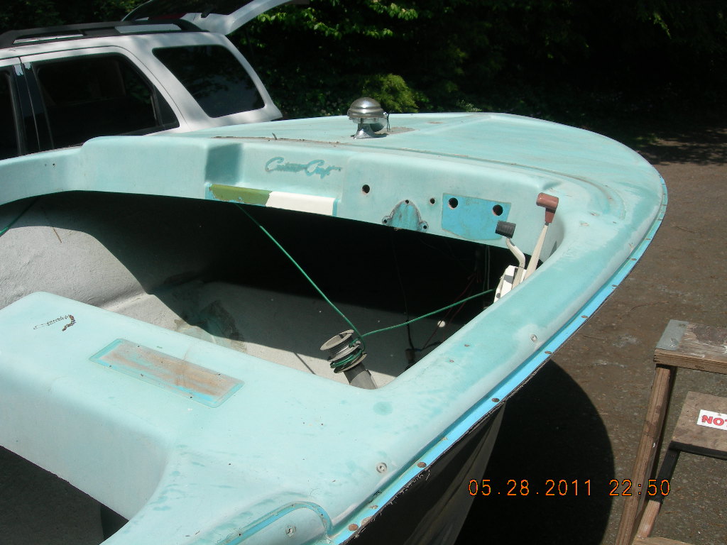

It finally stopped raining and being miserable here in upstate NY so I started on the CC Sea Ray yesterday. I am with Frank in that taking everything off is already a pain let alone bolting it all back up. I know it had to be done to do the job right but this poor little boat was loaded with so many snaps(too many riveted and needing drilling out) and tons of none stainless nuts and bolts added on that were so rusted had to be cut off etc. Many hours yesterday and I am almost to the point of starting to prep and fill holes and cracks etc.
The old rub rail had about 100 tiny little screws alone placed from underneath. Good news is these things were built right when it comes to attaching the top to the hull though.... brass rivets every 6 inches and thank goodness my transom is sound and I don't have to separate the top...that would be a pain.

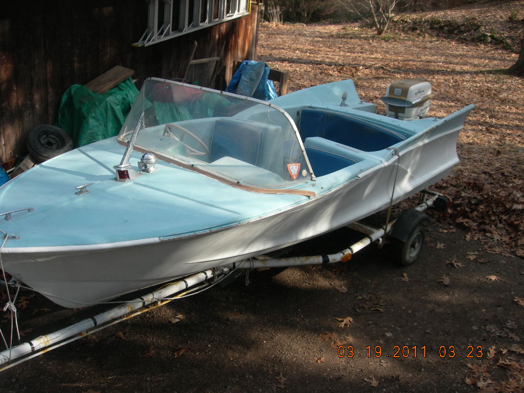

In any case here is some "before" pics to show the beginning of the progress and I'll update as I get along. It is always so frustrating being patient as you work on the prep and just want to start laying on the paint isn't it. But we all know that is key.....the two P's Preparation and Patience.
AS I Found Her:
Most of the stuff stripped off....as you can see the original blue gel coat color on the dash under the square which is for the start plate(ignition and choke) which tells me that the 58 Johnson 35 was either original or added shortly thereafter,
