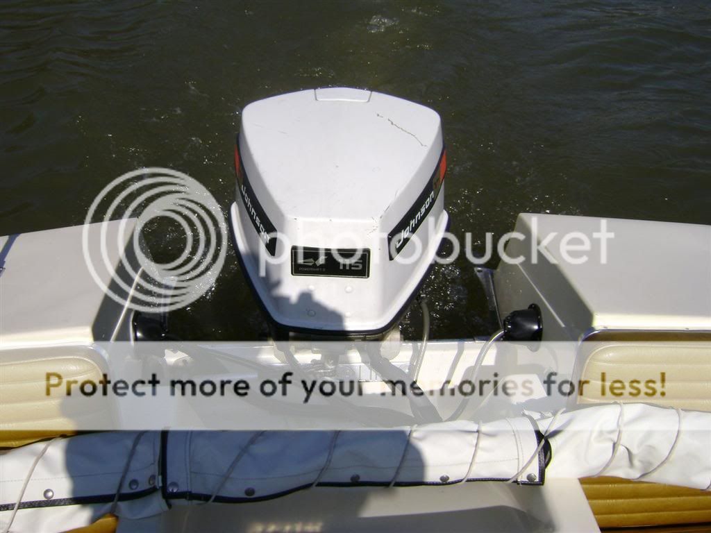

Re:Easy question about the cable boots? 15 years 2 months ago #33115
I mounted mine with the boot out Jim, I think that's the common set-up. The trim rind goes over the outside ring of the boot, to help hold it flat.

Mark,
Thanks, I would not have done it that way.
