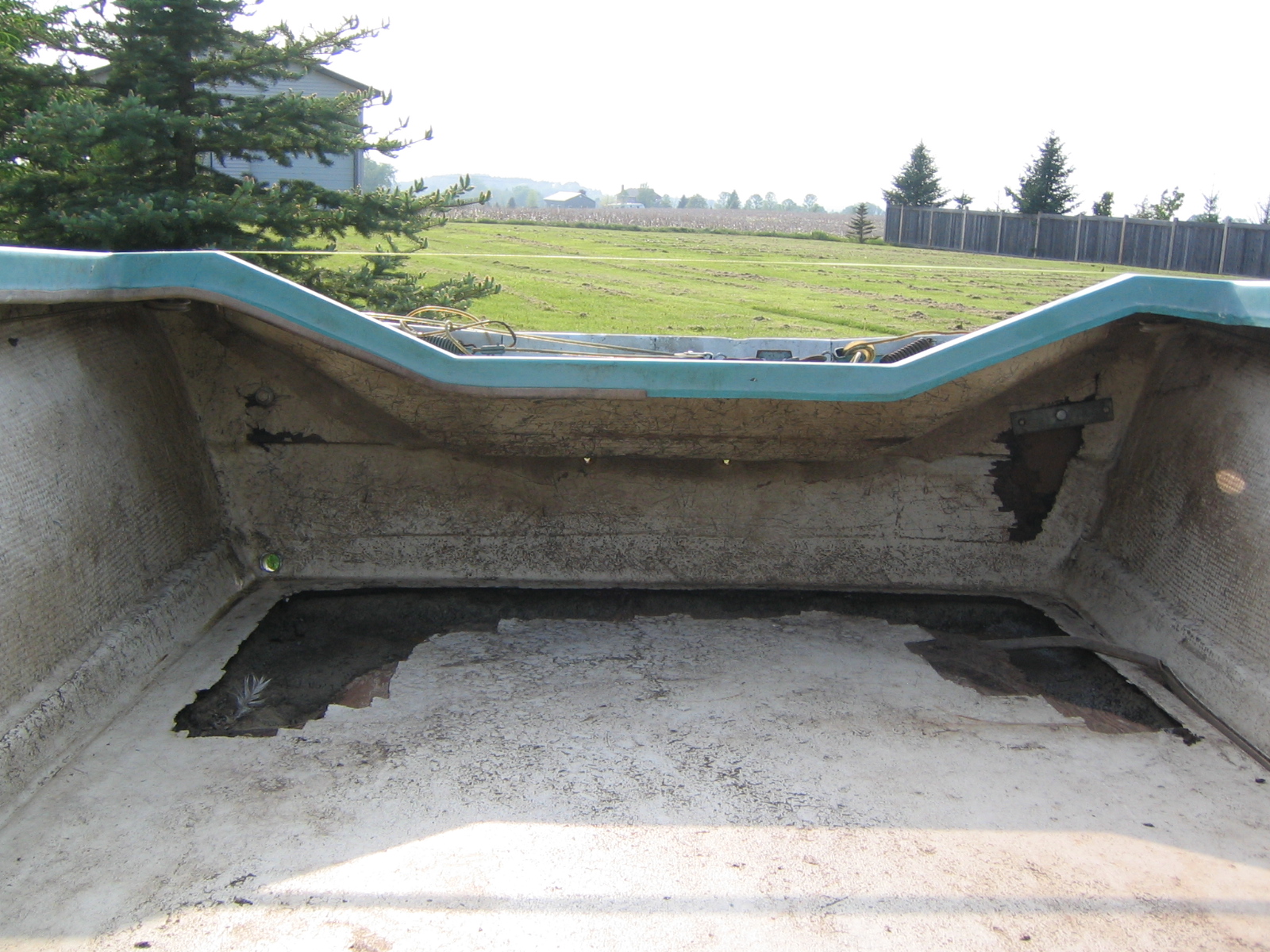

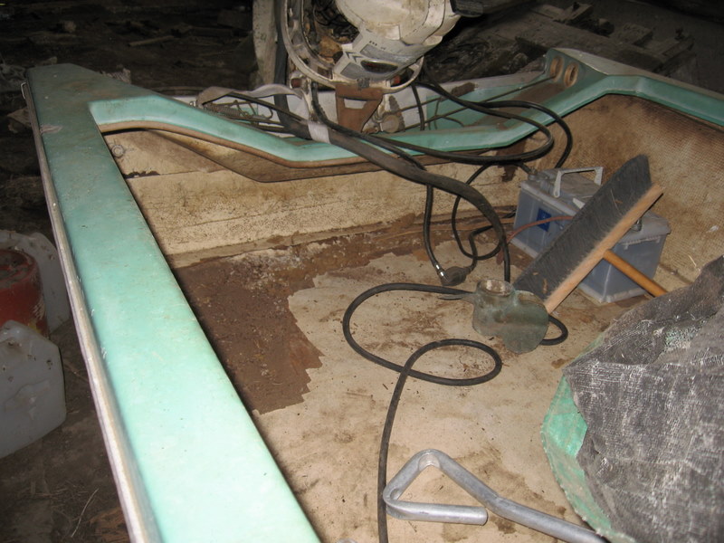

Unfortunately there is some missing floor at the back, near the transom. How big of a project is it to replace the missing section? Should I just saw it up and take it to the dump? Seems a shame since the rest of the hull is pretty good.

So I stopped by a boat repair buddy to get some advice. He wasn't too optimistic. The transom isn't as good as I hoped and it seems the top would need to be cut off to replace it. Not sure I want to get into that

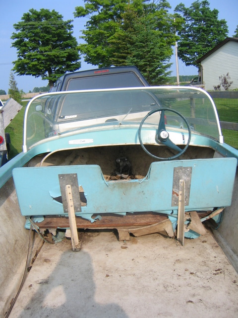

Here's another picture of the front.

you do not have to cut anything. The top pops off the hull. Undo the rub rail and remove the screws or rivets underneath it then you lift the top off the boat to get at the transom and floor.
Doing all that cutting makes the job more difficult. Cutting fairing and bonding I can see on a larger boat/vessel but on these little things the way to keep your project and life easy is to split the top from the hull.
are you sure there is foam under the plywood floor?

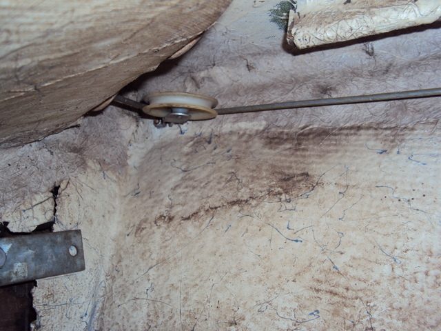

Yep, it's foam under the wood. Lone Star was one of the first to do this, check it out. Also the top half is glassed to the bottom, see photo of the rear steering cable pulley, just a fiberglass seam, no other fasteners. I could saw it apart but then it would need to be glassed back together somehow.
