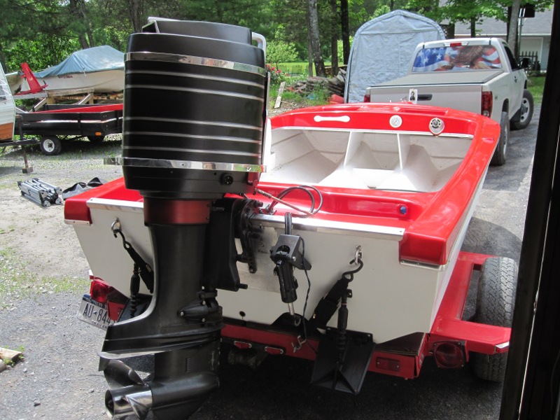

got a zillion things to do and of course, could NOT find my lift ring this morning. Nevertheless I still got the motor mounted on a freshly washed boat. Still need to fill the lower unit, hook up the trim cylinders, bolt the motor to the hull, install the controls, hook up the steering, install the steering wheel, stuff like that. then I can put the seats in. Just want to get enough done to drag it over to Silver Lake next weekend if I can.

Looks like you got the hardest part done Frank, she's looking FINE!

Now this time take your glass's off so you can't see any imperfections and the boat will look great as it always does. And please don't hurt you self.
Dam and the boat looks good as per.

You don't want to look at it very close, trust me guys. Rub your hand over it and feel all the little bumps. Whatever the reason, it's okay, but I don't like it! Guess I'll just have to go boating.
